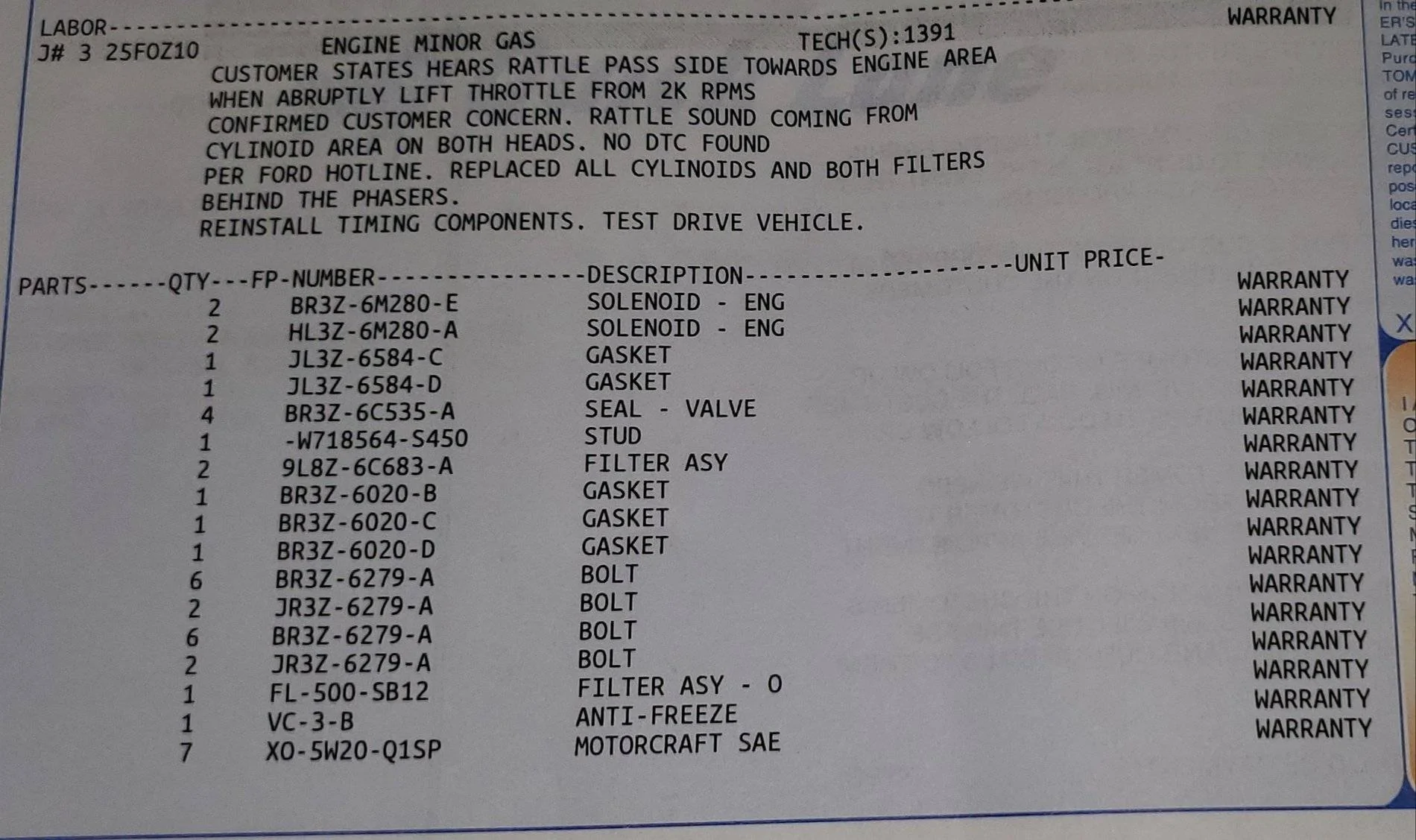

I got a call from the dealership for the 2k rattle. They're telling me its the cam phasers. So they're replacing them to see if it fixes the issue.

Got my car back today. They couldn't hear the noise that's in the video I took but they did replace a few things for me for the 2k rattle. They also noticed a small coolant leak coming from the water pump so they replaced that along with the gasket.
Edit: Not even a whole day and the 2k rattle sound is already back.

The shop did the VCT replacement, as noted here in a prior TSB I had posted a little while back:
https://www.mustang6g.com/forums/threads/ford-tsb-18-2360-2018-19-5-0-coyote-vct-solenoid.113879/
Make sure the rattle isn’t the aluminum spacer plate between the engine block and transmission. That is another source of metallic rattle that’s been outlined on this site in a few different threads. Search “spacer plate”. It’s prevalent on the S550 platform, including the GT350’s... and regardless of trans type. Get the car safely and securely lifted - have someone give it a few revs while you are under it where the trans meets the block... the thin plate in between, hold it or press it against block or trans while neutral revving and see if the rattle subsides. If it does, you can place Dynamat (or similar material) wedged in between spacer plate and block to permanently stop that rattle.
