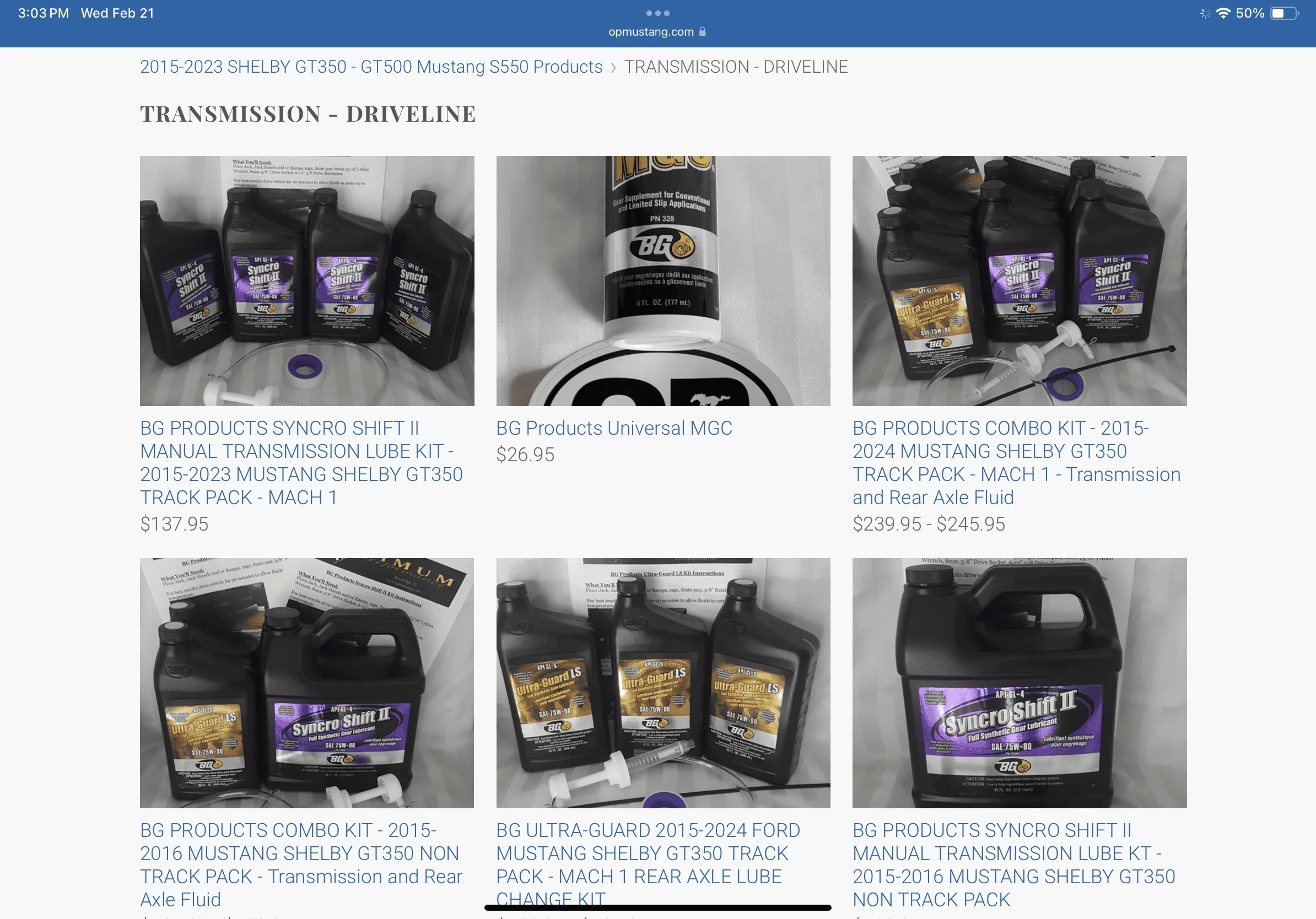

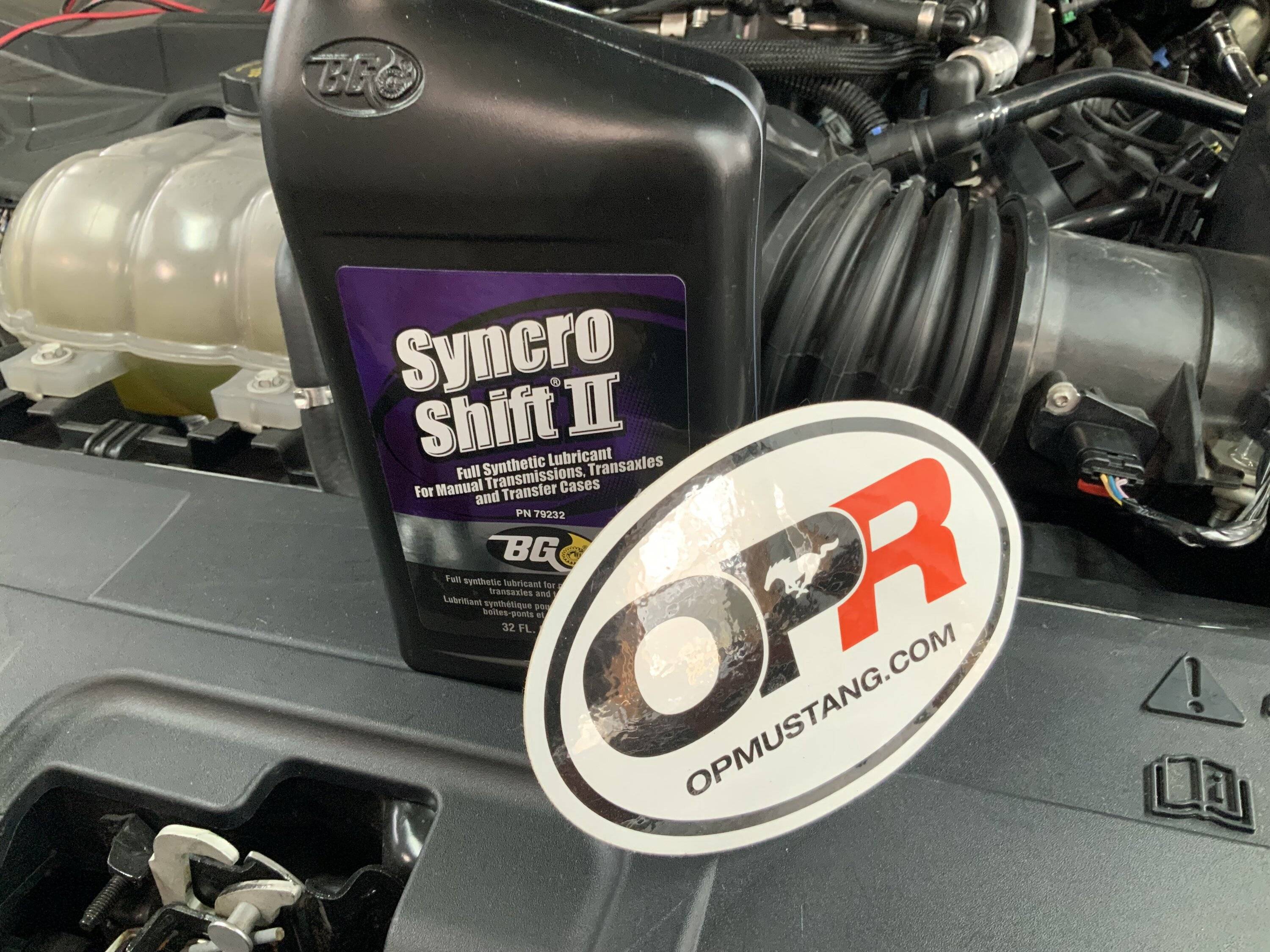

Whats the opinion on using BG Syncro Shift II ?
Good stuff! I've been running it for nearly 8,000 miles now and about to do another oil change. Lots of track miles too. The trans and diff change kit from OP Mustang is pretty handy and works well.
The trans shifts smoother and is been a good change. Now the Tremec is a bit of a "clunky" trans and when cold you need to be slow and deliberate. I think it's perfectly fine, but it's certainly not as nice and smooth as BMW, Porsche or a good S2000 trans, but it's durable, the synchros are reliable and I've found it to be trouble free.
PS-I have MGW shifter too, which is great. Takes a few thousand shifts to become nice and low resistance (new it's a stiff beast).

Thanks, used it years ago in an MT-82 and was very happy, wasn’t sure how well it worked in the Tremec. Based on your comment about the kit I’m assuming you also changed the diff fluid ? If so did you use the one with or without friction modifier ? I’m aware of all the why & why nots for the torsen & non torsen, just curious what you chose

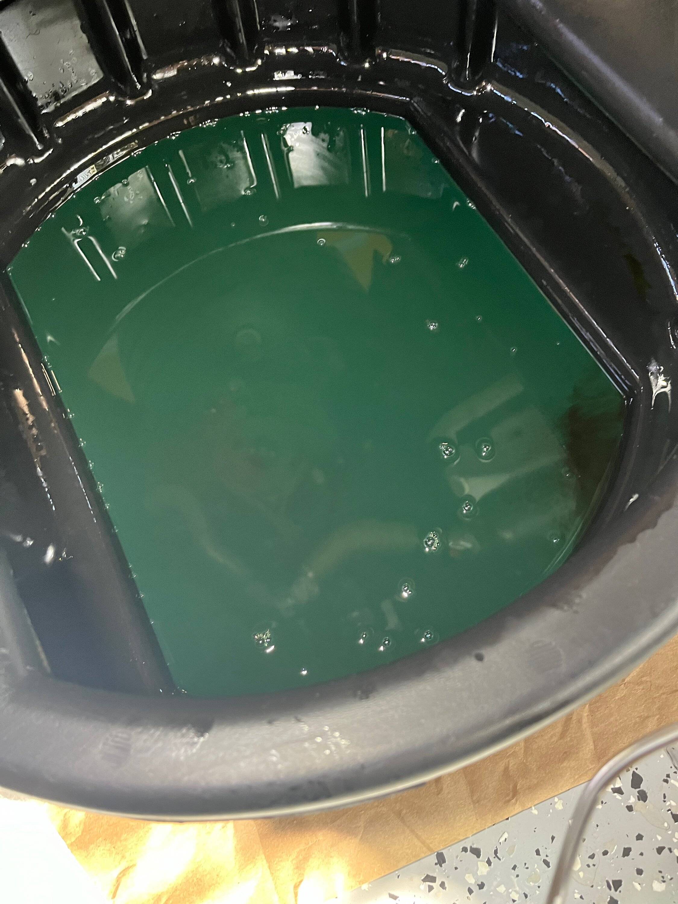

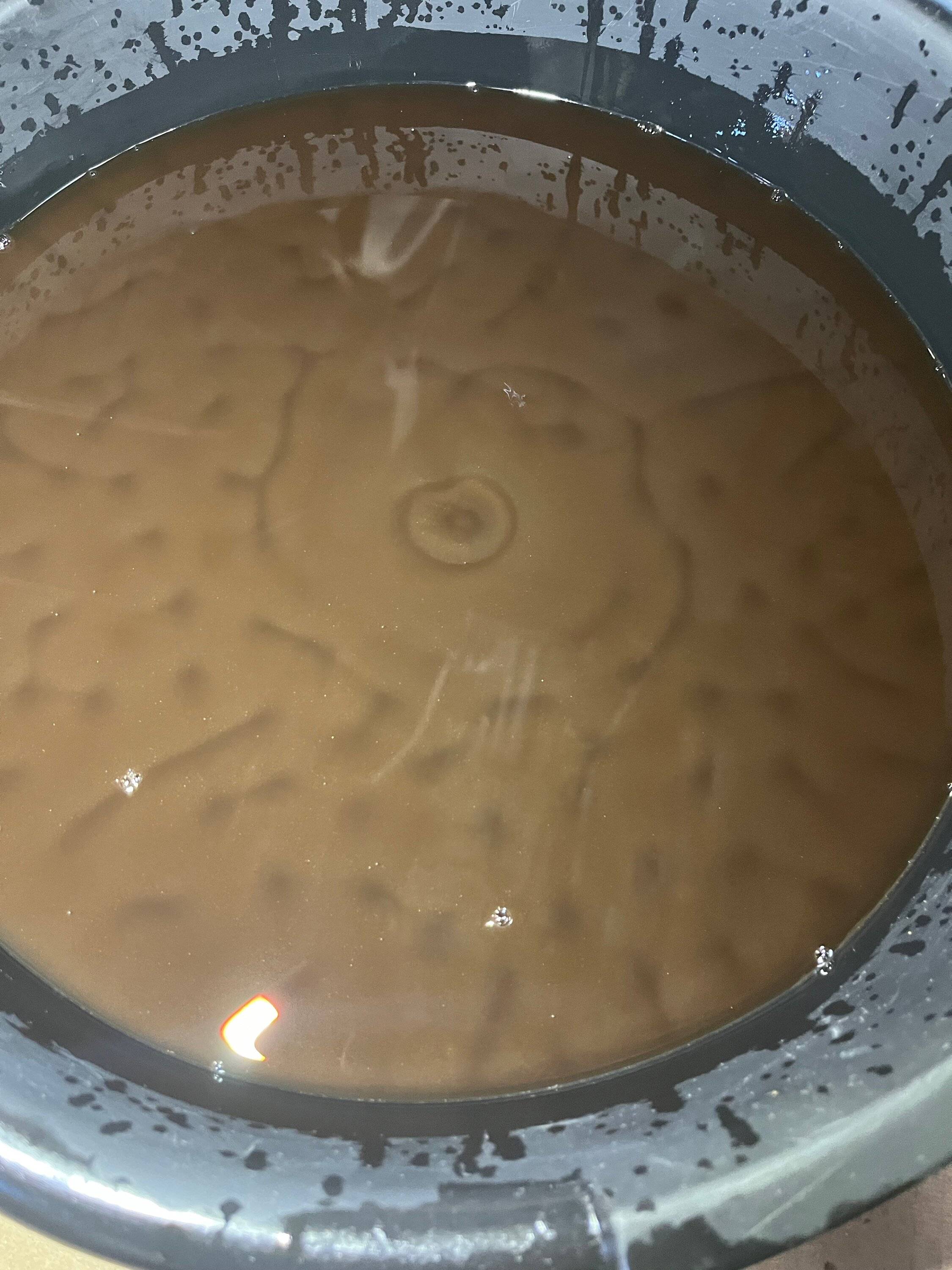

Just changed the trans and diff fluid this afternoon. I think the service interval could be longer for both. The exact mileage was 7,430 miles. The green oil is the diff which looks brand new really, the brown oil is the trans oil. When it was flowing looked better than in the pan. Without an oil analysis I guess it's hard to say, but I've changed some nasty trans and diff oil in the past and this is nothing like it. Looked good, for whatever that's worth.
