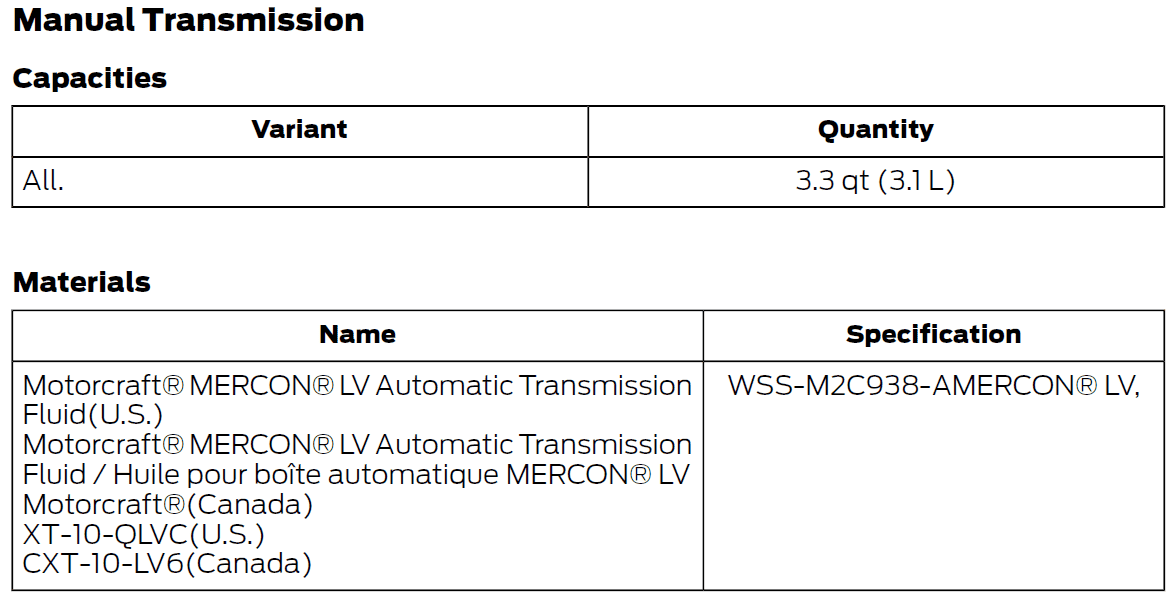

From the 2021 Mustang Mach 1 Supplement
Thanks, any idea if that is what it comes with from the factory?
