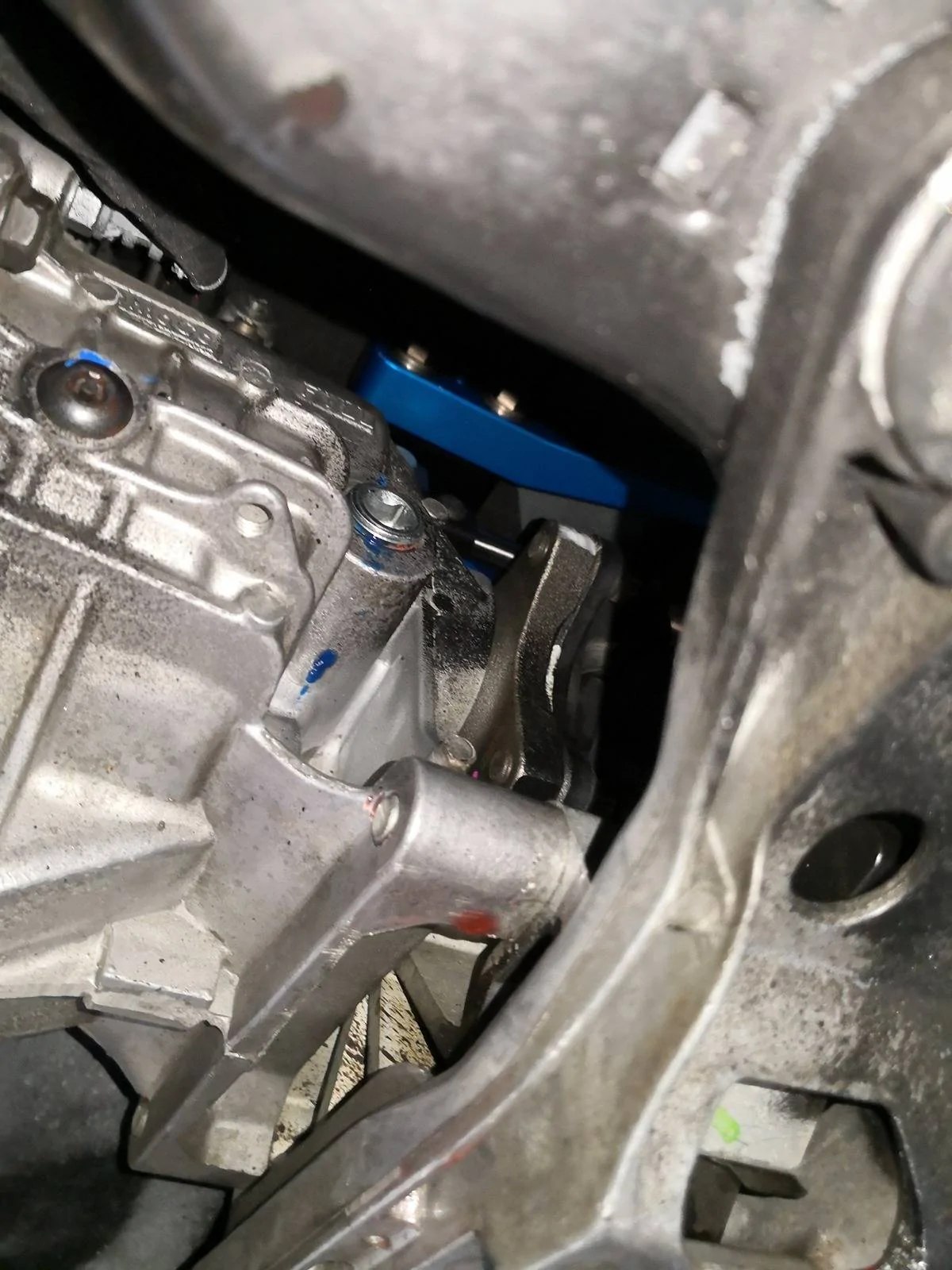

Just to recap here my recent observations.
I found a doc on this forum, which describes the draining and filling procedure for Tremec 3160 (though I did not find the post - it popped out on google), which I attach to this post.
Running the transmission to fill the cooler after the draining makes sense, if the cooler can be drained (apparently it can).
Running it before the check would make sense if the fluid from the cooler can somehow "fall back" into the transmission if the trans was not run for some time.
This would be something that people who opened the filler plug without running the transmission first should observe as the fluid spilling from the fill plug. I cannot verify that since I have a 30 min drive to the place where I can lift the car, so I never work on a cold car.
I did the second inspection during the last weekend, by running the transmission first (on idle) for 2 minutes and then opening the filler plug. Apparently I filled it ok the last time as I observed a small overspill from the hole.
I tried to "overfill" it, and then waited for the spilling to stop, only to measure that what I put there, I caught into the pan after. So this part turned out ok.
The other tricky point was how to torque the filler plug. The thread used there is apparently not the regular thread, but a tapered one (not sure about the English nomenclature) and that more you screw it in, more tight it become but also more "adapted" it become.
It looks like if you overtighten it, you may need to screw it in more the next time to get it to the same torque.
On the other hand, it also looked (felt) like once it "bites" it requires distinctively higher torque to continue, or to unscrew it. Especially unscrewing the plug felt like needing much higher torque than I gave it two weeks ago when I screw it in.
The thing is further fuzzed by the fact that chances are you are tightening it into a thread washed with the oil, and Ford is not explicit about it in the spec. So you may (or may not) depending on the interpretation, further reduce the recommended torque.
The Ford spec (attached) mentioned 21 ft-lb (28 Nm). I did some tests with wrench which goes up to 25 Nm. Going for it from the get go I felt uncomfortable about how deep I screw it without even reaching the torque. So I unscrew it a bit and then set the wrench for 22 Nm, testing how far that torque would get me. Then after reaching 22 Nm and only readjusting the wrench for 25 Nm. I realized I could not move the plug more even with the higher torque set.
Since I did not find the recommended sealant TA-24-B (WSK-M2G350-A2) I put some blue loctite on the plug just to be safe. Even with "undertorqueing" I ended up with about half the thread visible compared to the drain plug, which is still in factory position with the original red sealant on it.
