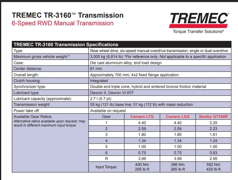

Good question, and something I missed. Yes, I specifically asked about the 3160. Thanks @murick
Until a few years ago, before Tremec released their own transmission oil, they recommended ATF for most of their product line. ATF's are not the best for manuals with gears due to the metal to metal contact.

Redline D4 is another good option. I've been running this for about 8,000 miles. Silky smooth engagement, cold or hot. Interesting that TREMEC calls for either Dexron II or Dexron VI, which have fairly different viscosities.

I read the same. FWIW, Redline D4 is a replacement for Dexron III (or II) and D6 is the replacement for Dexron VI or Mercon LV. I'm trying out D4.

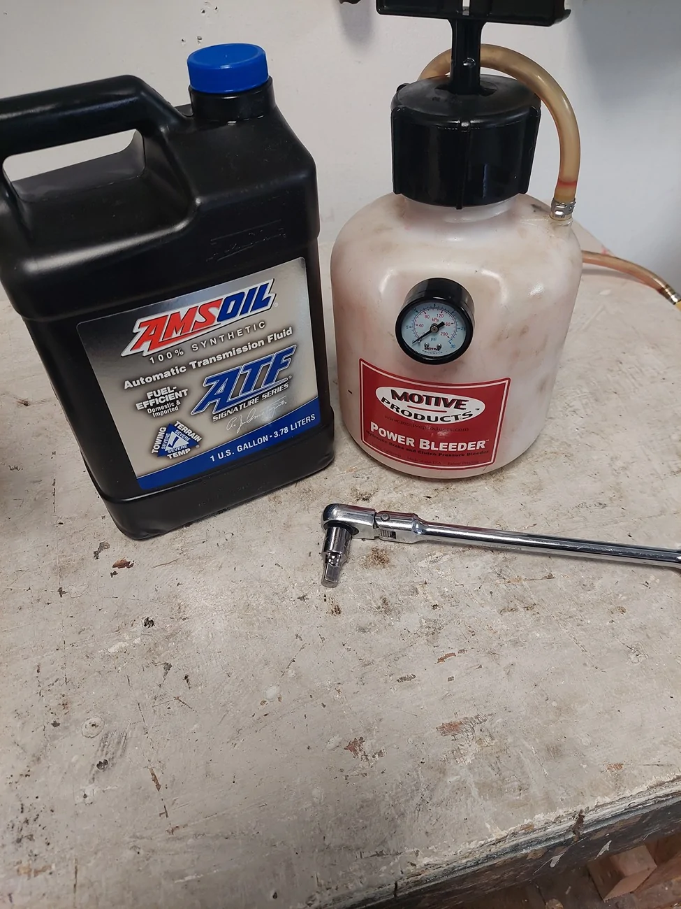

I can recommend Amsoil ATF Signature Series Multi-Vehicle, which I’ve been using since the first change.

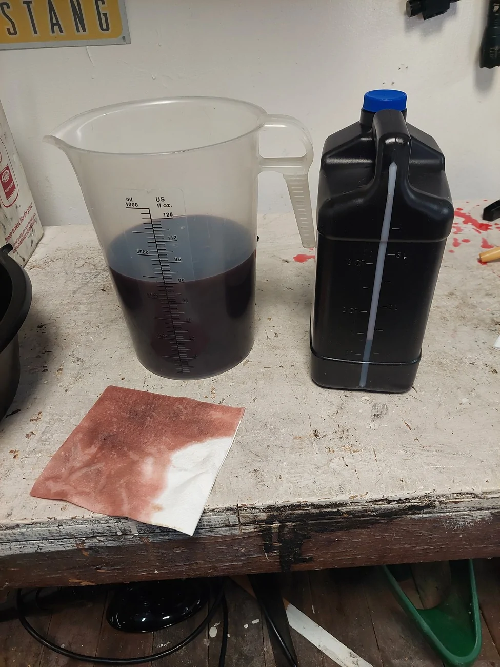

Fluid showed up in a day ups ground so went ahead and changed this morning before work. Only drained 2.5 quarts, suspect have to do it again to get all the old stuff out ? I changed it cold with the car level. There was metal in the oil, could see a silver tint. Glad i went ahead and changed. Also i recomend getting a 1.5 inch extension for the fill plug.

I just swapped out the factory fluid with BG Syncro Shift II today. I drained a bit over 3 quarts hot and level and filled the same amount. Then it started raining so no results to report.

After driving the car last night I was very happy with the results after the fluid change to amsoil. Will have to wait and see how it does when it gets cold out.
I plan to change it a second time just to clear out most of what was left in the oil cooler. No idea how long I should wait. Does anyone know if the pump circulates the oil in the cooler all the time ?
