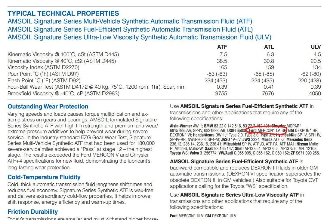

Specifically what Amsoil are you all running? I'm about to change mine at 10k miles after autocross and a track weekend. I see the DCTF fluids referenced a lot as well.

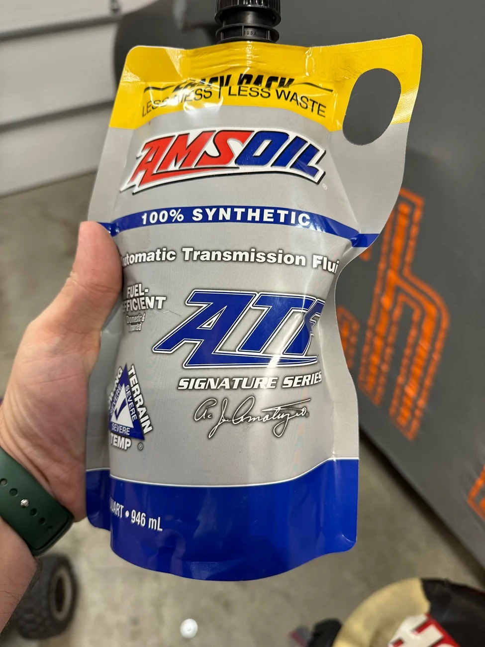

Went ahead and ordered a gallon. $88.70 delivered.

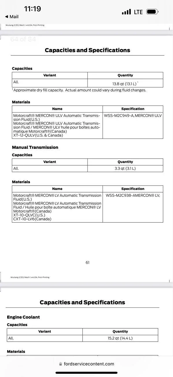

Thanks guys, I knew LV was the factory spec, but some have switched to the older/heavier viscosity spec. Dexron III versus VI for GM guys or Redline D4 versus D6 or Mercon V versus LV.
