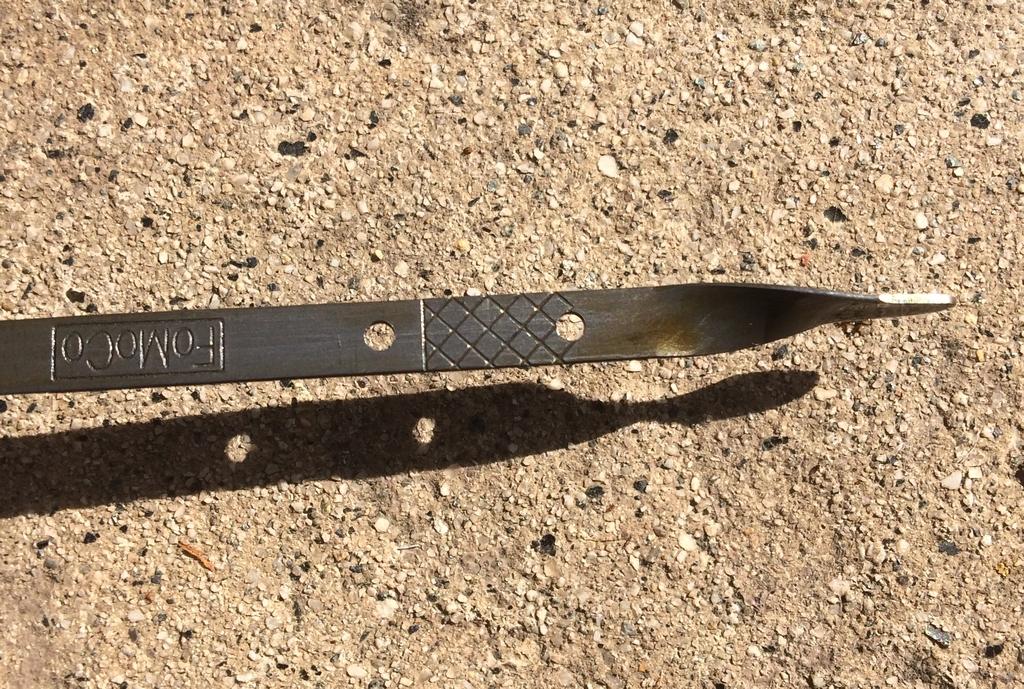

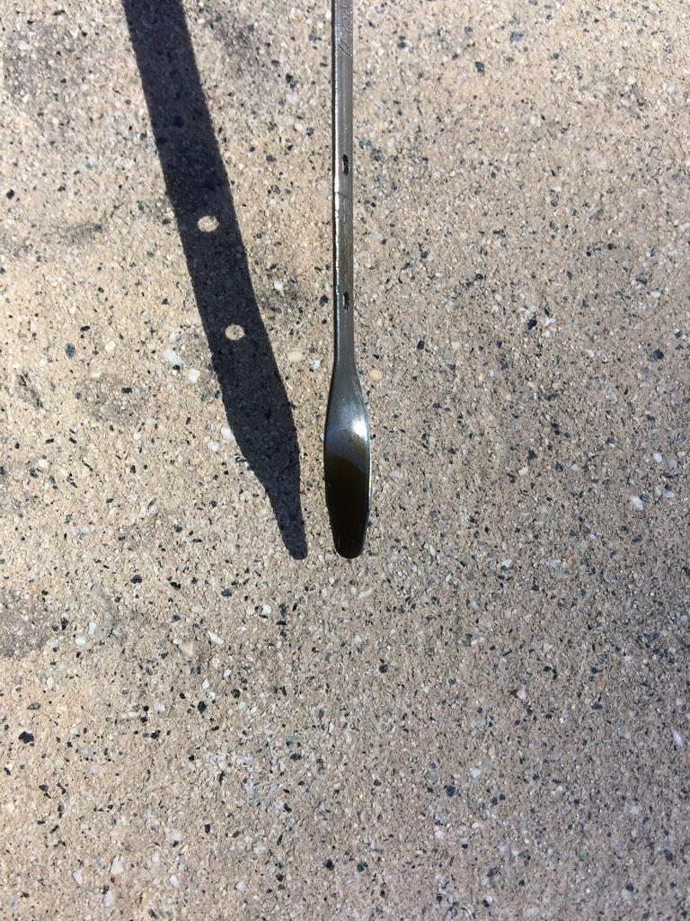

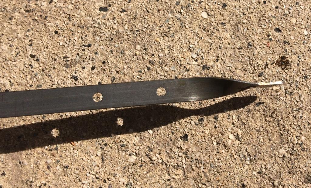

Checked the oil a few weeks ago @ 25,000 miles (shortly after the track day).
Was about a quart low and had a decent amount in the catch can from the track day and before.
Added a quart which brought it up just past the bottom hash.

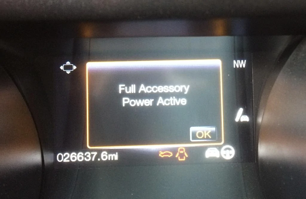

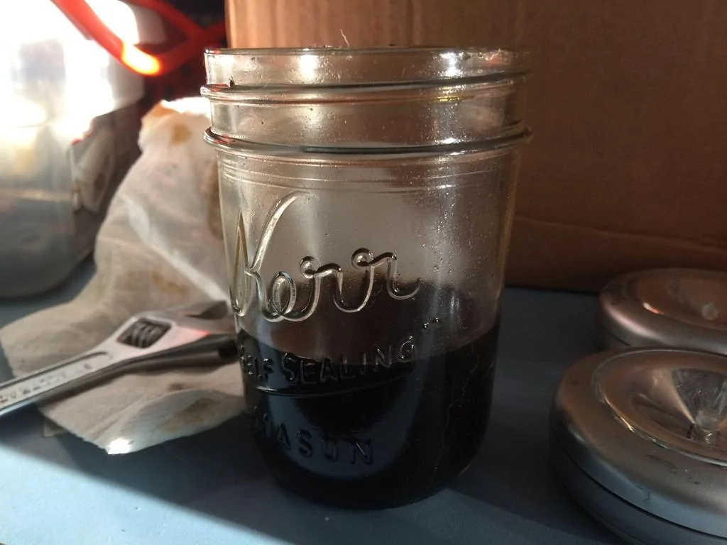

Now @ 26,600 miles, and added another quart. Engine oil life indicator is at 36%, and I believe I've added 4 quarts since the last oil change and it has been about 5000 miles.
Also emptied the catch can. Not too much this time around, but I did drop the UPR threaded knob as I unscrewed it and it got stuck down near the bottom of the radiator. Managed to reach down with a trash grabbing stick that we have in the garage for some unknown reason. I think I will drill out the first few threads on the knob so it can remain seated on the threaded post even after it has been fully unscrewed.

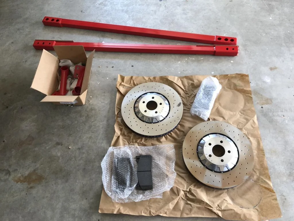

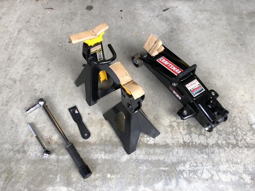

Got some goodies in preparation for the track day on April 16th. Ordered everything through Lethal Performance. They have great customer service, so if you ever need to order something, they are a good place to go.
Was able to get the jacking rails installed last Sunday, so next up is the new front rotors and brake pads. Holy cow those rotors are huge!
My original rotors are still in great shape from a wear perspective, but have uneven pad deposits and therefore generate lots of shuddering when braking. I think the issue occurred during my Thunderhill track day, because they used two flag stations (with the second one at the sharp left before the back straight), which meant minimal cooldown if you happened to catch the second station (which I would do almost every session). I would typically drive around the paddock to cool things, but I must have forgotten once and parked while the brakes were still very hot. When I get the old rotors off I'll take some photos, but there are small outlines of the pads on there, so I'm pretty sure that's what caused the issue.
I ran with them as-is during my last track day @ Buttonwillow, and the braking was pretty annoying. It got a little better as things heated up and the brakes started to really get burnished, but the problem is still there. I've tried additional burnishing to no avail, so I figured I'd just get new rotors since I needed to swap pads anyway. Hope to get to that task next weekend.

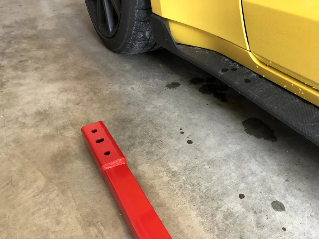

Regarding the install of the jacking rails, I found that the passenger rail has only two holes on the front end. When resting on the ground, the angle of the center section should be higher towards the outside of the car. You probably can't really install them backwards, but getting the orientation correct before you are lying on your back under the car makes things a bit easier IMO.
Anyhow, they were pretty easy to install. The hardest part was using a crappy plastic paint scraper to remove the excess seam sealant. Took me probably an hour of actual install time, with a detour to the hardware store for a 15mm socket, and another detour to my daughter's softball practice.
It will be nice to have a larger area to use for lifting the car when I go to install the new brakes and when I eventually get around to the cradle lockout kit. I think I will need a new jack and two more jack stands when it comes time for that install. Not sure I will get to it before the track day, but we'll see!

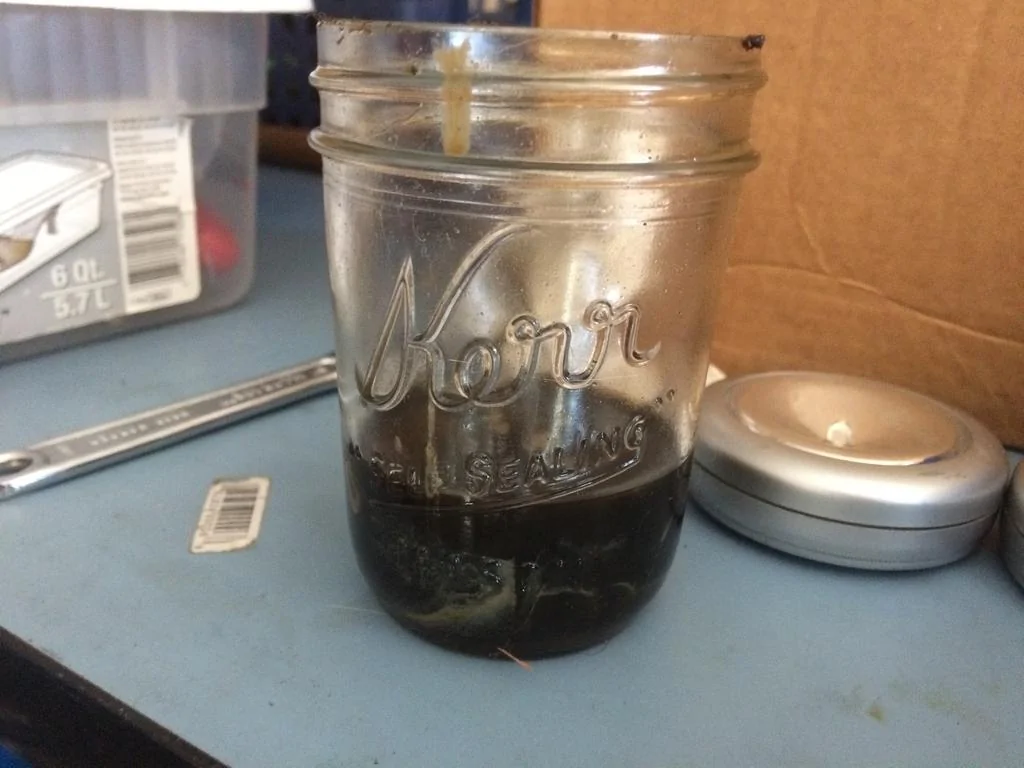

Also cleaned out the catch can and added TWO QUARTS of oil. Have 28,700 miles now, so it's been 2100 since the last check. Will check again at the track to see what the level is like prior to going out.
