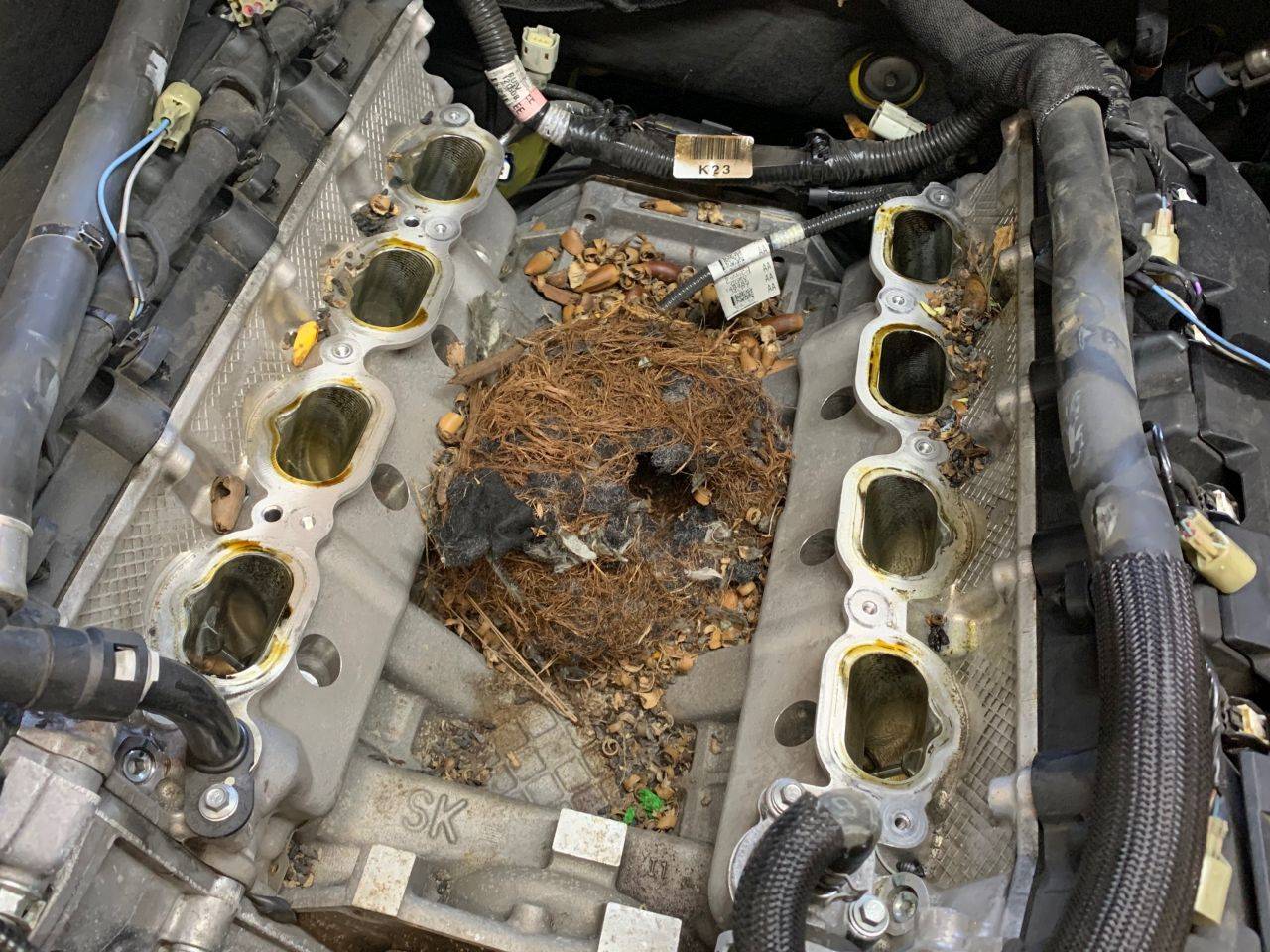

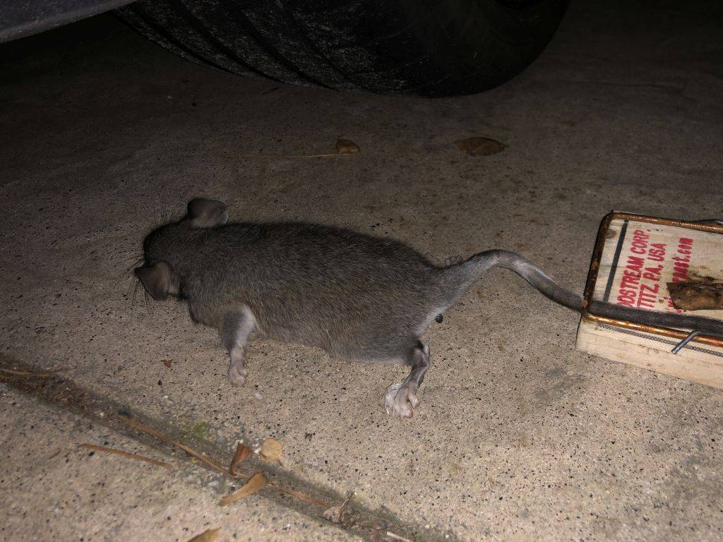

I ended up catching two rats in the trap over a couple week period. Second bugger shown below (he had also eaten the poison and died from that since obviously the trap only caught his tail).
I tried many things to keep the rats away, including stench spray and laundry sheets. That second rat just used the sheets in the nest!. I also tried ultrasonic emitters and lights. To make things weather resistant, I grabbed a small, clear, Tupperware bin and put the LED light bulb with an ultrasonic emitter inside and cut a small notch in the side to run an extension cord through. I keep the bind under the car, which makes it seem like I have one of those old underbody neon kits. Apparently the rats like light or ultrasound, so hopefully my contraption will keep them away (although since the ultrasound emitter is in the bin, I'm not sure it will be effective since that will damp the sound). In any case, no new rats since I caught the second one.
Finally got the car to the shop to have the wire harness repaired. I had also seen a rats nest between the intake manifold and the valley of the V8, and here is what that looked like! Hopefully everything got cleaned out and nothing escaped into the intake tract.
Will be very happy to get everything fixed up and road worthy again.

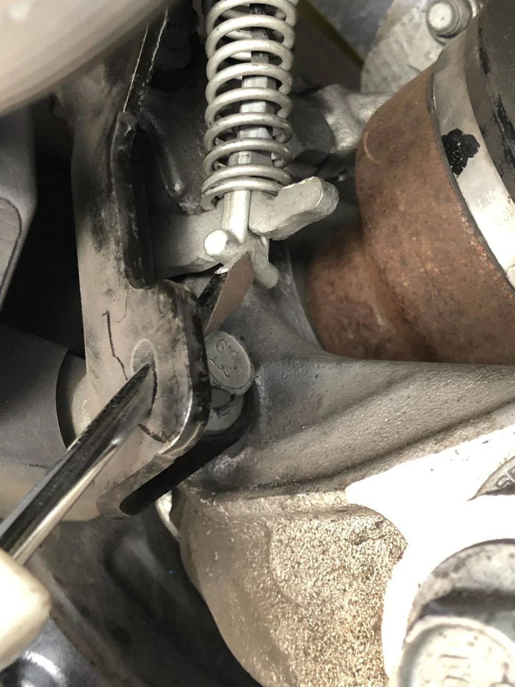

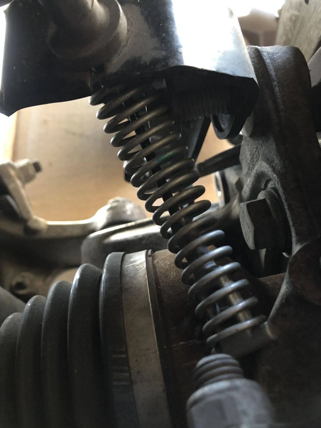

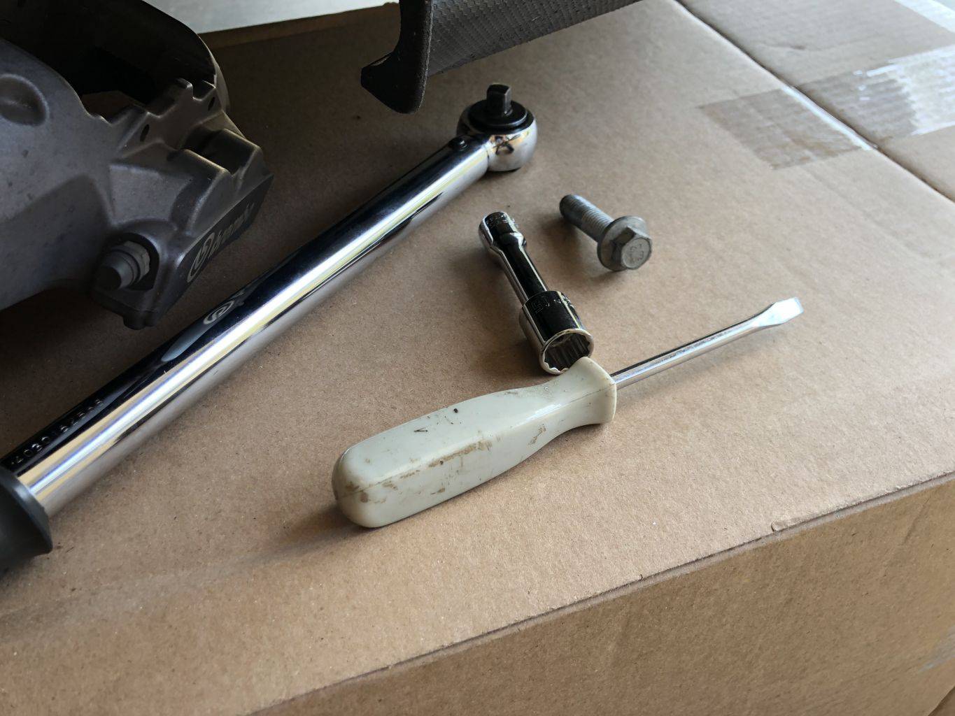

Finally got around to replacing the rear rotors on the car.
What a PITA! But, as always, you learn as you go and while it took about 3 hours to figure out the first wheel I did the second one in about an hour.
The big issue with replacing the rear rotors, is that the parking brake cable blocks access to the top brake caliper bolt. The parking brake on the GT350 is a mechanical drum brake that is activated by a lever that opens the drums onto the aluminum hat of the rear rotors. Definitely not something you want to use often to stop the car!
To expose the screw you need to get the cable out of the way, so here is how I did it:
  1. First, I jacked up the car (very easy since I have BMR jacking rails installed. Could jack up one side with the jack in the middle of the car, and put my two jack stands at the front and rear. I'd leave the opposite side of the car on the ground and throw a 2x4 behind the front wheel to make sure the car wouldn't want to roll (not much of a risk when on jack stands)
  2. Undo the parking brake to get as much slack in the cable as possible (I always forget to do this before jacking the car)
  3. Removed the rear wheel
  4. Removed the brake pads
  5. NOW FOR THE SUCKY PART- Unhooking the parking brake cable!
  6. There are some specialty tools available to do this, but its a 20 minute drive the auto parts store and I didn't want to do it. Instead, I farted around under the car for 60 minutes before figuring out the appropriate method, which required a flat-head screw driver
    1. Wearing gloves, I manually compressed the spring that holds the cable to the lever
    2. I then used the flat-head screw driver as a pry-bar (the big words on the handle stating "Do not use as prybar" are a clear indication that using it as a prybar is to be expected) to pop the cable off the lever (if you choose to buy (or already own) a spring compression tool, this might be easier, but I'm not sure I'd want to try and pop the cable off the lever with a big tool attached to the spring, so I was pretty happy with my method.
    3. Then, instead of trying to completely remove the cable from the bracket, which requires another specialized tool to compress all the little metal tangs so the bushing can fit back through the hole in the bracket, I instead just pushed the cable out of the way and up behind the wheel hub. This held it MOSTLY out of the way.
    4. At this point I found that I needed a short 15mm socket and 3" extension for my torque wrench, which required a 5 minute trip to the closest general hardware store.
    5. Once I returned I was able to get the socket in behind the cable/spring and the extension could route past it to the torque wrench.
  7. Now it was just a matter of unscrewing the bolts attaching the brake caliper/cable bracket to the hub - about 15 turns of the screw....1/8 of a turn at a time. Like the front brakes, the locking compound used on the screws is really strong, which makes removing the screws a bit of a pain. Also, they are torqued to 85 ft-lbs, which sucks because you can't fit a very long torque wrench in the wheel well, nor can you get in-line with your wrench because you need to reach deep into the well. So, it is quite awkward to perform that part of the process.
  8. However, once you get the screws out it is very easy to slide out the caliper and rest it on something under the car (I happened to have a perfectly size cardboard box) while swapping the brake rotors.
  9. Then its just a matter of re-installing the screws (per the factory manual you'd get new screws with new locking compound, or you can add threadlocker to the existing screws). Getting to 85 ft-lbs is a real pain.
  10. Then you'll need to re-attach the cable. This was actually not as bad as I feared.
    1. Once again I needed to manually compress the spring.
    2. Then I used the small slot in the cable bracket as a prying point along with my screwdriver/prybar to snap the cable hook back onto the lever. It worked like a charm.
  11. Reinstall the brake pads
  12. Reinstall the tire
  13. Repeat on the other side of the car!
Piece of cake!
I took some photos to show what I did in case someone else wants to perform a half-assed rotor swap like me rather than getting all the special tools.
Afterwards, I went to go fill up the car with gas (on the way to the station my range dropped to 0 miles to empty). The car took 15.4 gallons, so it was definitely on fumes.
Let's see if I can get the photos in order:
  • First, a look down from inside the wheel well, showing the parking brake cable/spring being held out of the way by the hub. You can see the backed-out screw under the cable/spring
  • Second, my perfectly sized box, showing the tools needed and also supporting the brake caliper.
  • Third, a view under the car, looking up at the bracket, showing how I used the slot on the bracket as a prying point to re-attach the cable with my combination prybar/flat-head screwdriver tool.
  • Finally, the proof of the fuel refill. Luckily the trip to the station was almost all downhill!
-T

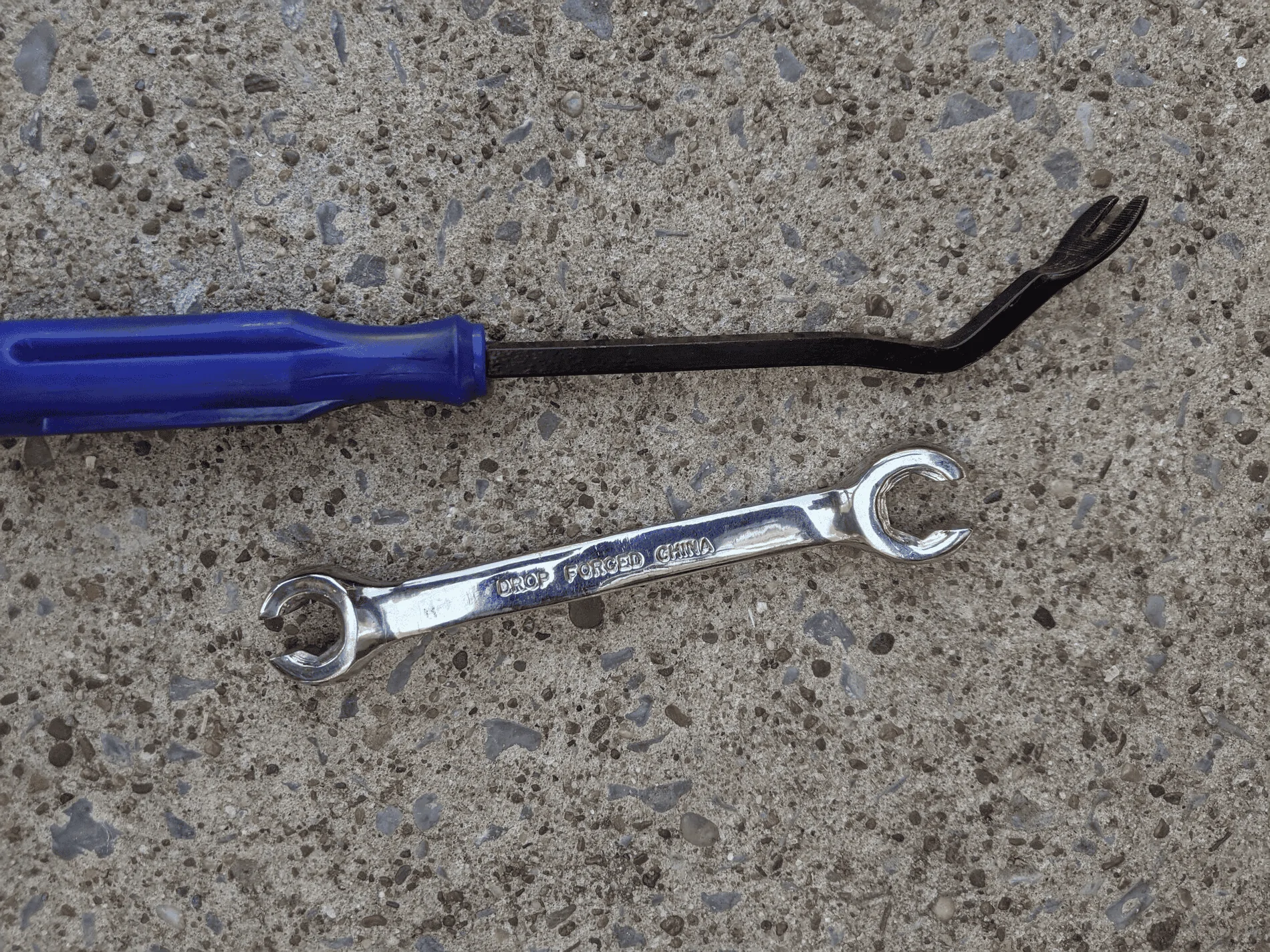

I've recently taken the rear brakes off and found a way to do so without the special tools that wasn't too difficult. I used a trim tool (screwdriver may work as well) to compress the spring so I could work the cable off the lever - not too different from your method. The other bit is that I found that a brake line wrench of the right size would work to get the cable out of the bracket, making the rest of the job much easier. Just pull down the spring, put the wrench around the cable below the bracket, and push up around the tangs to compress them so you can pull the cable out of the bracket. Once I had the right size wrench, it took less than a minute of wrangling to pop the cable free. With that cable completely out the way, the rest of the removal and replacement is very straightforward. Of course, this is dependent on having a different specialty tool (brake line wrench) but I figure more folks have those and they have more applications than one specifically for removing the brake cable. Lacking a brake line wrench, more creativity might be needed - perhaps a zip tie pulled around the tangs to compress them or something.

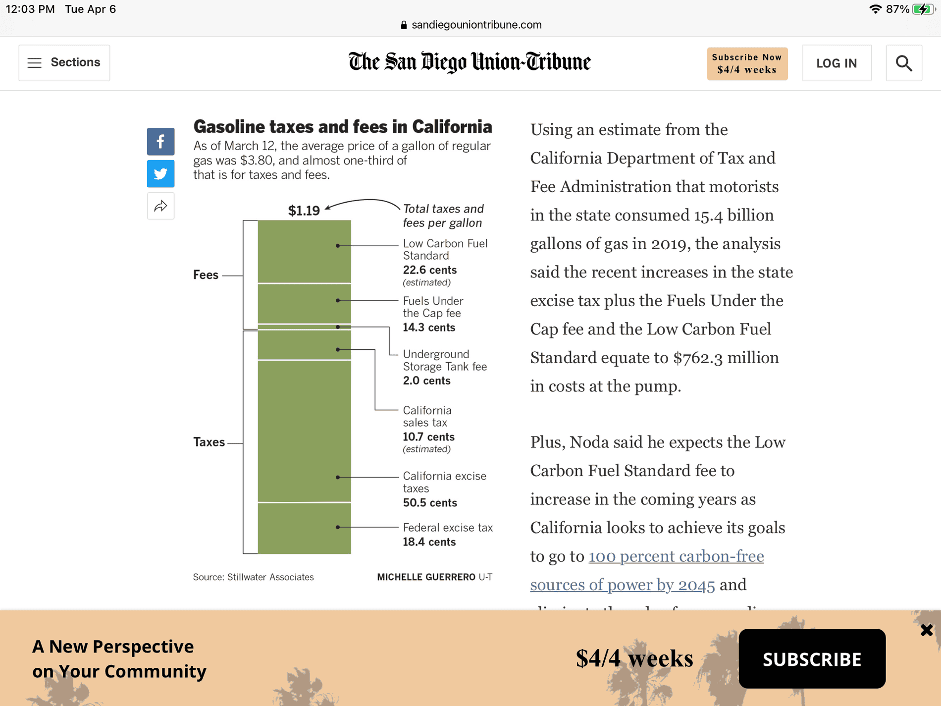

Gotta ask, what fuel are you buying for $4.40 a gallon?
