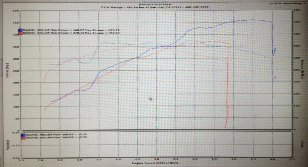

Last week, @ 2700 miles I had the oil changed and the car dyno'd. I used the OEM Motorcraft 5W-50 oil and OEM oil filter. I do feel that the 5W-50 seems a bit thick for normal use, since the car is running ~50-100 psi even when warm, but since that is what Ford recommends, that's what I'll stick with for now.
Here is a video of the dyno run:
[ame]
Here's a comparison shot of my run compared to a stock coyote:

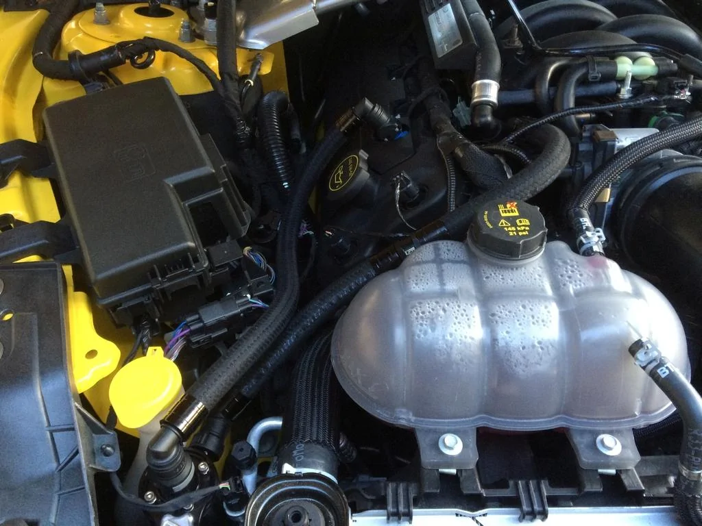

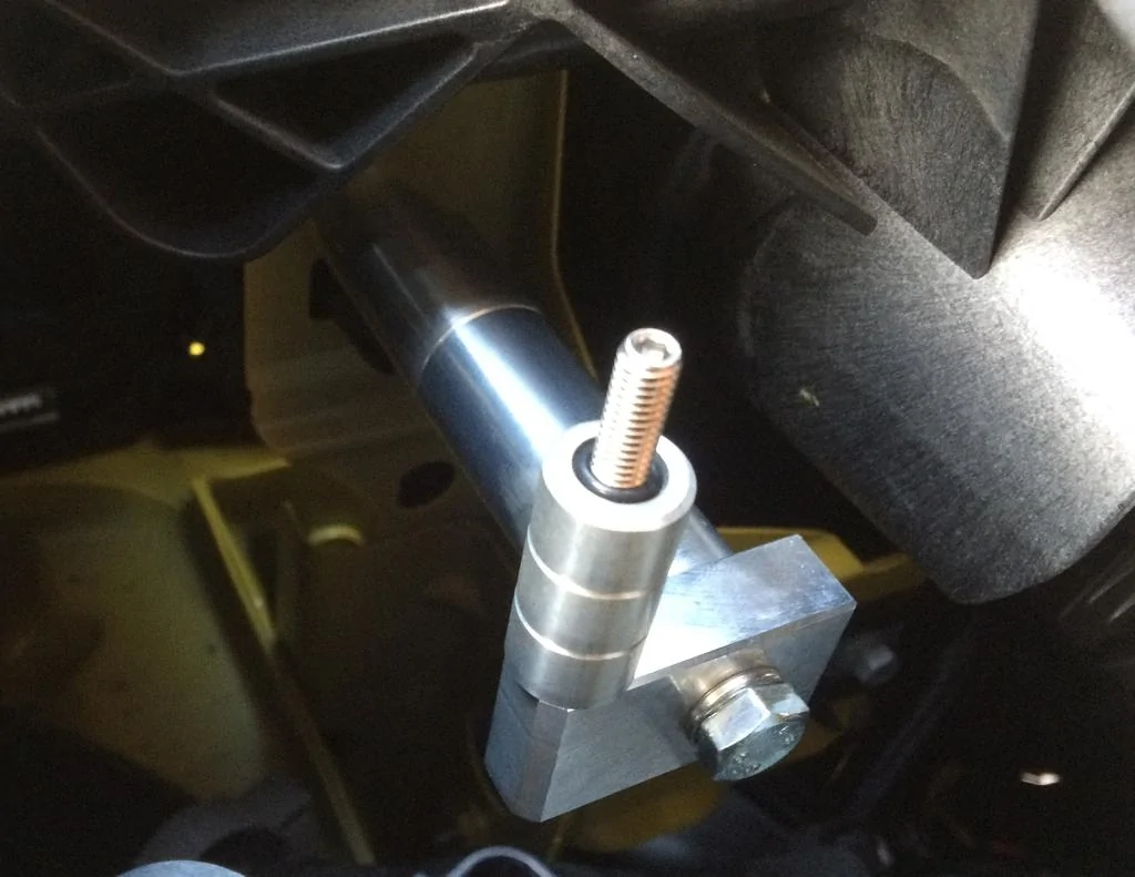

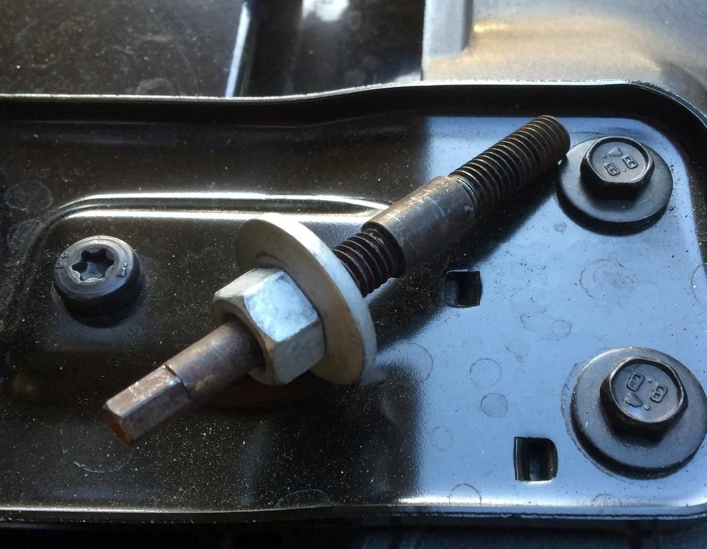

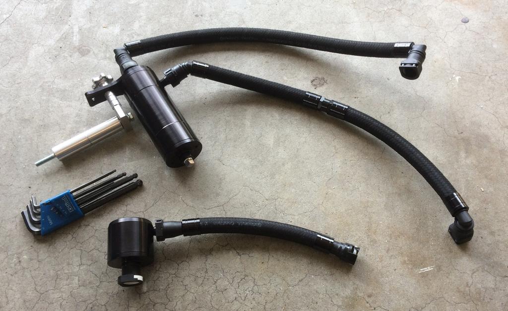

Yesterday, I installed the UPR GT350 Oil Catch Can. It is a very impressive set of components. The quality and attention to detail in the design is very nice. The hoses are all quick release, there is a nice thumb-nut to allow easy removal of the can for cleaning, the mounting bracket hardware is nicely retained on the screws with o-rings, and the installation was very easy.
I followed these instructions for installation, with slight modifications due to the differences between the GT350 and standard Mustang:
http://lib.store.yahoo.net/lib/yhst-37354654005614/upr-products-5030-98-install.pdf
For the GT350 you can skip to Step 2 as there isn't a radiator cover. Also, when performing Step 2, the GT350 does not use a single bolt, but rather a stud with a nut. So you need a 13mm deep socket for the nut, and then a 7/32" socket to remove the stud.
I've attached some photos of the install below.
1. All the components next to a standard set of allen wrenches for scale.
2. The nut/stud component
3. The mounting bracket installed
4. The routing of the PCV lines (note that I routed the clean line between the "fork" in the electrical harness @ the intake side. Trying to go over or under the harness did not work as well, and stressed the cables one way or the other.

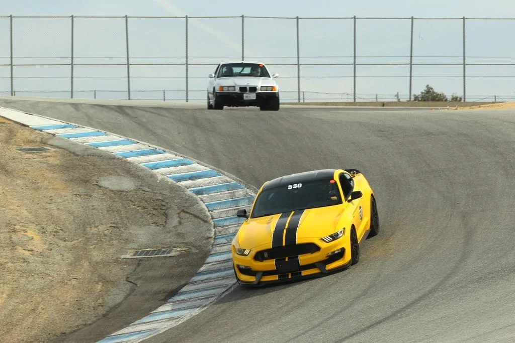

And here is another post with some photos.
The on-track photos were taken by http://www.gotbluemilk.com/

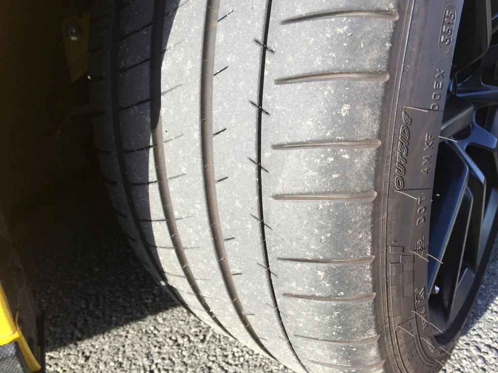

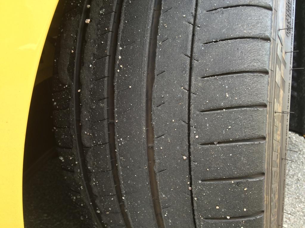

1. Breakfast of champions (not Sex, unfortunately)
2. On the way to the track
3. Front Tires before
4. Front Tires after
5. Exiting T6
6. Down the Corkscrew
7. Exiting T9
8. Temps after a 1/2 lap cooldown
-T

Sweet vids... nice runs too and very cool pics! Someday I'd love the experience MRLS.
Corkscrew capture is fantastic... yellow looks great! :thumbsup:
