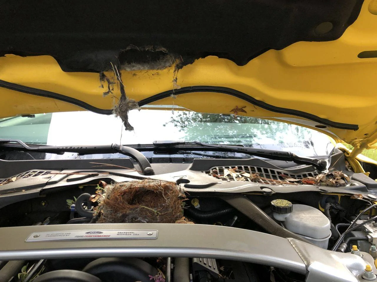

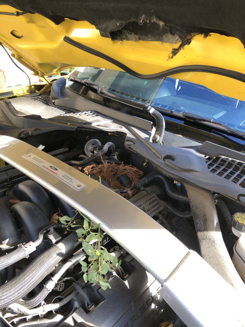

An even more annoying situation occurred yesterday (Friday, the 13th of course), when I went to do my weekly drive to work. I luckily decided to check the oil before heading out, and found a rats next in the hood, WITH THE RAT STARING ME IN THE FACE! He skedaddled as soon as I opened the hood (probably ran in to the garage where he'll feast on dog and cat food for the next few years), but he left behind a huge mess. I used our leafblower to clean out the engine bay, but I think the little bugger chewed on some important cables or hoses because now the car idles funny and throws a check engine light. I will be going to the auto store today and will see if I can get an OBD reader to see what the codes are. Hopefully the issue is relatively contained and not something that requires a complete wire harness replacement or something like that.
So, got some work to do!
If anyone has suggestions for keeping critters out of the car, feel free to post 'em up.
-T
You can buy a plastic owl and post it nearby. Also use bobcat spray occasionally.
If you end up having to take the car to dealer or shop to repair the damage, you can file with your insurance if the cost exceeds your deductible.

Well, I got the code reader, and before even plugging it in I took another look at the engine bay and saw that the little bastard had already started building a new nest.

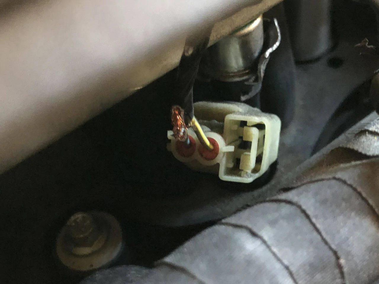

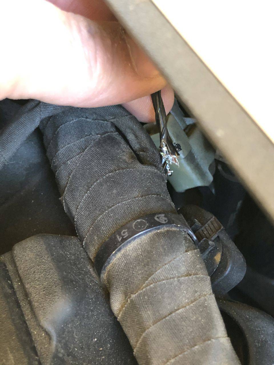

I inspected the cabling more closely, and saw that the #2 cylinder injector cable had been chewed.
When I plugged in the code reader, sure enough, I had several errors in cylinder #2 including misfires and injector issues. There was also a misfire on cylinder #6, but I didn't see anything wrong with the cabling there. That code didn't have as detailed info, so maybe it was more of an informational code than a true problem. I didn't note all the codes, but will go back and get that info and update the post accordingly.
In any case, the injector cable looks to be part of the main engine wiring harness, which coils like a snake through every nook and cranny of the engine bay. It does not look like an inexpensive repair, unless one were to strip back some of the sheathing and try to splice in a new cable.

Splicing that wire will change it’s impedance some which may cause the injector to act weird and throw a code. The voltage might drop a bit. I say give it a try before you have the whole harness ripped out. I’d also look around the garage and find out how the rodents are getting in. I think sticky traps work the best
Unfotunately the wife gets the garage. The Mustang gets parking right in front of the house. I agree that attempting a splice seems worthwhile.
Does anyone know the state of the injectors when the signal is interrupted (I would assume they shut off)? Let's say I had to drive on 7 cylinders for 40 miles. Thoughts?

With no power to the injectors they won’t squirt fuel into the cylinders. But it will run rough and cause odd vibrations. Will that cause damage? Don’t know. Rodents eating insulation is actually a big problem in lots of places. You think by now the people that make it would formulate something less tasty to them.
