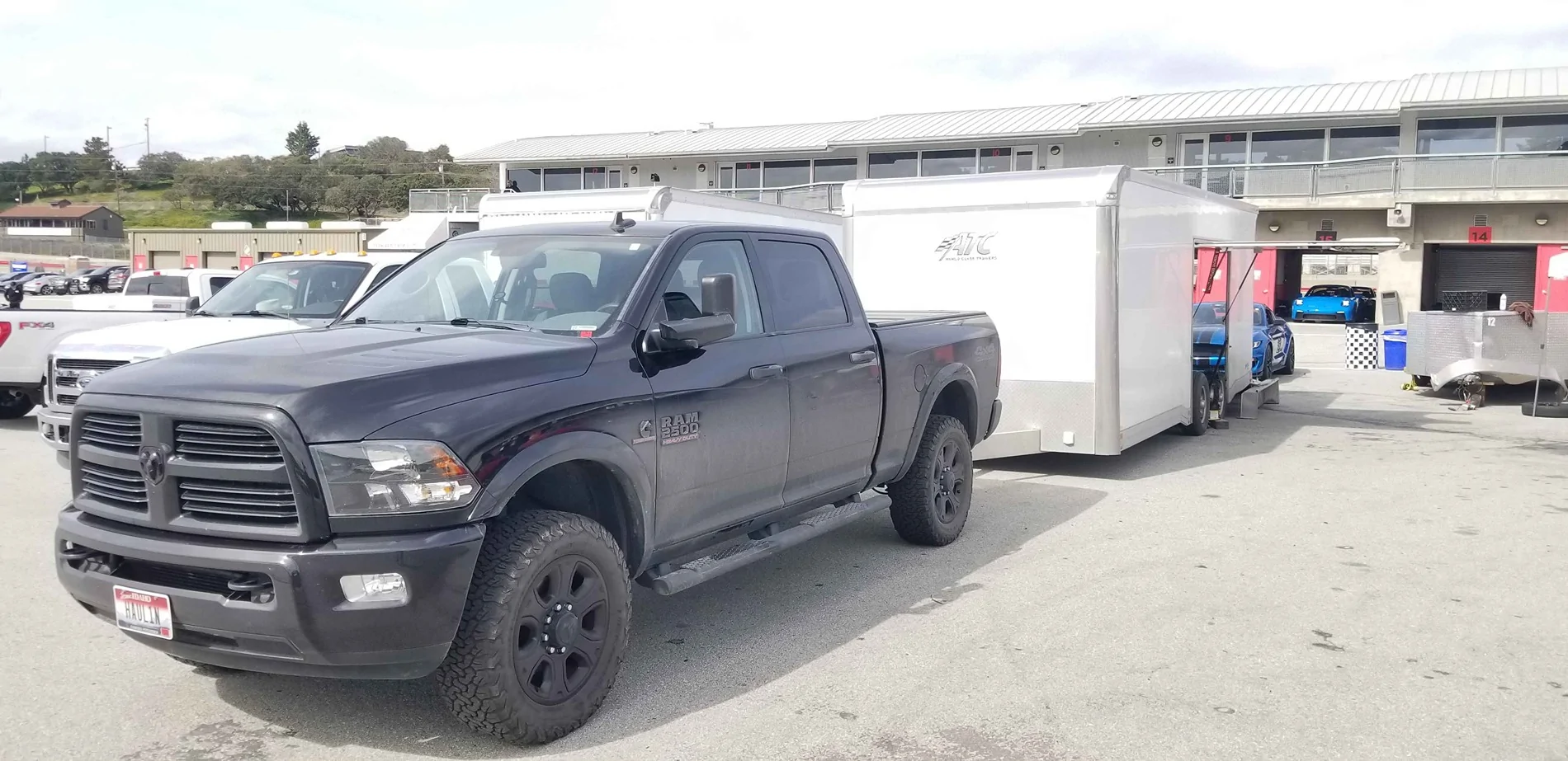

Ram: Beautiful truck, but it depreciates quickly and Stellantis reliability............Also, I don't like how the Hurricane I-6 doesn't have an oil dipstick.

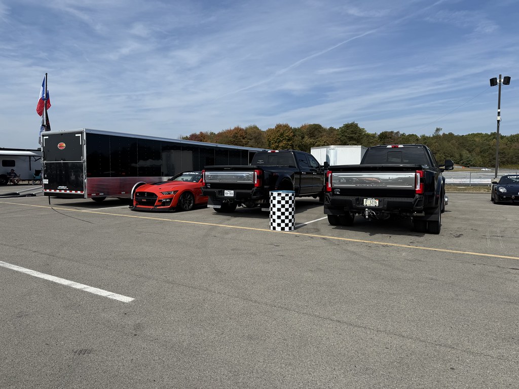

If you think the Ram depreciates, use that to your advantage. Find a used 2014 - 2018 Ram 2500 diesel. Can't beat proven Cummins reliability and at 50K miles, the engine is just getting broken in.

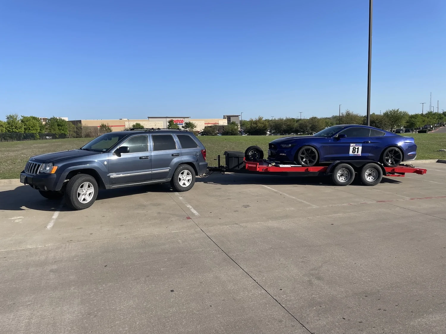

I'm going to go against the grain and say that a large SUV or turbo midsize truck is perfectly fine for towing the typical open trailer. This is assuming that you are all within the rated payload and tow ratings and using a weight distributing hitch. This would also mean that half tons are well suited but you have to be aware that higher trim levels can have poor payload numbers as well. I do think that enclosed trailers warrant a 3/4 ton, I have done it with a half ton and it did not instill confidence. I would not want to tow this with an NA V6, they just don't have enough torque.
I towed with this setup for a good 4 years and it always felt very stable. 2009 Grand Cherokee 5.7 Hemi, I did add a trans cooler, brake controller, and rear airbags. Trailer + car + tools weighs about 6200lbs and I do use a recurve r3 weight distribution hitch. The hitch is the magic sauce to make this all work. I probably towed over 5k miles with this setup and would get 10-12mpg.

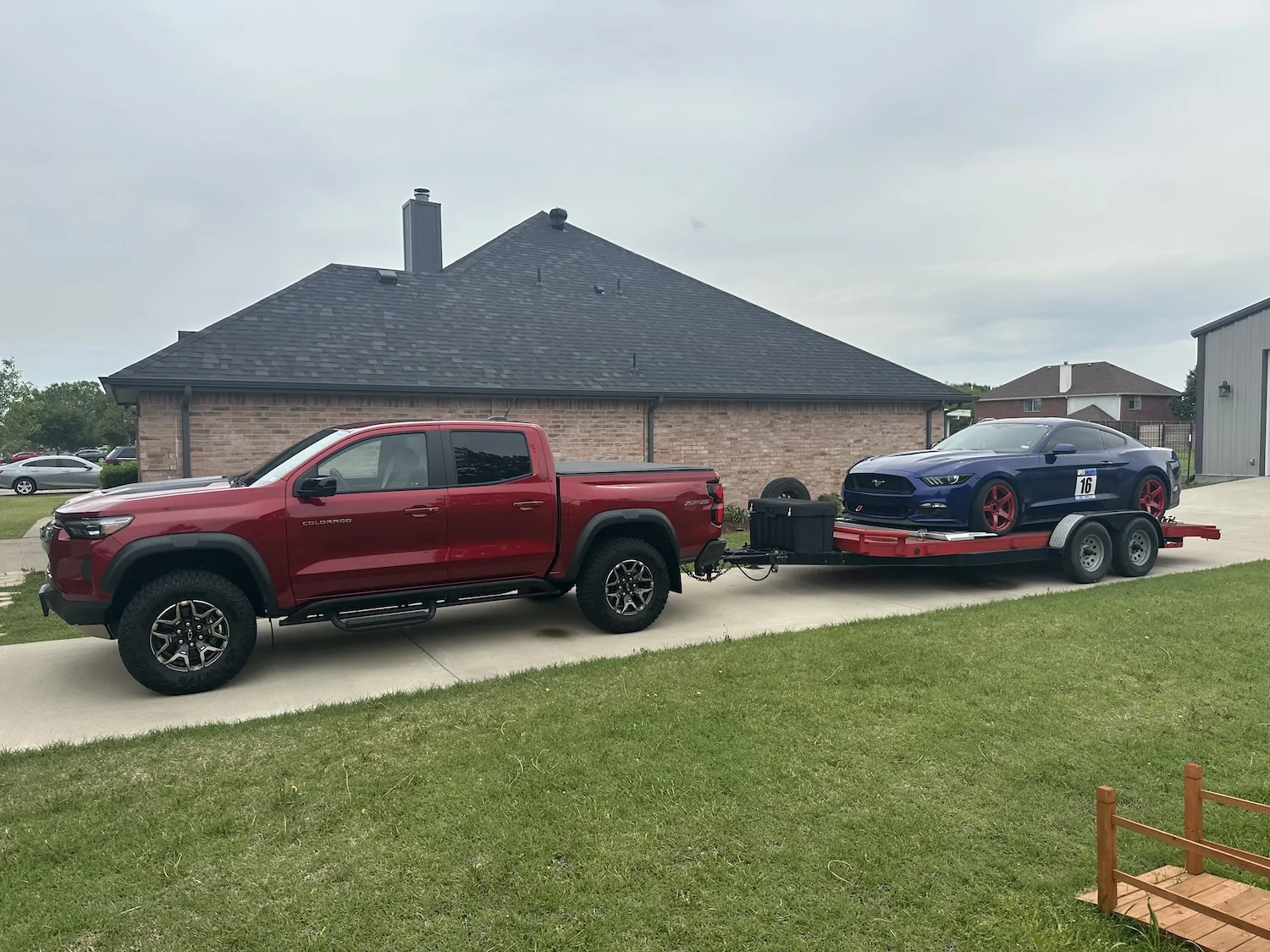

Now I tow with a 2023 Colorado and have been very happy with it. Power is adequate for this load although the V8 Jeep was a little quicker. Stability is great with the same WDH and the built in brake controller is super smooth compared to the aftermarket unit I used in the Jeep. The bed is convenient for extra tires and fuel jugs although I still put most of my tools in the tongue box. I've towed over 3k miles with this setup, including a few out of state trips, and total average is 12.1mpg. On some stretches I can touch 14mpg at 70mph.

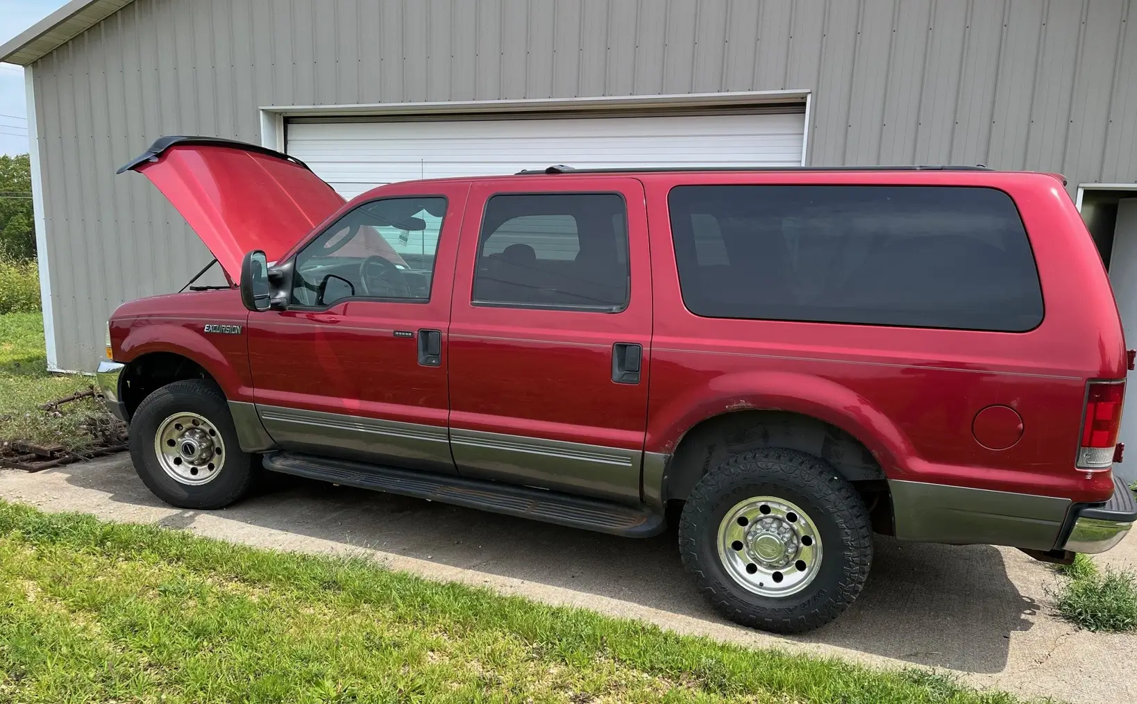

I went through this recently. I'm really cheap, so I spent $2,000 on a 2003 Excursion with the 6.8 gas V10. It needed quite a bit of maintenance and repair, which had the bonus of being fun. All in, I think I have about 6k in it including new tires, shocks, some steering components, switchgear, stereo, fluids, etc., but I foolishly let a local shop replace some of the suspension parts rather than doing it myself. You could do it for less, for sure. I have a F250 SD with the same drivetrain and I've had really good luck with it.
Both of them have ~250,000 miles on them. The Excursion had one popped spark plug, but the insert was fairly easy to do. I bought a bore scope to make sure I got all the shavings out of the cylinder after drilling and tapping. I looked at all the threads and all the cylinders. They still have the cross hatching on them.
I've been driving the Excursion occasionally on bad weather days instead of the Camaro. I've found I kind of miss 90s Fords. It's pretty peppy without a trailer. I'm sure it wouldn't keep up with a modern 7.3 gas engine. My neighbor has 3 of the Excursions with the 7.3 Power Stroke and a handful of the super duty pickups with the 7.3 PS. He tows all the time, and I would recommend that setup for heavier or longer towing.
