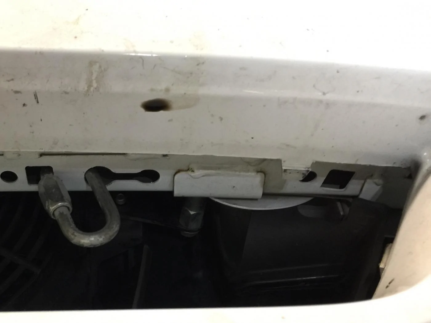

If you have removed the lower grill, on the drivers side near the two front bumper support bolts there is a series of holes.
You can run a large hardware store threaded link (maillion) thru there.
Prime it white and then bright red and put a piece of ribbon or red webbing just hanging so its more obvious or add blue tape or white or red arrow to bumper.

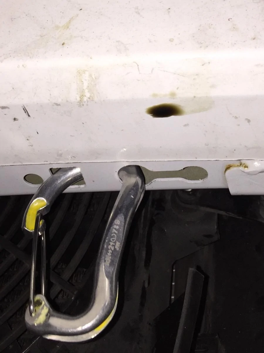

You could always buy an expensive locking climbing carabiner if weight matters.

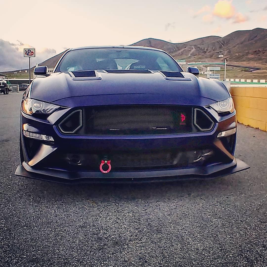

It depends on which hook you use. The Ford Performance must be in the center and requires modification of the upper grill. ZL1Addons offers both the side and center mount. These are just two examples.

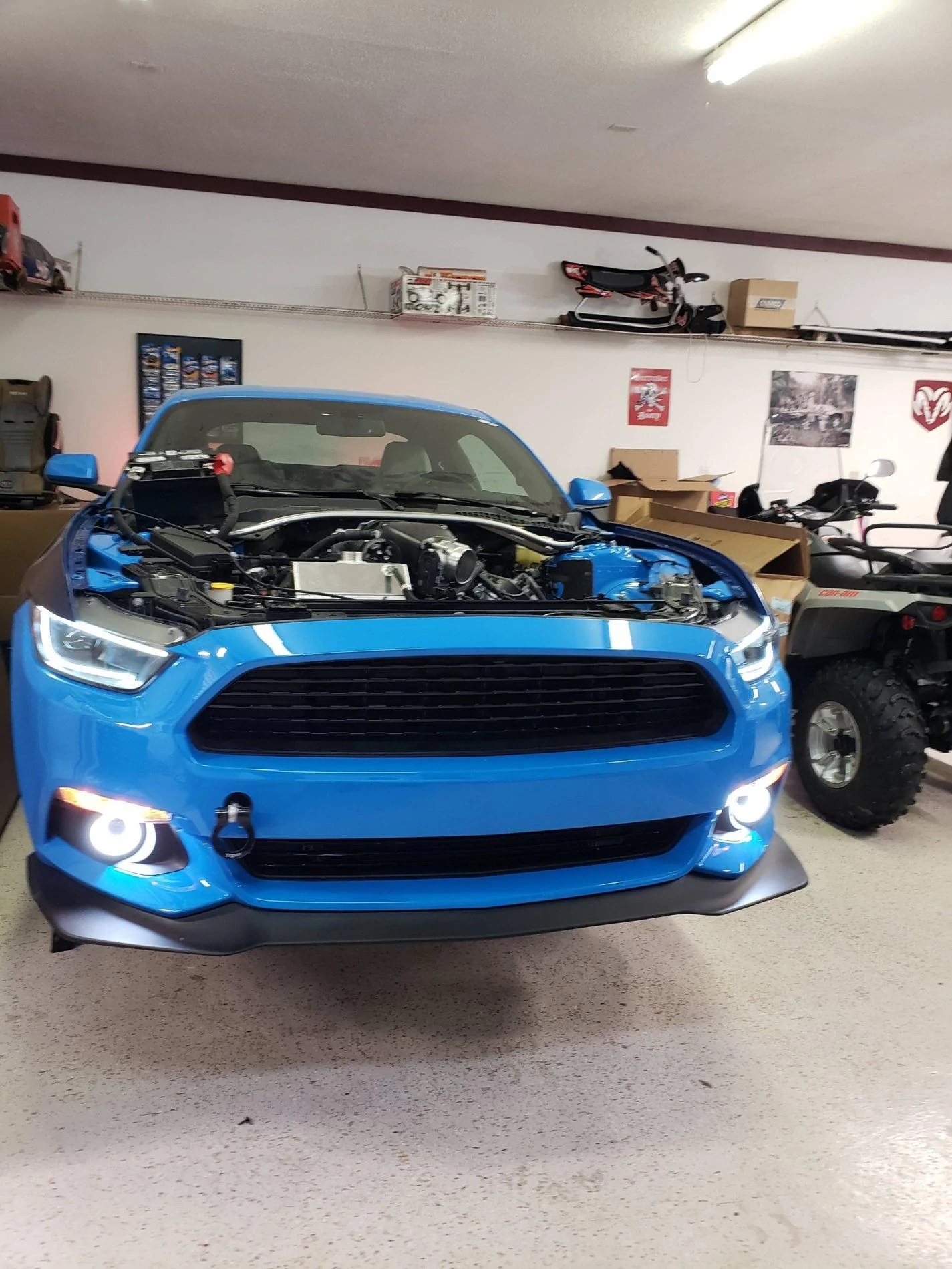

I'm very pleased with my towhook by ZL1ADDONS
