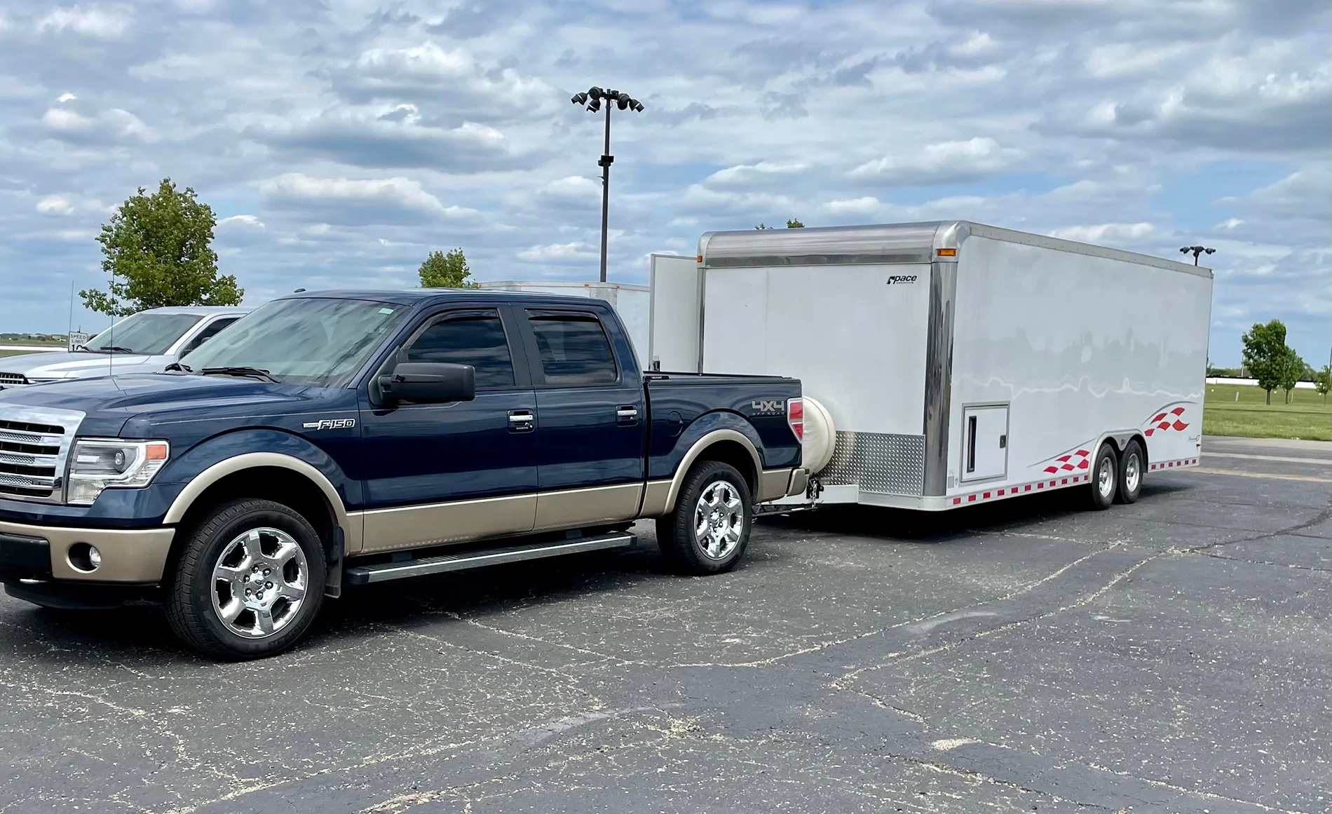

I have a 2014 F150 SuperCrew Lariat with a 6.2L V8. It is the same engine that came in the Raptor from that generation F150 - 411HP/434TQ. Rare as hen's teeth but very old school reliable. Worst thing is the spark plug change (there are 16 of them) and it has hydraulic power steering. Also fuel economy is not great - average around town is 14-15mpg and 9-11mpg towing.
I bought it to tow a 24ft enclosed trailer for my road race car. I have also used it to go to Nationals with my Mustang a couple of times. It works fine but honestly a 3/4 ton would be a better choice for this trailer. A truck like ours or one with a 5.0 would easily handle an open trailer.
Don't sleep on the last steel body F150's. The 5.0s from that generation didn't have a wet belt for the oil pump and the 6spd trans they were using back then is rock solid. Of course there is also the 6.2L if you can find one.

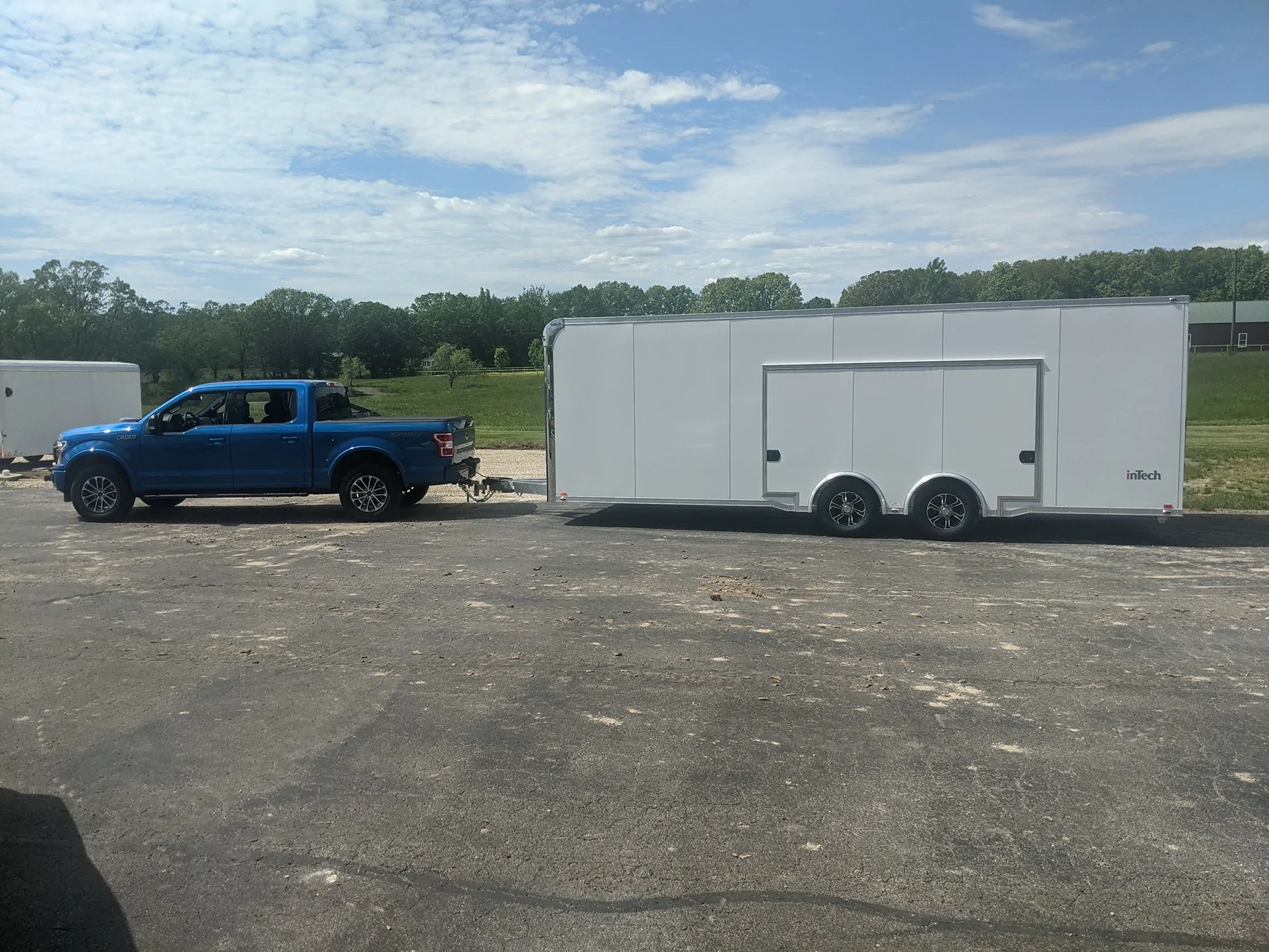

Much depends on the trailer you intend to tow. Even a 1/2 ton pickup could be dicey if you're hauling a large heavy enclosed trailer and the truck hasn't had the correct build. F-150 can be configured in ways that towing capacity could be anywhere between 5,000-13,000lb depending on the build sheet. The other makes will be a similar situation. Bottom line, need some feedback on your proposed trailer before we can recommend a tow vehicle.
Having said that, I tow a 8.5x24 aluminum enclosed trailer (around 8500lb fully loaded) with my 2019 F-150 (XLT, 3.5L, standard wheelbase, Max-tow package, 3.55 rear end). Roughly 100k total miles, 30k pulling the trailer. Ford replaced the cam phasers around 50k under warranty. Other than that it's been 100% reliable.

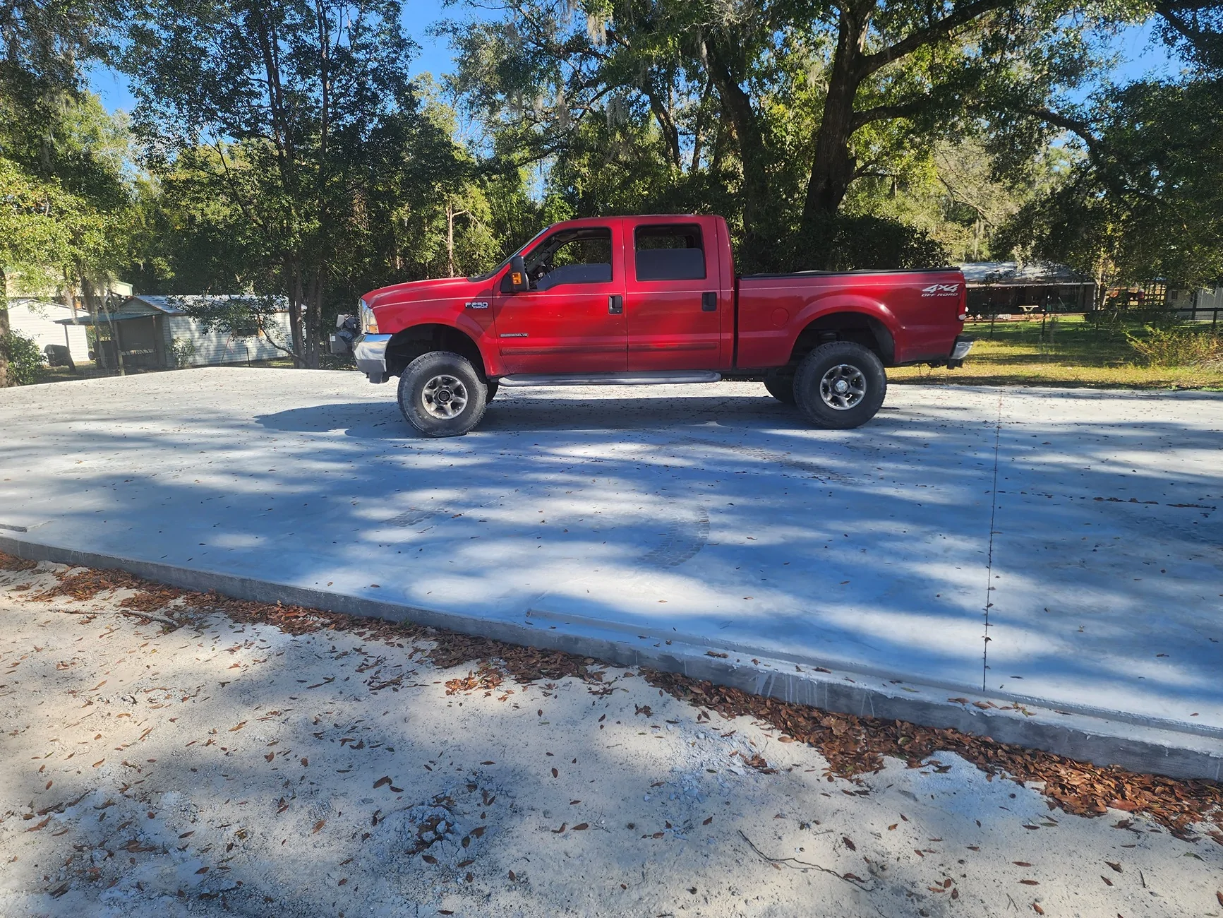

2001 f250 7.3 Diesel behind my 24 ft enclosed trailer. or the 2002 Excursion with the 7.3 Diesel also works
