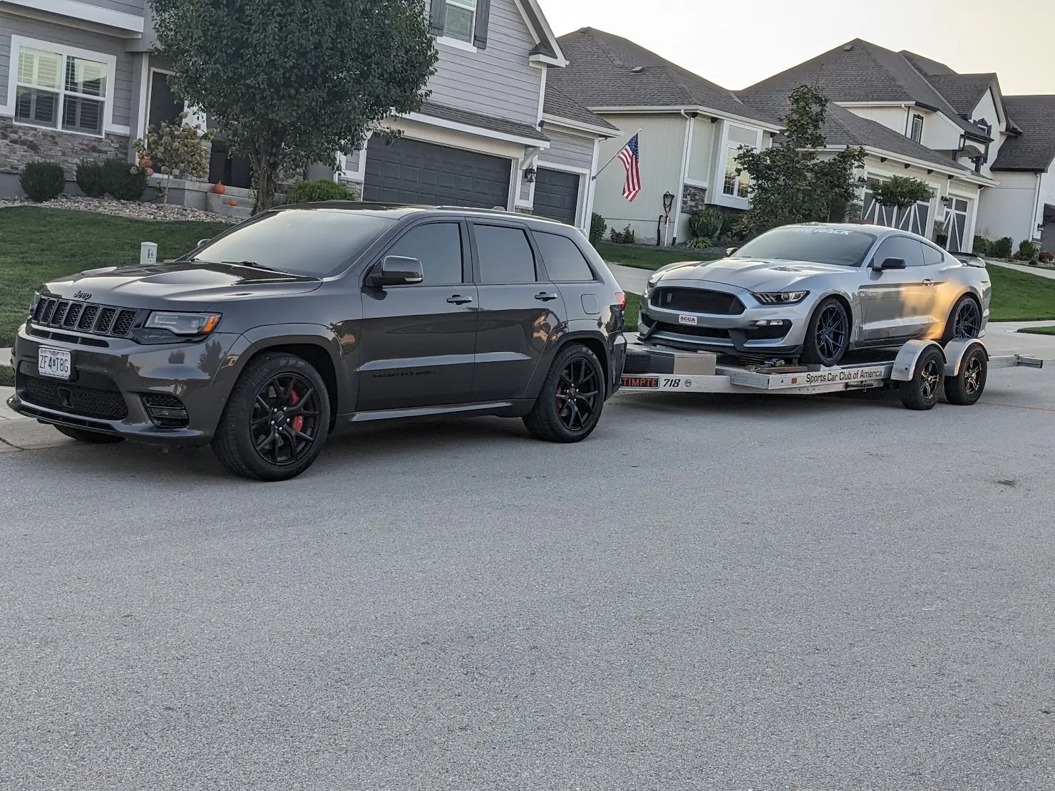

I've had great luck with the Jeep Grand Cherokee Hemi. I had a '20 GC Summit Hemi with the air suspension that worked great, no complaints other than I never liked the shock valving for street driving - it was soft and I felt it was under damped.
I replaced it with the SRT 6.4 Hemi mostly because I just wanted something more fun for driving daily and it does not disappoint. Tows great, gets about the same mileage towing or not, but no worse than a truck. I wouldn't recommend it for a closed trailer but it hauls my 5300 lbs with ease.

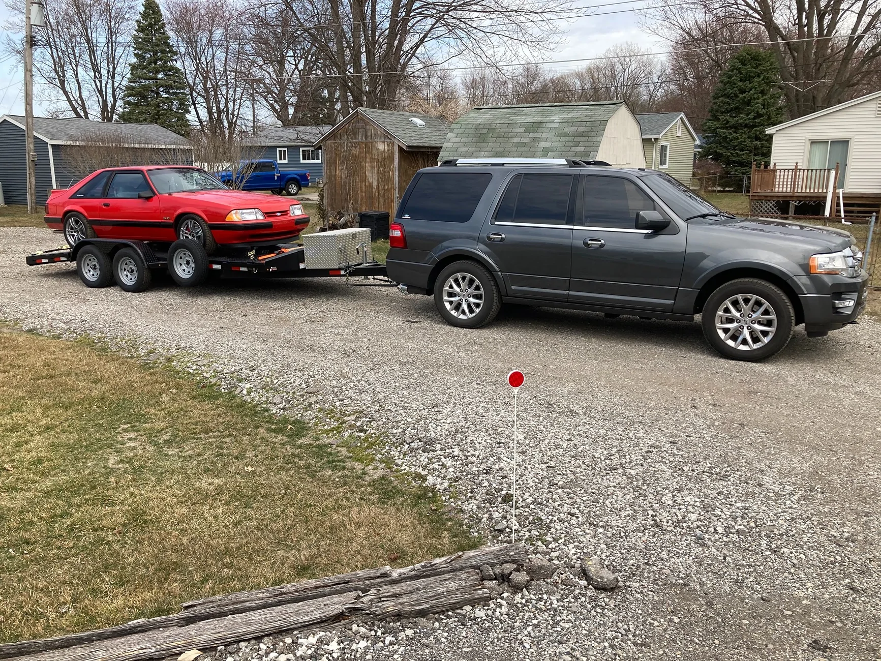

Pretty much every shot shared here is an open trailer. For an enclosed trailer, a Super Duty level truck is the way to go. No question. GM, Ram, or Ford all have suitable units. Gas or diesel.
Attached is my 2017 Expy with my Fox on the trailer. The Fox is replaced with a 2018, the Expedition replaced with a 2023. Both 3.5EB with tow package. Never had an issue with either.

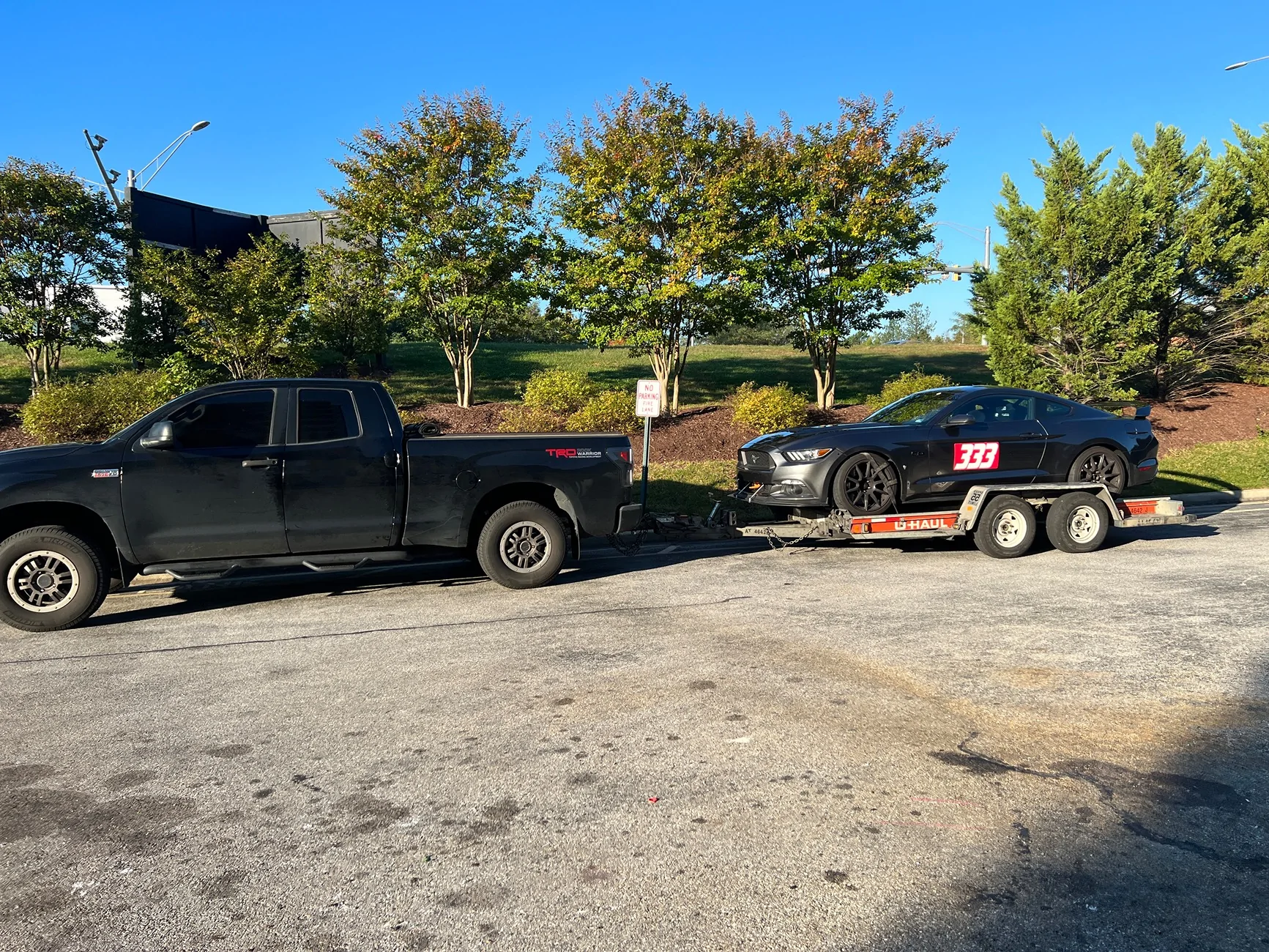

I have had no issues with my 2010 Tundra 5.7
as other have mentioned the newer ones don’t have the reliability. If you go with a 2.5 Gen (2014-2021) you may have to add a trans cooler (kits available). Tow capacity is 10.8k for the 5.7.
the only down fall is gas mileage compared to other half tons. Towing from Baltimore to Roat Atlanta required quite a bit of stops for my liking. I plan to add a 46 gal tank. Otherwise it’s a great reliable vehicle.

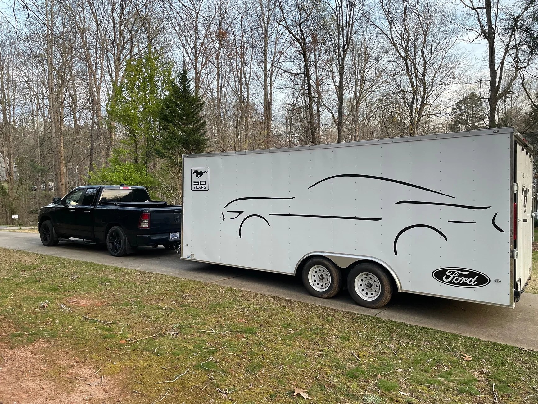

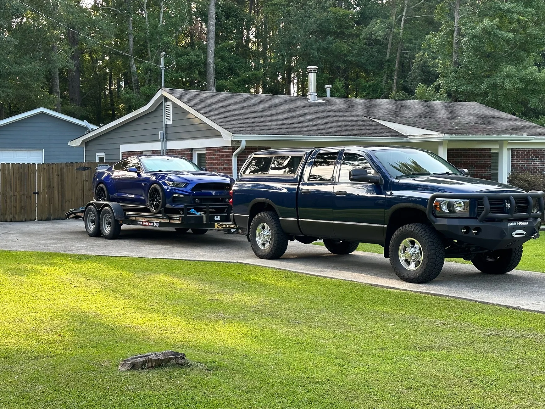

In my experience with towing a Mustang to the track.
I Started with: RAM 1500, Kurt weight distribution hitch, open steel trailer = no issues weight wise, drivability or wind gusts, everything was good.
Next step was an Enclosed 24ft flat nose trailer = no issues weight wise, pulling or gearing, installed Bump stops on truck to prevent squat.. however, this was not a nice ride, the front end of the truck felt light, the cross winds and Semi’s on highways used to influence and sway the rig. When you get into 8hr tow to tracks it is very noticeable.
After a few trips Raleigh to Atlanta, something had to change.
The 1500 was not pleasant, it was great as my daily, but not good as a tow vehicle, particularly as I had also purchased a 32ft Camper..
I took some time to research Gas / Diesel, gearing, suspension, tow weights, tongue weights etc.. even adding airbags to the 1500, it’s weight compared to the enclosed trailer and a fat Mustang Inside was borderline safe.
The decision was to step up to a HD Truck (2500), although it would still be my DD with only 15% towing time. I found Used / low mileage availability’s an issue - HD trucks are either work trucks (tradesman) or fully loaded high end (spec and $$)tow vehicles. Diesel was the typical choice, but not ideal for a DD, they like to run long and hot, not short trips to work, stores etc.
I stumbled upon a Ram 2500 Power Wagon, which has a bit of both worlds, off road package, lifted, Heavy Duty, Gas V8 and capable towing (not as much s std 2500) but enough for all my needs.
Comparing the size of the 2500 to the 1500, it’s enormous. Everything is so much more robust, frame, suspension, tow hitch etc..
the Power wagon is almost the same size as the trailer, it pulls fantastic, has been stable in all weather I have encountered.. but does suffer MPG of course as a gasser.
This is just my experience over the last 10 years, others may agree / disagree.
Good luck in your search.
