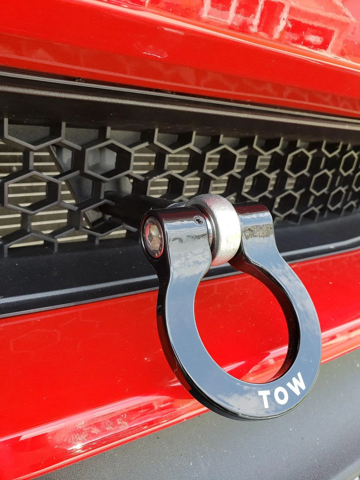

I just installed this hook. Very easy. Had to figure a few things out since I have an intercooler that brackets to the same spot. I don't think I will be able to line it up perfectly with a hole, so I may snip off a little piece of the grill. Wont be noticiable
The most perplexing part to me was the instruction to move the air probe. Ended up not moving it and the bracket clears it fine.
Hint for other procharger owners. Loosen the bracket bolts on both sides of the intercooler. Impossible to get the bracket back on without loosening the otherside also

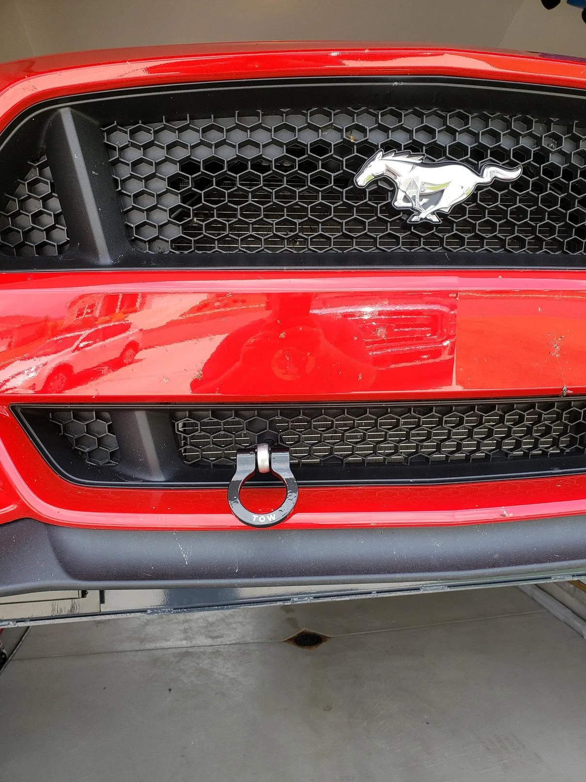

Just got mine on today. Seeing how it mounts up, I feel good that I'll be able to pull on it without hurting anything no problem. I did have to trim the grill a little bit for the hook but no biggie.
Also had the same experience with the temp probe. Removed it like the instructions said and ended up putting it back just like it was. Wish I had never removed it as now it's a little loose. The plastic tree fastener just won't go in like it was originally. It clears as just fine.

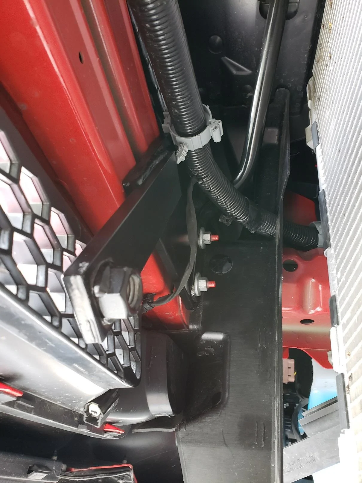

I'll get a better picture backed off of the car once I get it off of the lift.

A picture from behind when mounting the receiver. Note how when pulling on it you'd be pulling into the back of the crash bar. This is why I think it will be nice and stout.
