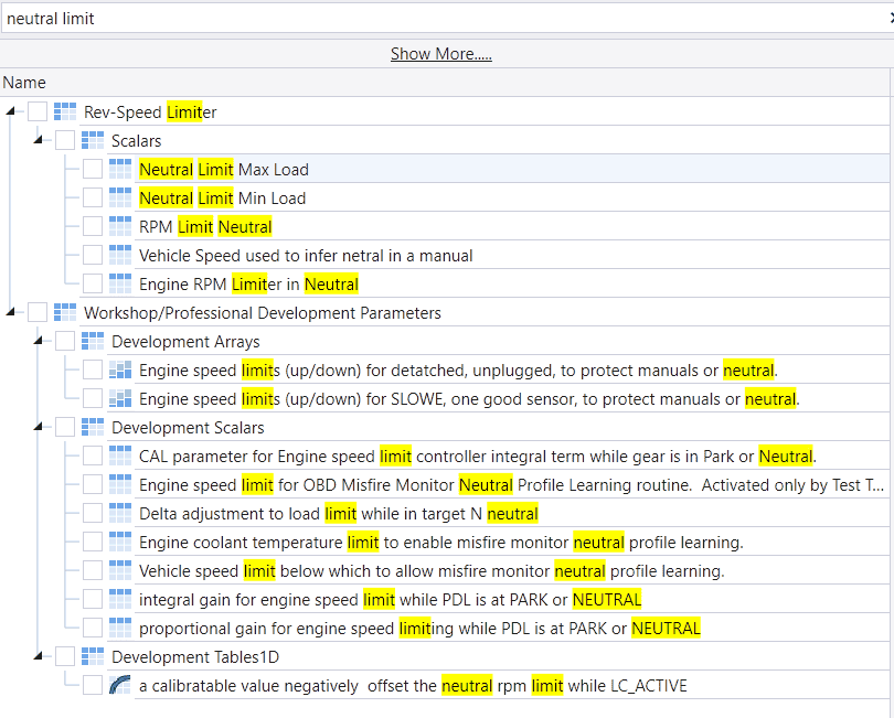

You can't change what mode it starts in but you can compare the different drive modes and copy tables. You could also potentially change the indexes to make normal track and track normalalso

@Vlad Soare the auto cars have that same “feature”. If you pop it into neutral and touch the pedal it’s very sluggish and doesn’t rev freely. If you want, you can log torque request, etc source, torque source, desired load, and desired airmass and that should point us in the right direction. I bet we can improve it.
