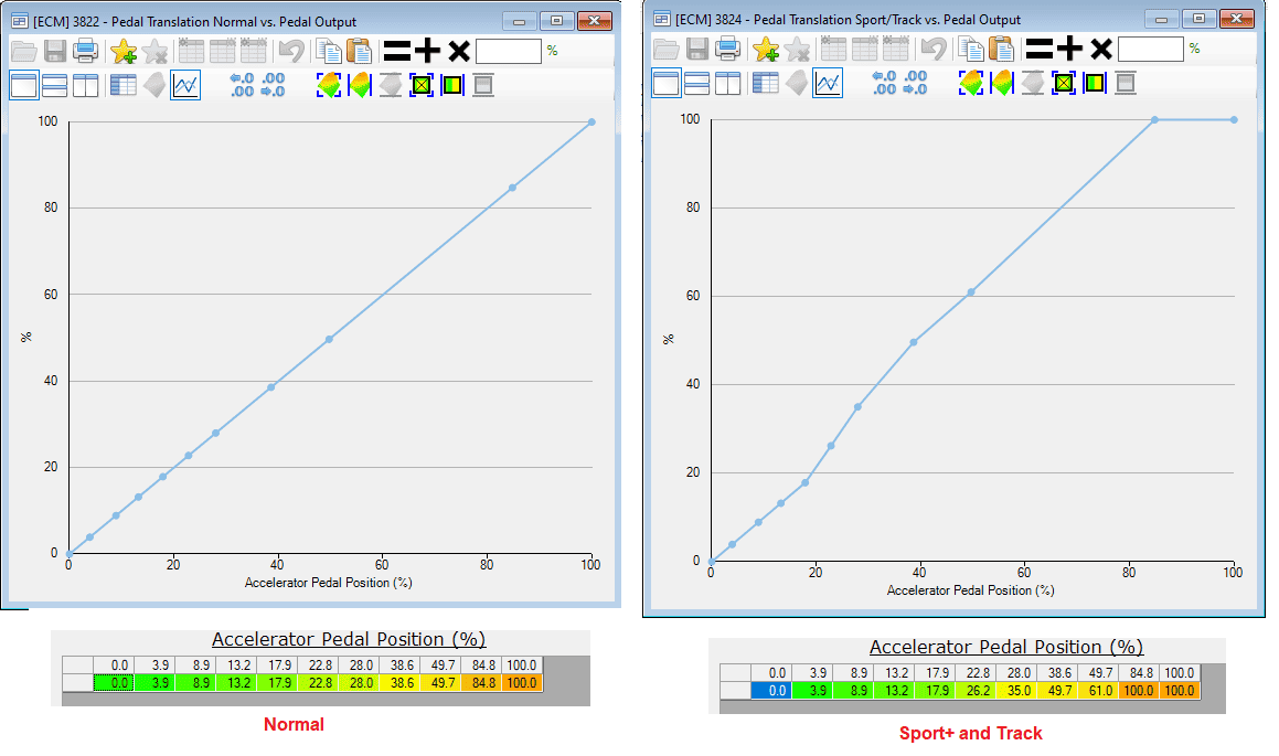

The throttle mapping in Sport+ and Track is identical.
There you go again confusing us with facts.
Btw, what year car/ecu did you examine? I do think there have been changes on that front.
I need to get my readouts going again

I'd assume a 2020.
But my understanding was, 2015-2017, Track mode had the sensitive throttle, where as Sport was less sensitive. That flip flopped in 2018. And generally matches what GM did in their 1LE. A friend who tracks his 1LE and his brothers 2017 GT said the throttle on the GT, in track mode, is very touchy comparatively.
Just anecdotal, I know. But figured I'd throw it out there.
Vlad, thanks for sharing, would love more info on where you got the mapping because I'd love my Track mode to be more linear.

2020 GT M6
It used to be like that before I changed it and made it linear in all modes. I didn't like the artificial boost it had in Sport+.

It's from HPtuners. The interface is a bit pricey, so it may not make much sense to buy it just for this purpose. Any tuner worth his salt can easily adjust the throttle mapping to your liking.
