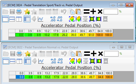

I've always believe that the issues people point to with sport+ on a manual may be a bit overexaggerated. However I absolutely despise the idea of a fake snappy throttle that changes with drive modes.
The difference between normal and sport doesn't start until you get above 28% throttle input. So for starting from a stop and creeping around it shouldn't make a difference unless you are using a lot of throttle.
With that said, I remapped my sport mode to be entirely linear because its herky-jerky when you are in gear, and I think fake snappy throttle mapping is dumb and useless.
More importantly if we're trying to drive the car well and near its limits it's critical the the behavior of the car is predictable. When I'm driving my car every day I'm not just getting to work I'm learning how the throttle translates to power at the wheels. So then, I switch to Sport+ when I want to drive hard and now the throttle mapping is very aggressive and different from what I'm used to. We're combining an unfamiliar throttle response with reduced AdvanceTrac intervention, with hard driving, that feels like a recipe for disaster. I have to wonder if it contributes to the number of people who send these cars flying into the ditch. Anyway that's my rant against weird throttle mapping thank you for coming to my ted talk.
Couldn't agree more. Sport mode throttle map is terrible.
