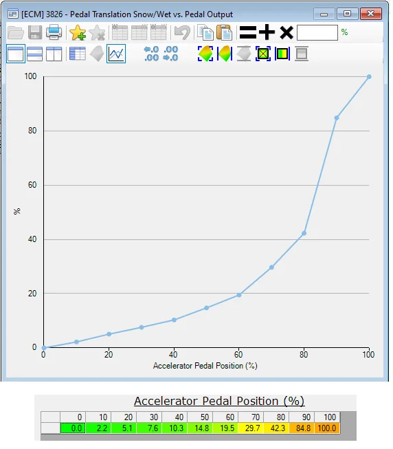

Here's how the Rain/Snow mode looks:
I'm very surprised it's that aggressively flat. And that they thought it was a good idea to go to 100. Why not just make full throttle say 60pct?

Indeed, I find that strange, too. Ironically, I think it's even more dangerous like this than the Normal mode is. Because you press the pedal and nothing happens, so you press it a bit harder and nothing happens, so you press it a bit harder, until it suddenly opens to 80%. On a slippery surface this is the last thing you want.

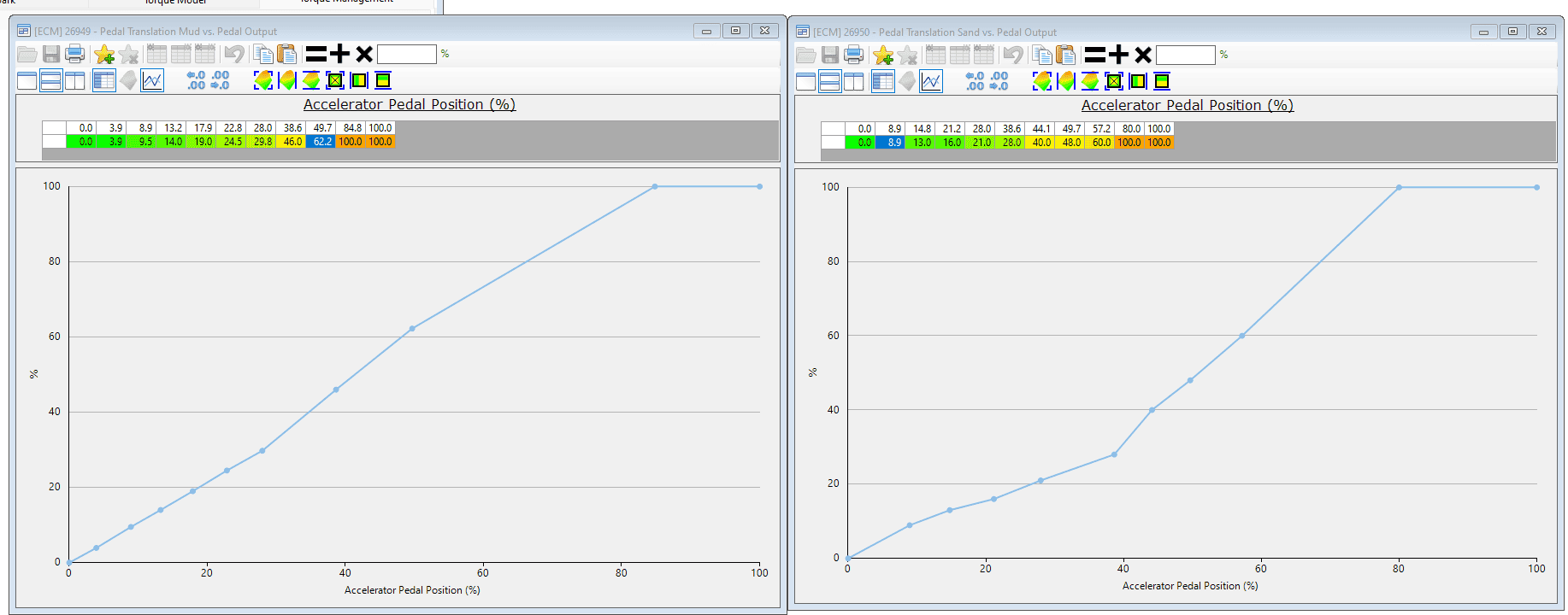

Mud vs Sand which on my car is sport+ vs Drag. You can see how lazy drag mode is. Its really for WOT only.

And you can really feel the 100% throttle vs 80% pedal when you let off. It feels like a throttle hang.
