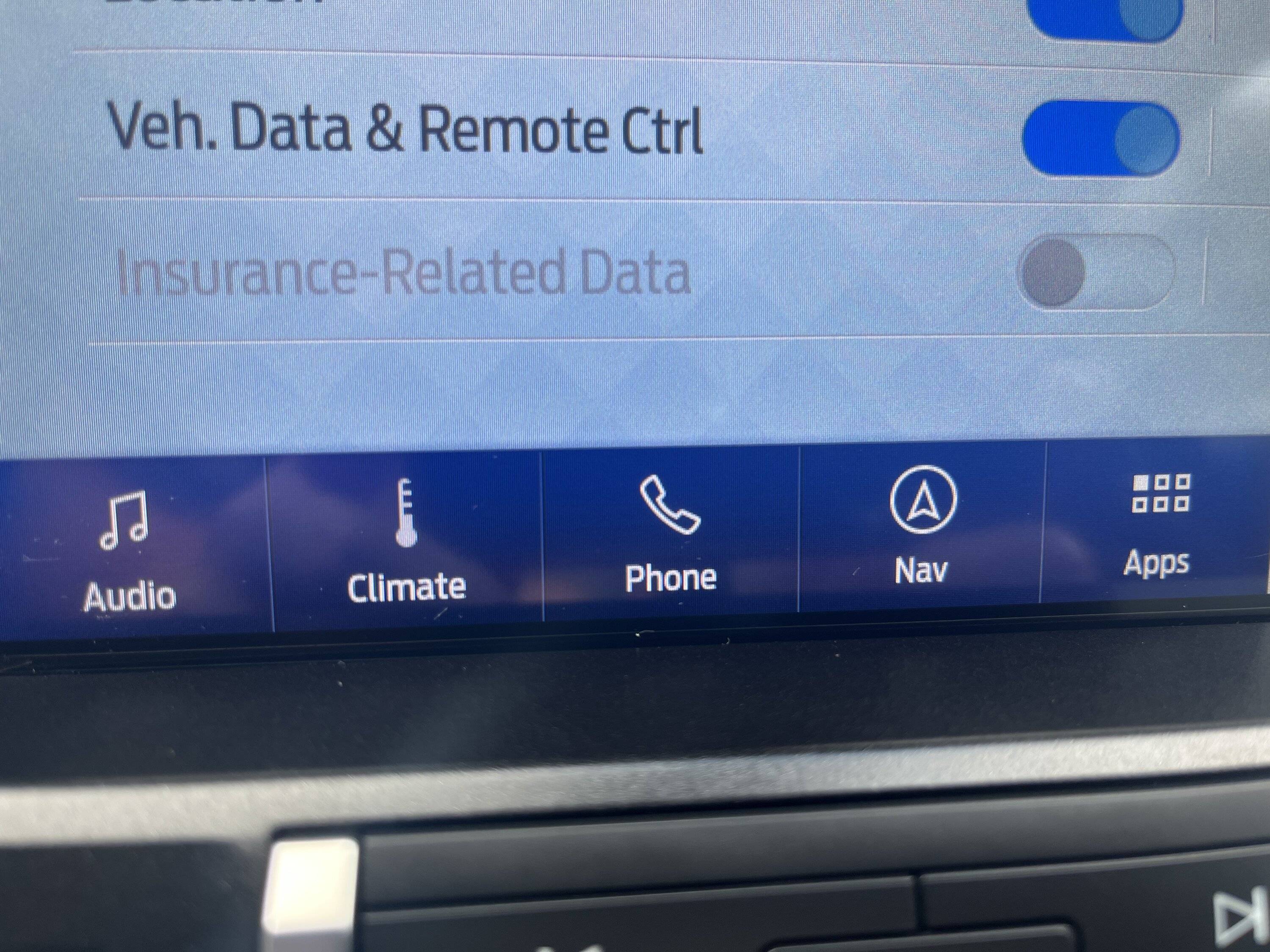

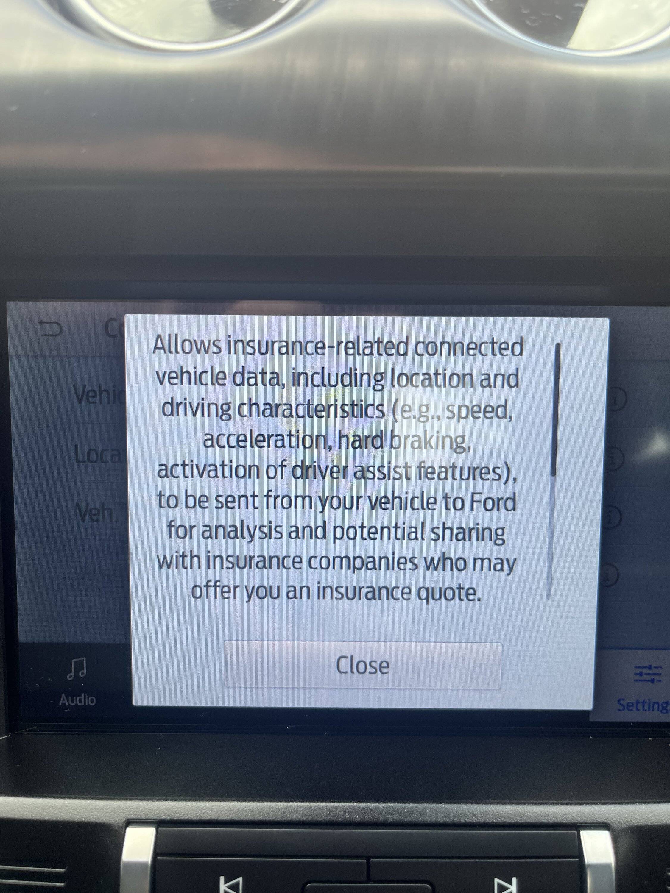

Just got done reading all of this. It looks like Ford partnered with Nationwide, our provider: https://developer.nationwide.com/case-studies/ford
Wifey got a new 2023 GT and is for whatever reason, STOKED about unlocking via cell phone. :facepalm:
Does this delete option have anything to do with this sitch?
It sounds like she needs to call in and opt-out, delete the app and any data, and I need to toggle those setting off in the vehicle if they are present, and possibly do a Sync master reset? Additionally, removal of fuse #8 in my case would be added insurance? If this keeps the Nav map working as well as Pandora via my phone over BT, then that would be sweet! Will see what I can get into this eve. I saw the post about Job 2 connections in the trunk, but figured I'd follow these other 2 steps first.
Thanks to all who have contributed!

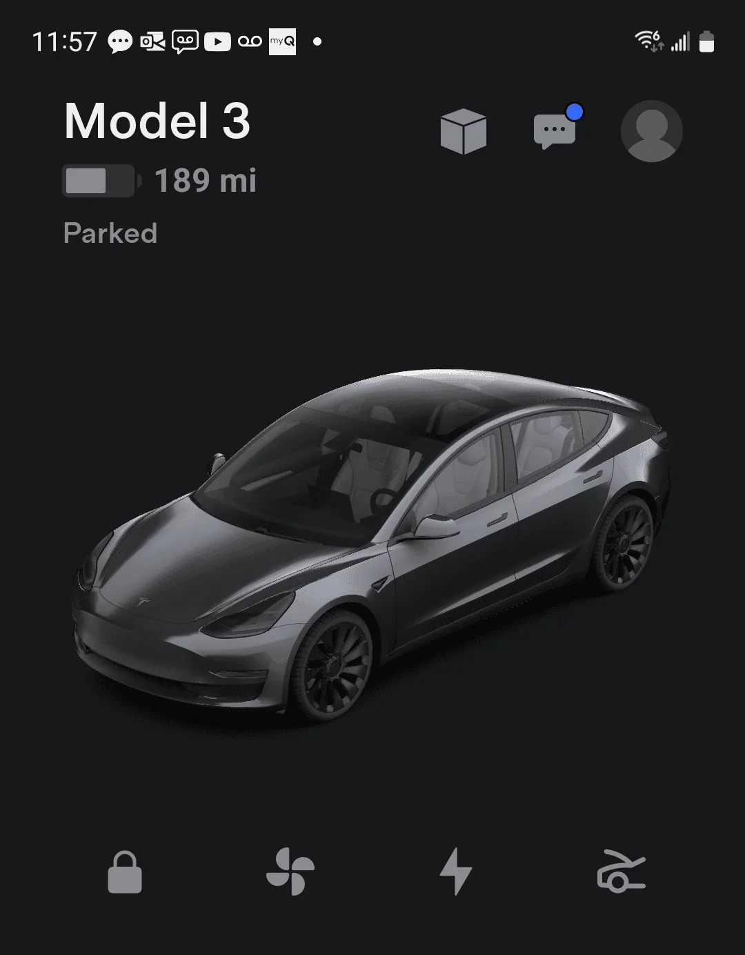

Posting a datapoint from another brand.
I was home and opened my Tesla app to check cost per mile while Susan happened to be driving the car. The app main screen always shows a picture of the car (see below).
I was surprised to see an image of a road passing under the car along with current speed, current location (address or cross streets) and even interior temp and what she was listening to. When she parked, it showed the door opening and closing as well as the trunk when it opened and closed.
I would not be surprised if all automakers are or will be doing that to the extent they have sensors for things like doors opening, etc.. Tesla swears none of it is retained, but obviously no way to verify.
There are some advantages to muddy the cost/benefit. For example, the little fan shaped "button" turns on the AC/heat to programmed temp (or lets you change that). Can't deny that having the car waiting at 72 instead of 130 in AZ summer has its charm.

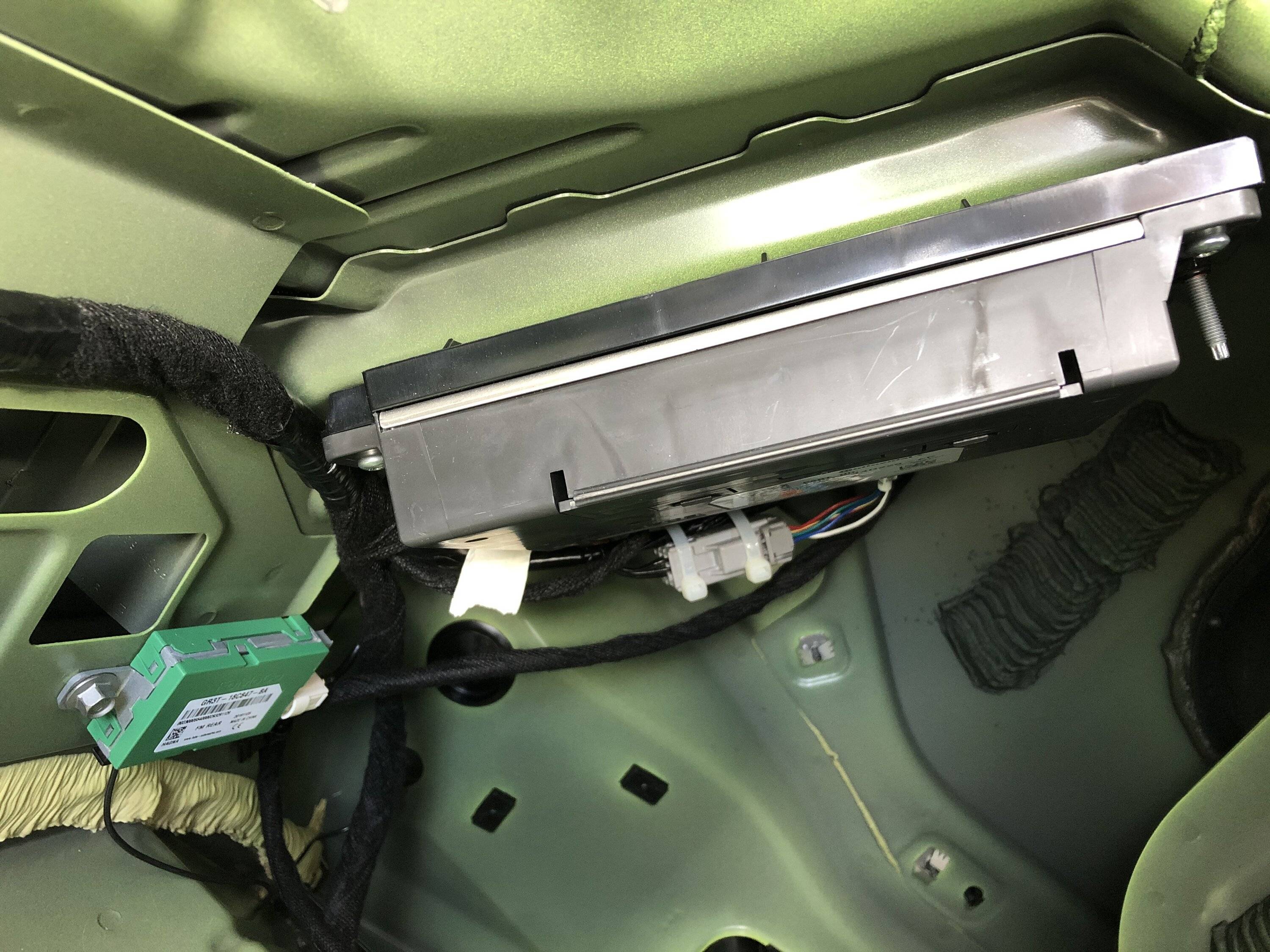

Just to be clear, the TCU module is in the trunk, behind the trunk liner, above the Right rear wheel?

From what I remember reading in other posts, it might be closer to the Left rear lights.

Yes, near the left tail light behind the liner. I believe I posted photos a while back.
I took this when I put sequencers on my taillights (the plug with the two cable ties) :
To help with orientation, the angled form with the two inserts in the bottom right of that photo is the area where the rear bumper and fender meet on the left side of the car :like:
