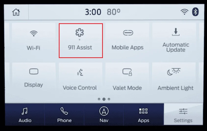

I'm not talking about disabling data transmission to Ford via the TCU, which makes the subject of this thread. I'm talking about a separate option, which is specifically about emergency calling. It's an independent tile on the Sync 3 main settings screen.
Edit: I've found a photo.
In EU vehicles it's called "Emergency Assist" rather than "911 assist". And of course, it dials 112 instead of 911. But it's the same thing. It's completely independent of FordPass Connect and the TCU, and has been present long before the TCU was introduced.
You can turn it off, and it will stay off.

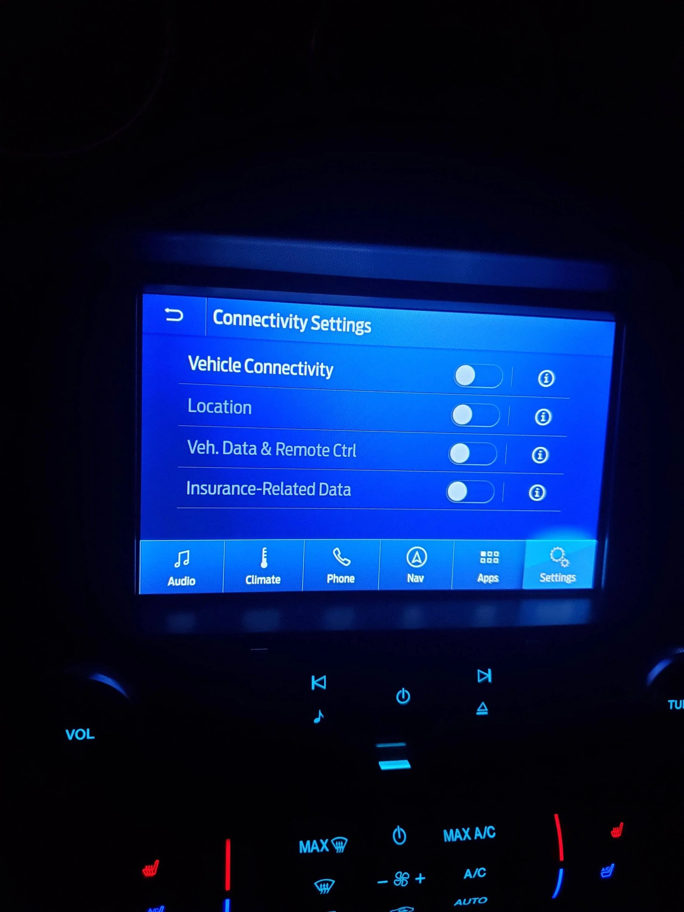

I wanted to check the TCU status (the "modem") when all the connectivity options are disabled in Sync:
Here what I can see from ForScan: the TCU is not connected to any GMS network.
So for the sake of data transmission it's just sufficient to toggle the "Vehicle connectivity" switch to have the TCU stop any transmission.
Probably Ford for legal reasons need you to acknowledge this transmission, and without your consent or some "moral suasion" from your dealer cannot oblige you to connect to the mobile network (my dealer tried to trick me in activating the FordPass).
I wanted to investigate the TCU_AUTHSTATE flag and I can tell it changes from "Wait For Authorize" to "Authorized Mode" when activated in FordPass.
The 222 Country Code equals to Italy and the 10 Network Identity is Omnitel.
As you already know you gain some more options in Sync once activated.
The system fully comes back to "Wait to Authorize" if you remove the vehicle from FordPass and disconnects from the GSM network if you flip the "Vehicle connectivity" back to OFF.
Mine will be staying off and I know that my data are not shared now that I have hard evidence that the car is not connecting to a mobile network without my consent.
I understand those of you who wants to physically disconnect the modules or the antennas but for me it's overkill.

Our screens look different. I wonder if it still applies
No, it is not.
If you re-read my post you will see that what you posted is the screen AFTER FordPass is activated.
To fully come back to de-authorized in the TCU you must:
  1. Remove your vehicle from FordPass
  2. Do a Master Reset
  3. Now you will get the "simplified screen" with just two options. At this time the the TCU is de-authorized.
    1. If you want the car to stop connecting to the GSM network altogether, toggle the "Vehicle connectivity" switch to OFF from the simplified screen.
  4. If you want you can delete your FordPass account (and App), it's completely useless now.

No, it is not.
Ohh ok, my bad. I will delete the app today & try again. Thank you!
