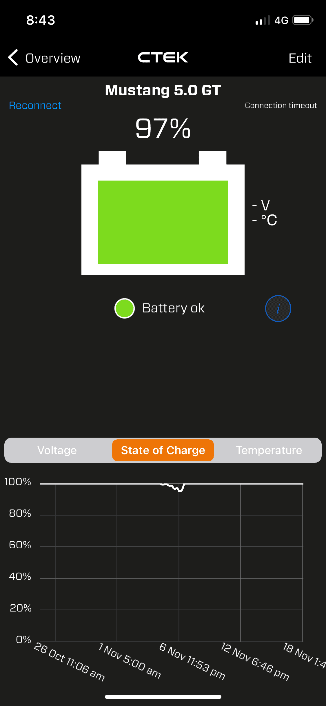

Believe me, I will and will also know the answer. With regard to the amount of the 100% charge is maintained,14 days later. After the trickle charging takes effect.
No, it's not rocket science, you just might be misinformed about the charger's capabilities.
VVVV Reads like the CTEK charger VVVVV

My CTEK will keep it at 100% no problem :

When I have some data collected, will be back. Not interested in anecdotal trickle charger assumptions. Measured fact-based is all good, still to be determined.

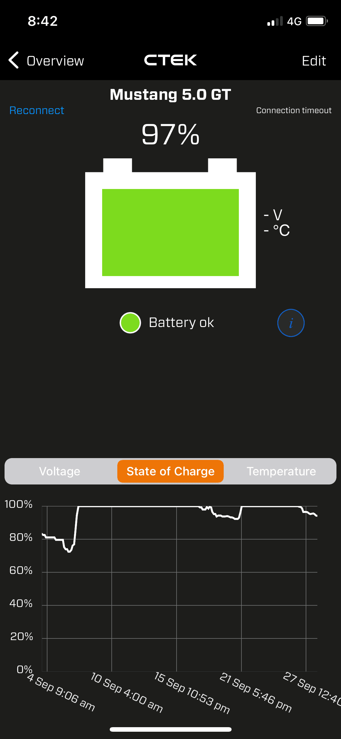

If I don't admit my mistakes I lose credibility. I store the charger on the top of the front tire, under a car cover.
Long story short
I remembered that I had not seen the #4 battery led green. When I pulled it from the top of the tire. Installing the monitor, only the A (pwr) mode led lit.
Which started the whole mess. Using the charger for 2 years. Know to switch the charger to normal.
I assume and is all I can do, the extension cord plug is/was intermittent.
Today pulled the charger off the tire and the #4 green led is lit, all is well.
