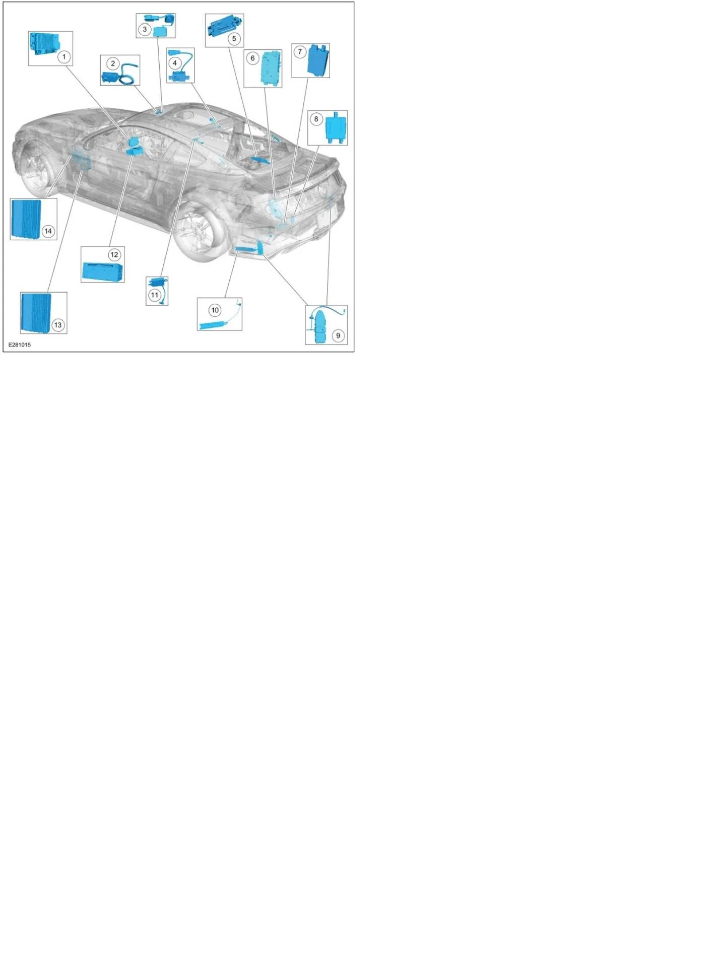

Here is a post from another thread. I've included it here for reference.
The way I see it is that you disconnect the antennas to the TCU or remove the sim card. The description says the sim card is not serviceable, so if the TCU is a sealed unit, then it will have to be done through the antenna inputs. Based upon the info from the chairman, that document says that the primary means of communication for the TCU is through the GPS/satellite antenna (which explains why the job 2 antennas were updated. I have job 1 antennas on my GT350s, and have never had a satellite or GPS reception issue. But then the document goes on to say that the TCU also uses cellular antennas. So it seems that you have multiple redundancies for data connectivity. You'd have to disconnect all antenna input to the TCU to keep from receiving data. As stated, I'm sure that this will trigger all kinds of alerts and codes. I'm not a Forscan expert, but some here are. I hope they look into this and can narrow the parameters down for manipulation.
The TCU is nothing but a cell phone. How would you be able to disconnect the device from the network? I would look into removing the SIM. I will have to find out how non-serviceable the TCU really is.
From the document:
Vehicle Wi-Fi Hotspot (if equipped)
The TCU provides the vehicle Wi-Fi access point. The TCU communicates to the cellular network by two means. The primary connection is through the cable to the cellular antenna incorporated into the GPS/Satellite antenna. The secondary means is through the cable to the TCU antenna.
TCU Antenna The TCU antenna is used to boost reception for incoming and outgoing cellular network data. It is a compact, cellular phone type, planar inverted-F antenna.
Cellular Antennas Two cellular antennas are used. The LH and RH antennas are positioned between the respective quarter panel and the rear bumper cover. They receive the radio waves containing cellular data. The signals are sent through the cellular antenna coaxial cables to a splitter (or combiner) and then to the TCU.
TCU The TCU is a radio transceiver which connects the vehicle to a cellular network. It is connected to the CAN for exchanging data and commands with other modules. It contains a non-serviceable SIM card. The TCU is assigned to the VIN of the vehicle and will not work in another vehicle. The TCU requires PMI when it is replaced.
Item 5: TCU antenna
Item 6: TCU
Item 8: Cellular antenna splitter
Item 9: Cellular antenna

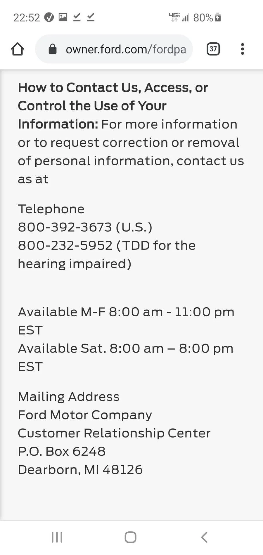

I just got off the phone with Ford. The paranoia is true. I was informed that they do indeed share data with insurance companies. She didnt understand my concern. She said most people want it so that they can get insurance discounts for safe driving. I calmly and politely explained that this is the GT500, A high performance, 760 horsepower sports car that nobody, and I mean nobody would want their data being shared with an insurance company. She opted me out of all the data sharing.
Next I asked about disabling the data link. She asked why I would want to do that. I told her that there is a publication out that states for me to call to accomplish this. I wish to accomplish this.
I was transfered to "in vehicle technology" and was informed that this cannot be done. It is integral to the car and it will always record and report data. I said I don't want my car to record and report data. He suggested I bring it into a dealership and see what the service department could do. I said, well how about I pull the 5 amp fuse that powers the TCU? "but sir... why would you want to do that" and "I cannot recommend you do that"
Folks, this is no bullshit. They are monitoring your driving, position, speeds, parameters, etc and if you have not opted out, they are collecting and sharing your data. If you opt out, they are not supposed to share the data, but Ford will always be collecting and storing your data.
I will pull my fuse. I hope that someone will be able to verify that this feature built into our cars is disabled by doing this.

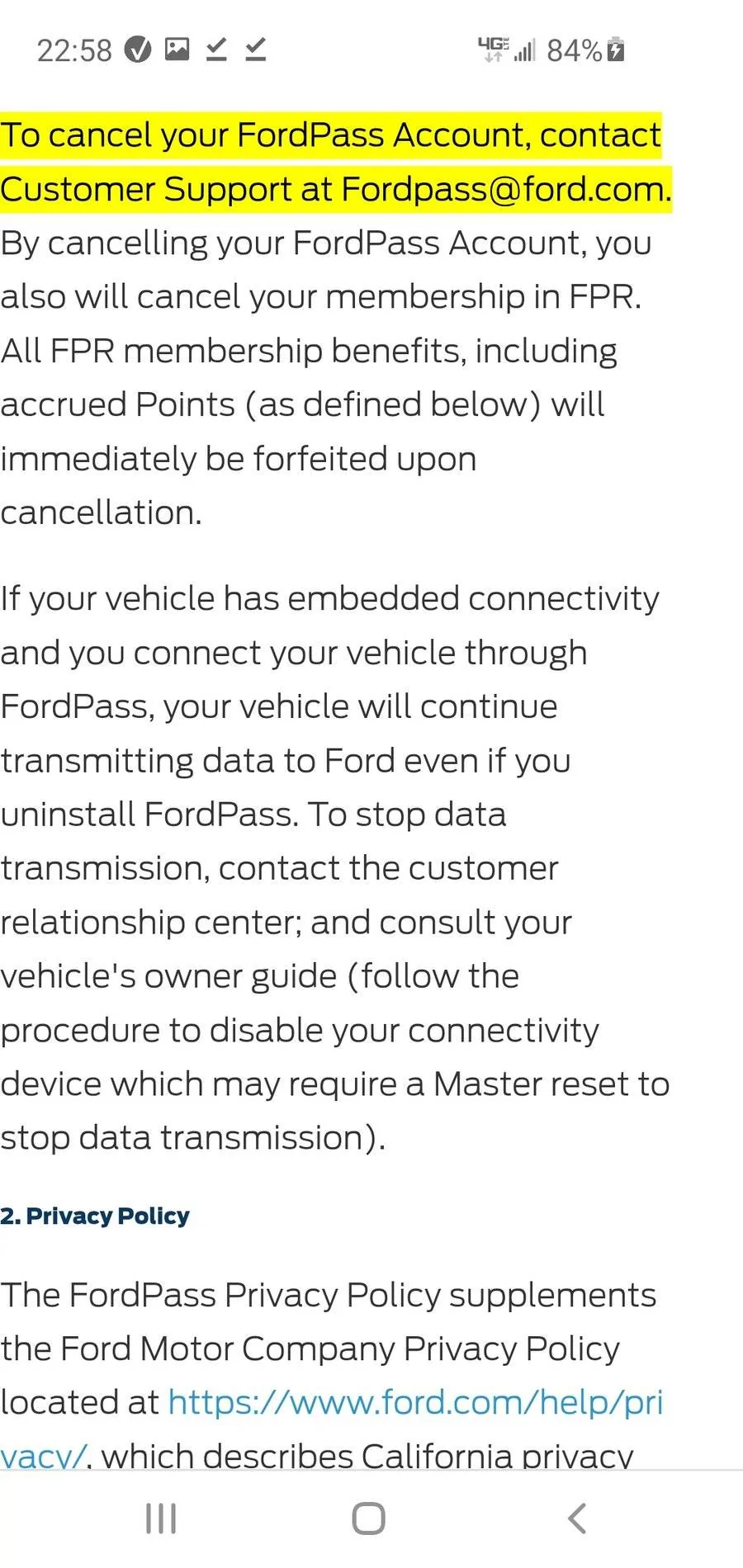

This is a three step process.
First call (800) 392-3673. At the prompt say "Ford Pass". You will be connected to a Ford Pass representative.
Second, call the same number, At the prompt say "In vehicle technology team". The next prompts are 1 followed by 2.
Third, pull the damn fuse for the TCU
Step 2 isn't going to do you any good because they will not help you disable the data link. At the very least, you should accomplish a master reset to wipe any preferences that are in Ford Pass so that data isn't accidentally shared.
