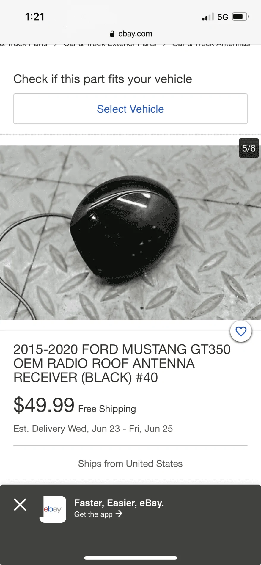

Hi folks,
Crazy thread! So I made it through 18 pages. :-)
My goal is to wrap my white roof black, and I have a goofy shark fin. I’m also not interested in BigBrother watching over me. From what I understand, I can buy this used eBay black puck and use it, after swapping the shark fin connector? Simple as that right? :-)
Thanks!
Oh, I’m a 2020 GT Prem if that matters.
https://www.ebay.com/itm/293811698769

Yes, it is that simple. Read my other thread on the subject matter, and no, not a crazy thread..... very real.

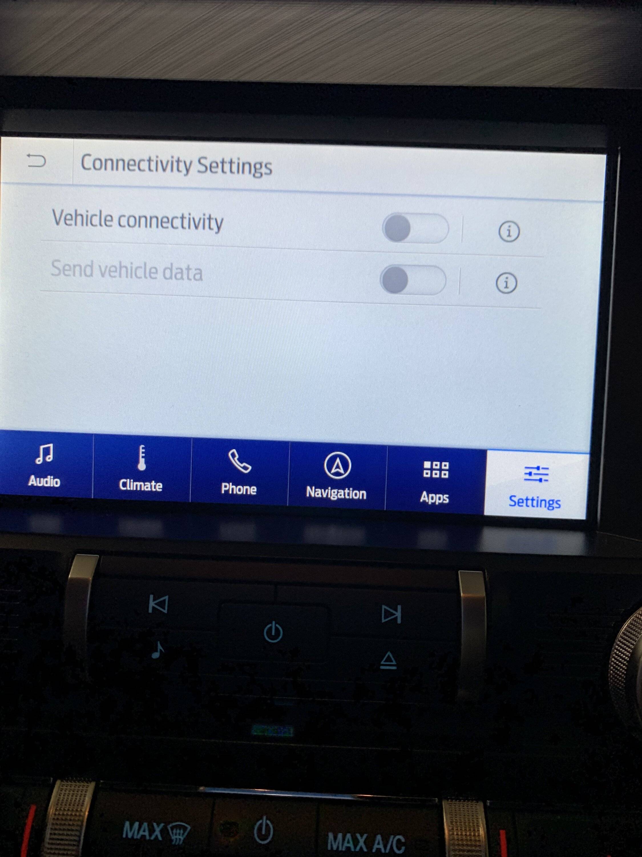

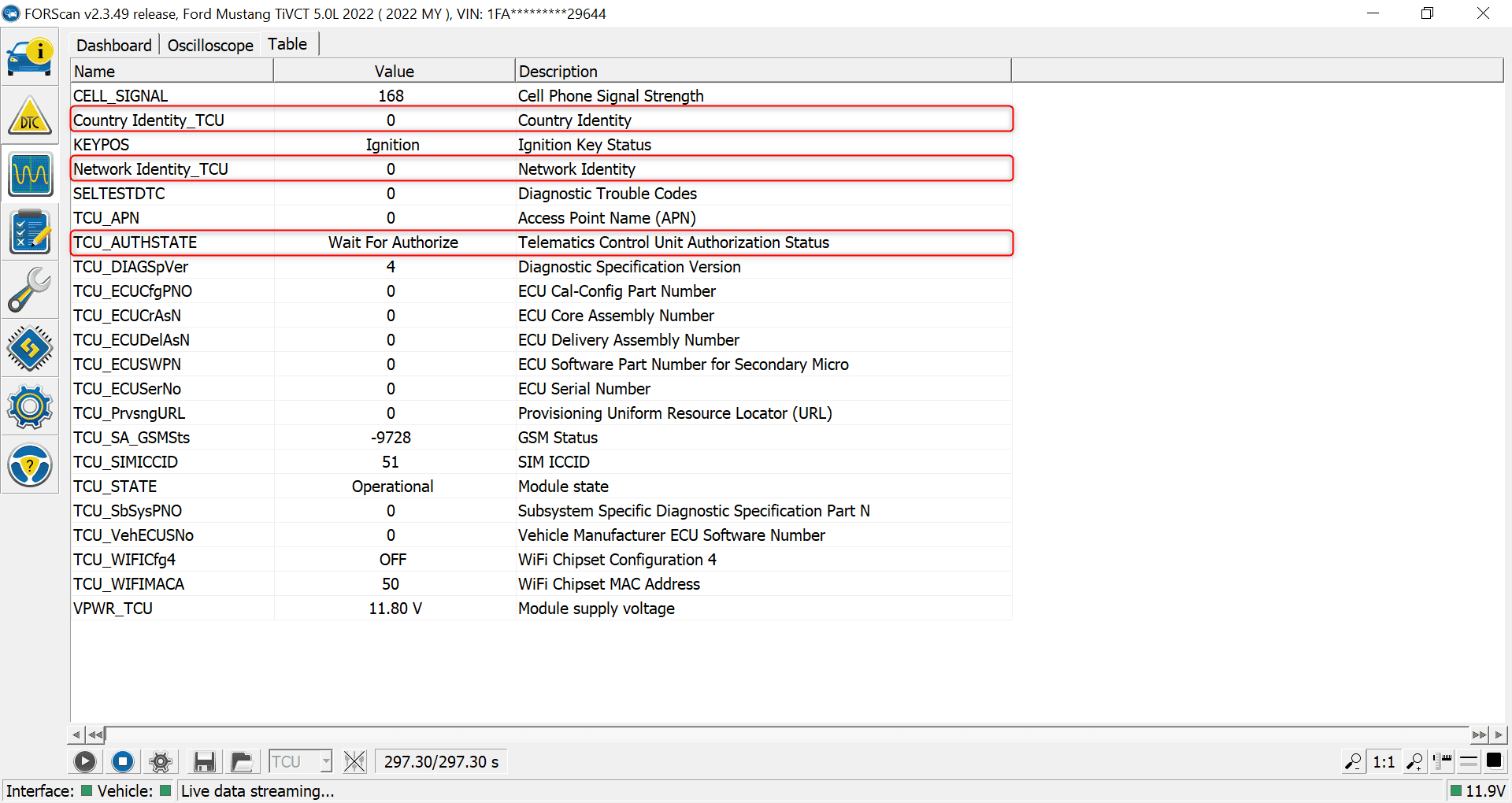

I wanted to check the TCU status (the "modem") when all the connectivity options are disabled in Sync:
Here what I can see from ForScan: the TCU is not connected to any GMS network.
So for the sake of data transmission it's just sufficient to toggle the "Vehicle connectivity" switch to have the TCU stop any transmission.
Probably Ford for legal reasons need you to acknowledge this transmission, and without your consent or some "moral suasion" from your dealer cannot oblige you to connect to the mobile network (my dealer tried to trick me in activating the FordPass).

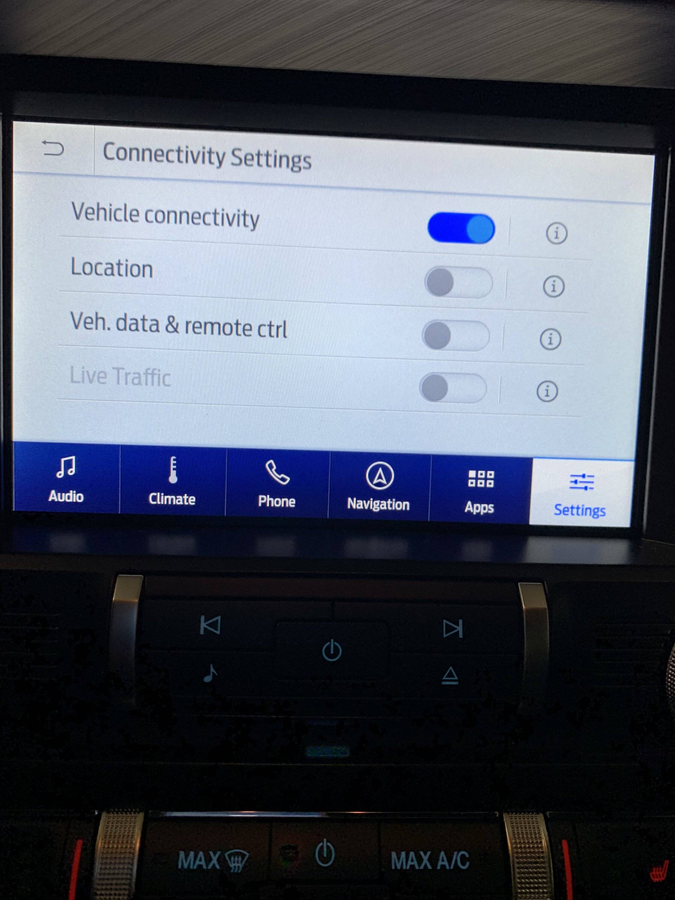

I wanted to investigate the TCU_AUTHSTATE flag and I can tell it changes from "Wait For Authorize" to "Authorized Mode" when activated in FordPass.
The 222 Country Code equals to Italy and the 10 Network Identity is Omnitel.
As you already know you gain some more options in Sync once activated.
The system fully comes back to "Wait to Authorize" if you remove the vehicle from FordPass and disconnects from the GSM network if you flip the "Vehicle connectivity" back to OFF.
Mine will be staying off and I know that my data are not shared now that I have hard evidence that the car is not connecting to a mobile network without my consent.

I have to make some more testing, yesterday was a bit in a hurry, but I have to check if a Master Reset does something different.
Because Ford Europe mentions it's mandatory if you want to fully deauthorize.
Anyway,
  1. Remove car from FordPass
  2. Master Reset
  3. Ensure toggles are ALL OFF
Is all you want done.
If you have ForScan you can verify by reading the TCU status. Never trust, always verify, especially things that are invisible.
