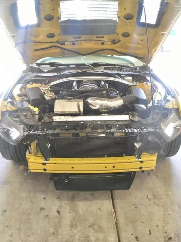

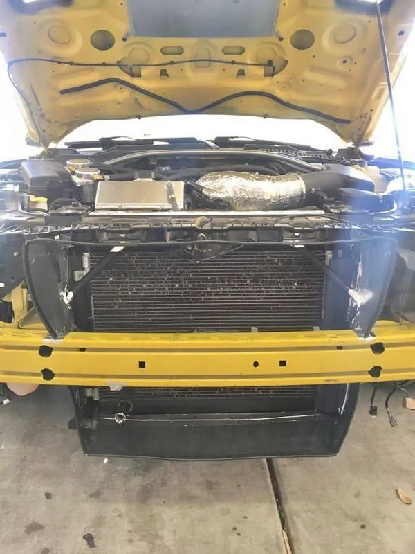

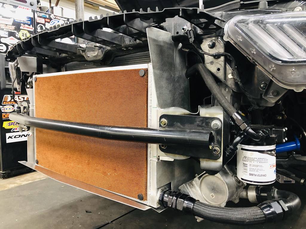

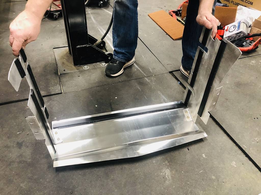

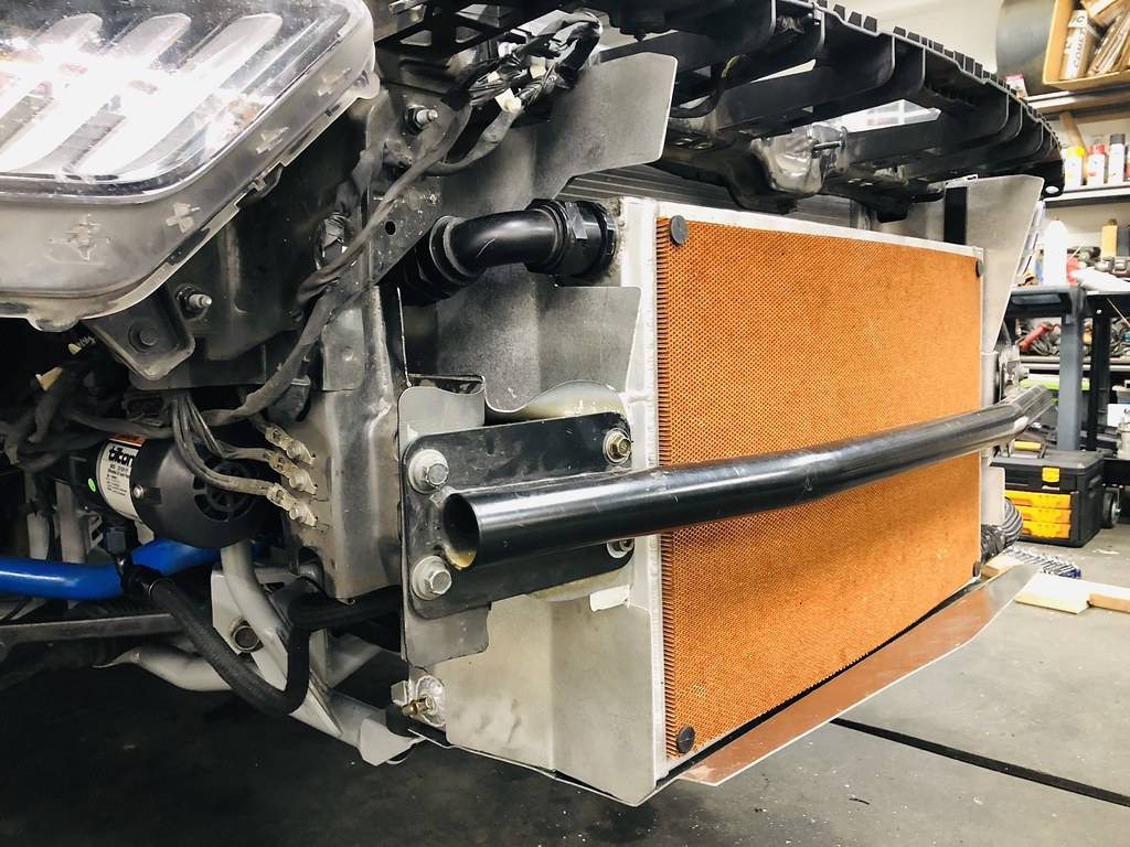

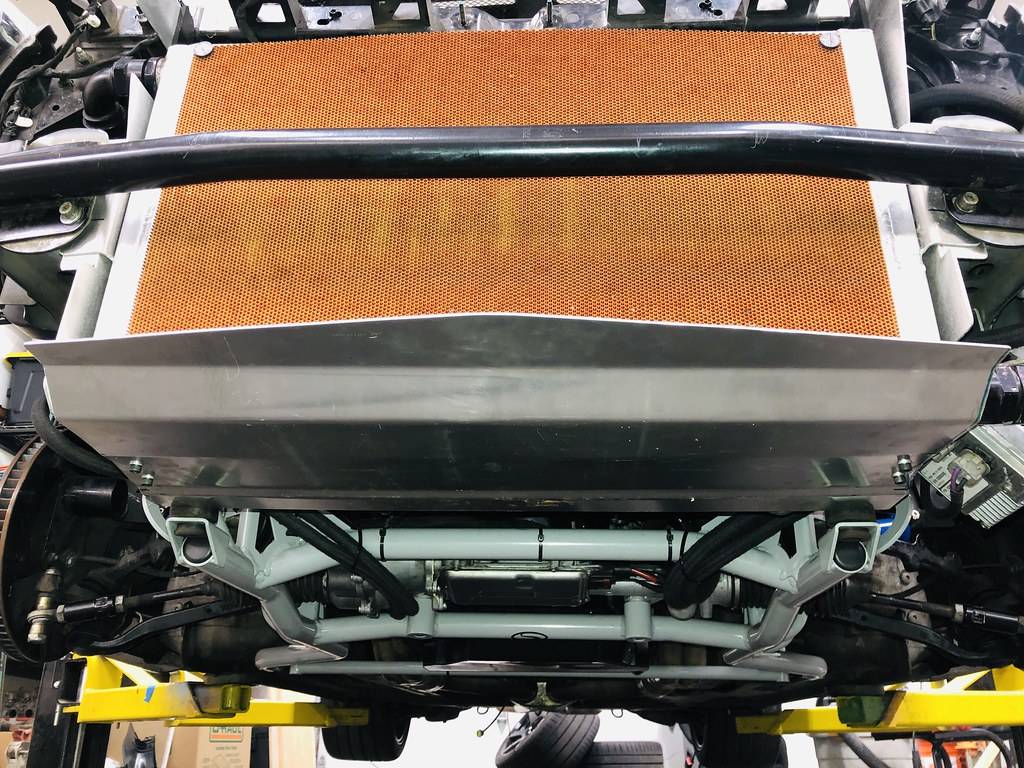

i did this over the offseason. bumper is modular and can be removed without needing to take the ducting off:
unfortunately it's highly customized (a very capable friend built it for me), and required a brake press, TIG welder and water jet to fabricate, and i have a lot of plumbing and non-OEM parts up front, so measurements wouldn't be very useful. but after going hard for 20 minutes at a time this past weekend in thunderhill, the temps i saw (oil 220s, cht 210s, trans < 200) made me realize it was worth it!!

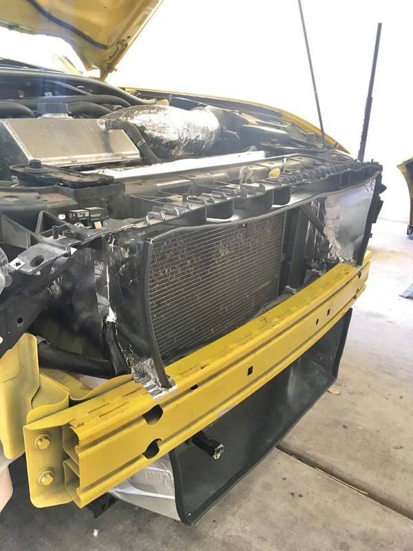

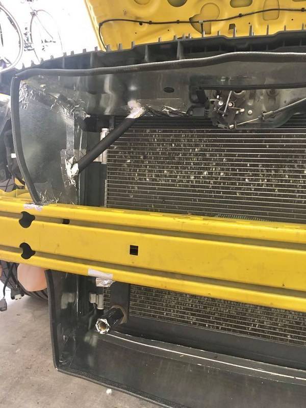

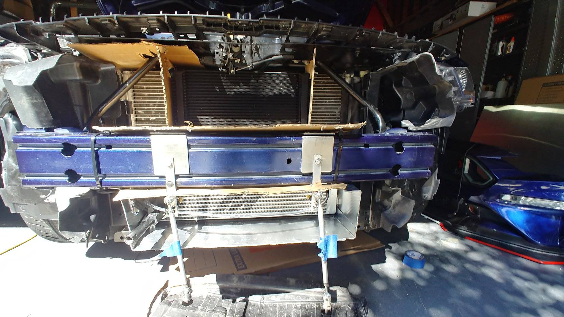

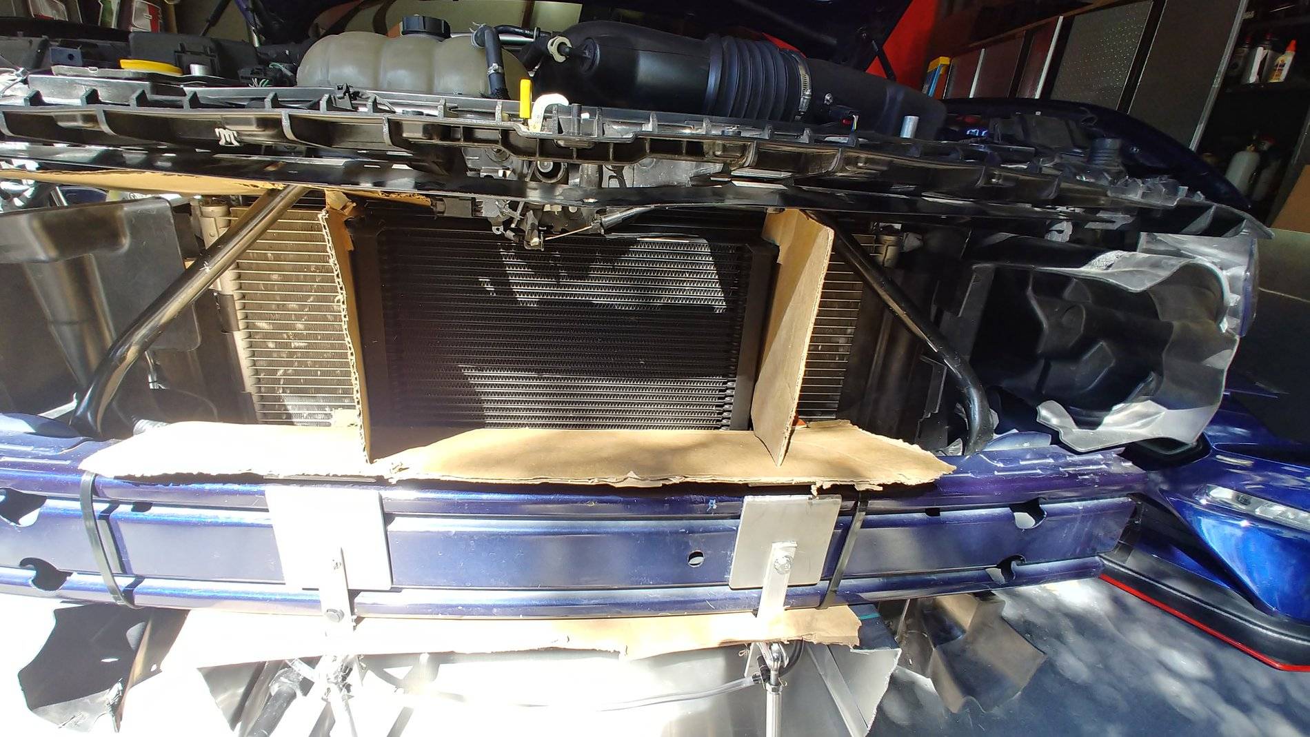

SOME PICS for my ducting. all created with Cardboard box. first time I do somenthing like that. it is not difficult .It is time consuming. I sealed the AC and Radiator Gap in the bottom with...gorilla tape.Also used some on the side :) After 4 days is still there

@boardkat Pardon my ignorance, what benefit does the orange honeycomb stuff in front of the radiator bring?
Protects my very custom and very expensive heat exchanger from damage :)

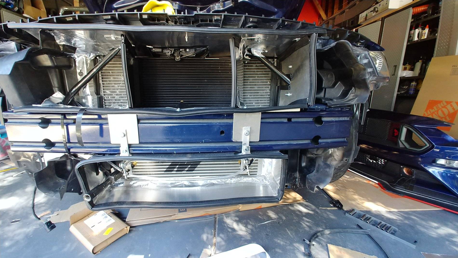

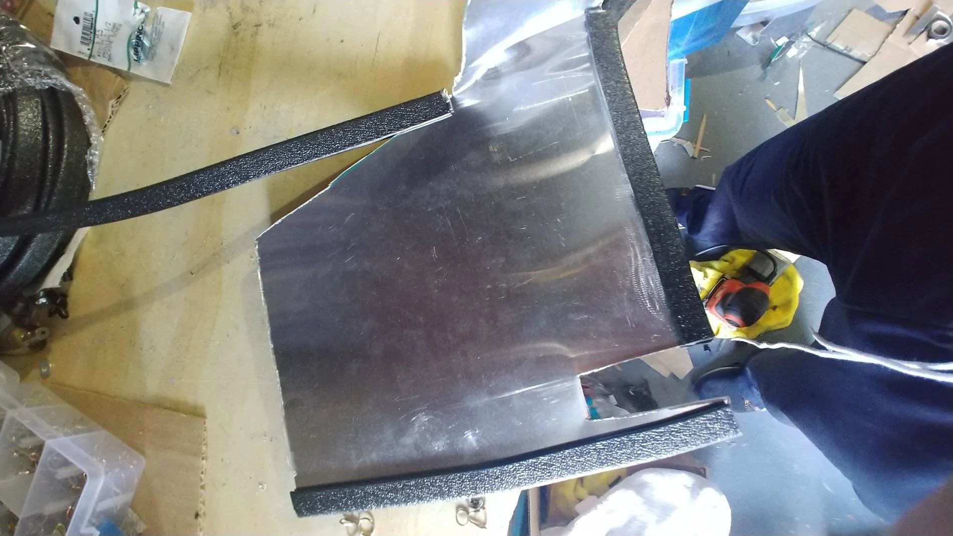

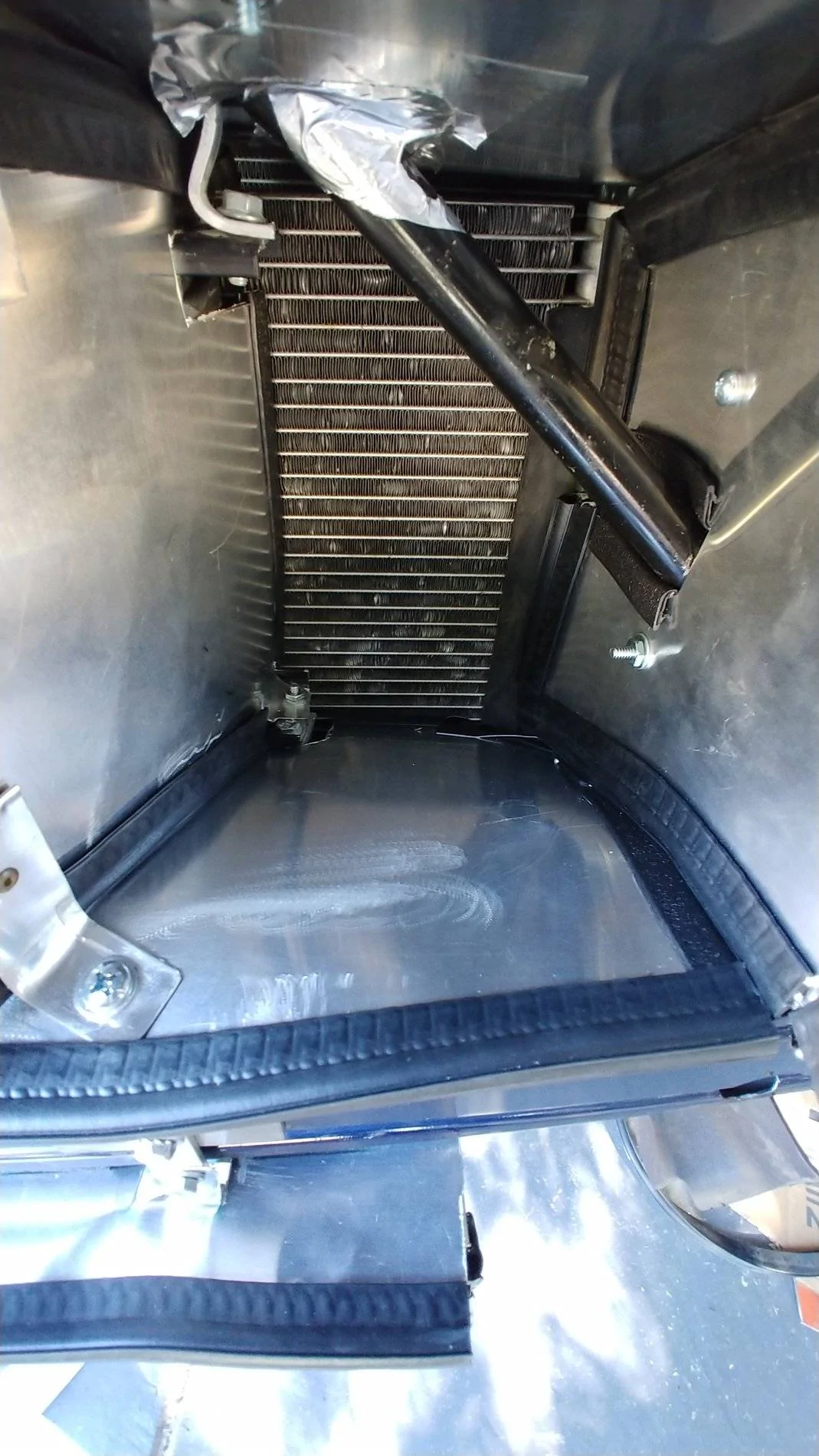

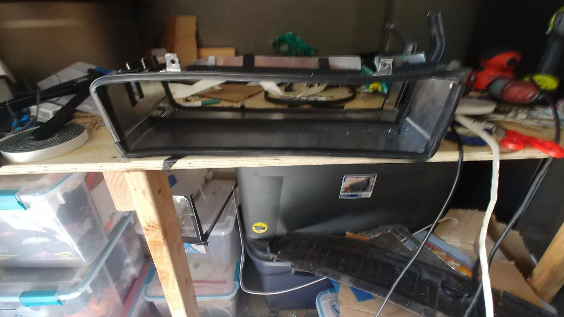

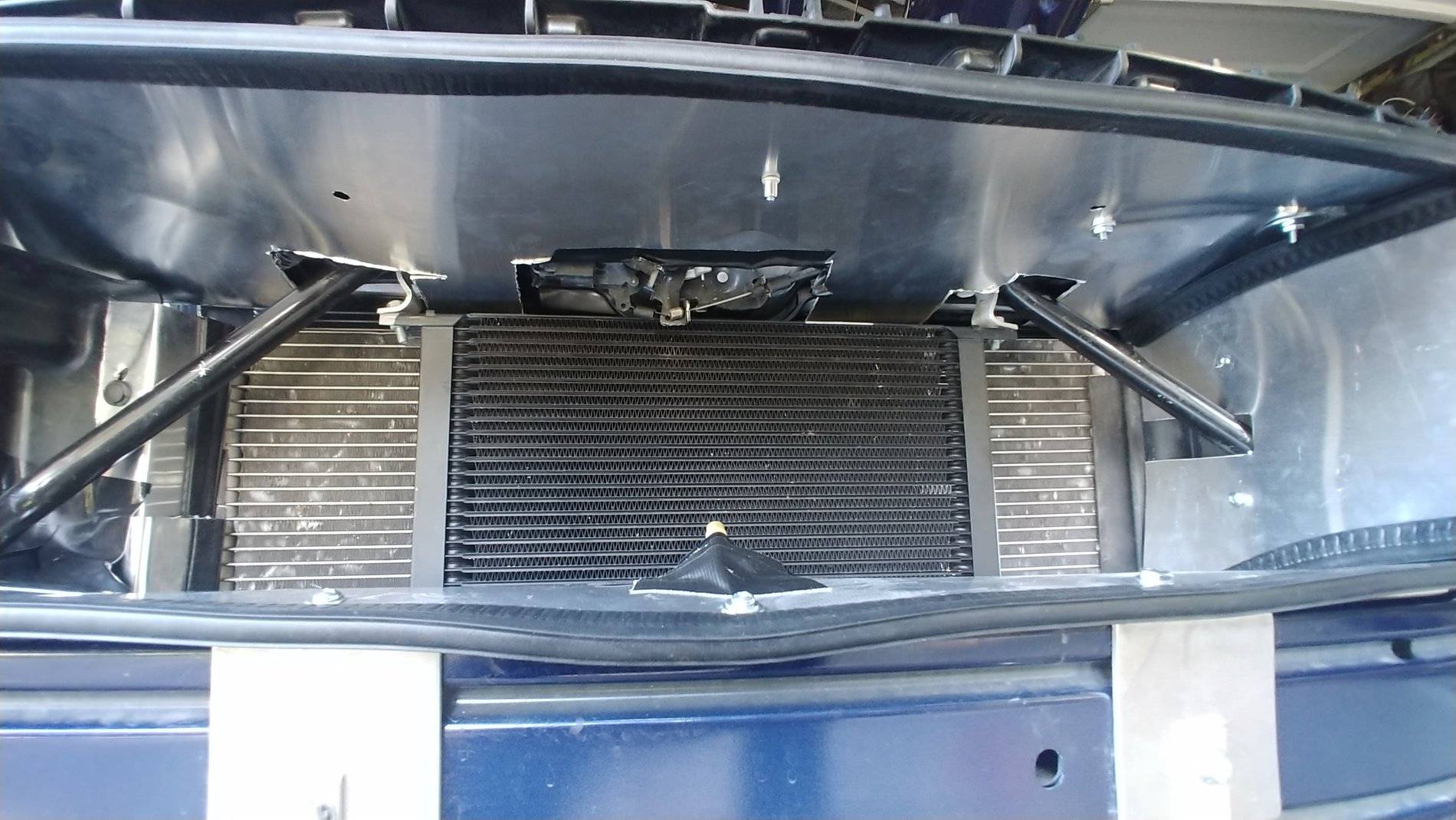

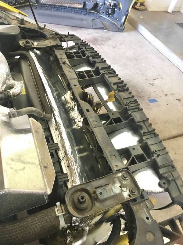

Finally made time to take on this project. I went in thinking it would be a fairly trivial task, but came to find out with the stock setup, there are quite a few things that need to be worked around especially considering I wanted the box to be completely sealed to the radiator. Spent about 2 full days on the project designing prototypes on cardboard, then cutting things out, test fitting on/off then readjusting/cutting things a gazillion times. Certainly required a lot of patience and persistence. There was a time or two I thought I had lost a finger, these HVAC sheets are a PITA to handle carefully.
Materials (Spent about $70 bucks):
(3) 24in by 3 ft HVAC steel sheets
Trim-lok Edge Trim
Ton of foil tape
