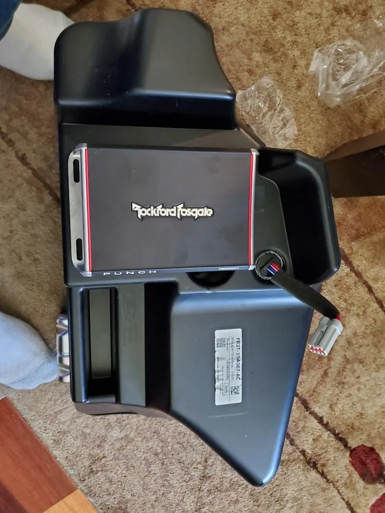

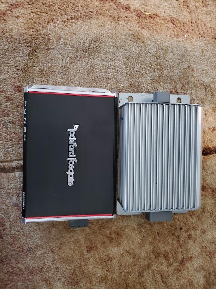

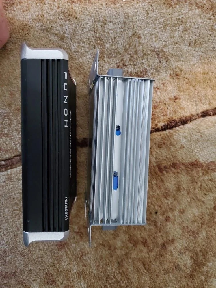

So I took some stuff apart, and found something interesting. For those that hate visible mods, the Rockford Fosgate PBR300X1 is about the same size as the stock sub amp.
See the mock up image. Just a thought if you, like me, hate amp racks, and want to go as stealth as possible.
Furthermore, this amp requires 30A fused power. The stock circuit is rated for 30A with a 30A fuse in the fuse box (fuse 5).
