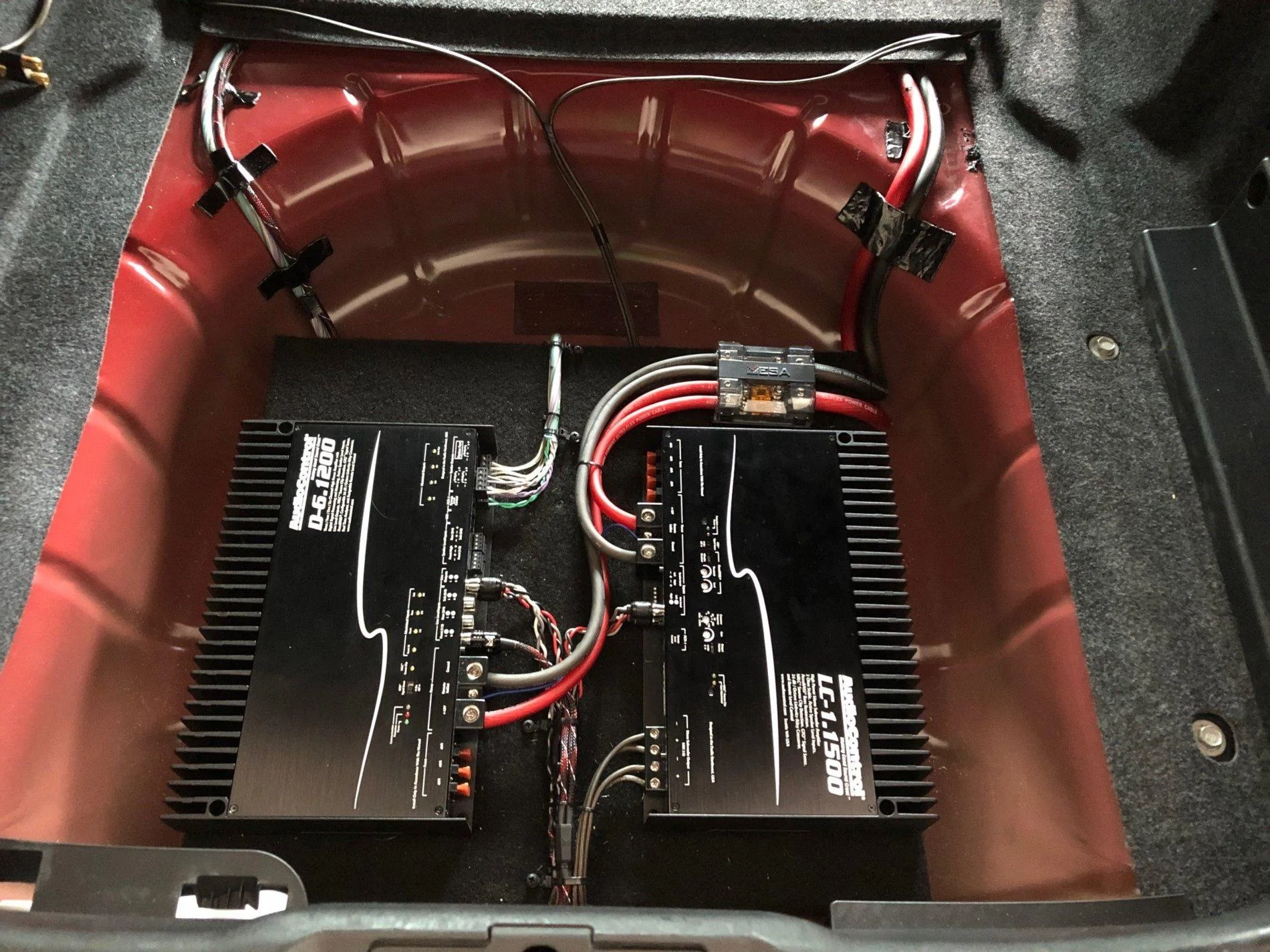

Had some car audio equipment installed by a local shop.
Factory head unit
Audio Control D-6.1200 powering front speakers
Hertz 3 way running active for all 6 speakers
Audio Control L-1-1500
JL Audio 12TW3 4 ohm speakers
Enclosure by Zenclosures.com

Nice!
How do you like it?It is very close to my setup.At the time the audio control was just getting released and not out to the public yet.
I used the Helix P-Six instead which cost a tad bit more,but there was not many choices when I did my system.
I do feel that a good clean powerful system needs the 125 watts per channel.I did try it on 75 watts a channel,but it was just not enough for me.Did the shop tune it for you also?And the bigger question is,do you hear any background hiss or noise.

I really like having the front running active. I don't hear any background noise. Yes the shop did the tuning, but I will be back to have them tune for more bass. I feel the front may overpower the bass.

You really ought to finesse the tune yourself. Sound is so subjective. They likely tuned for a very flat curve (as they should), but I’ve found the mustang needs more low end to compensate for the engine. It gets lost instantly when driving.

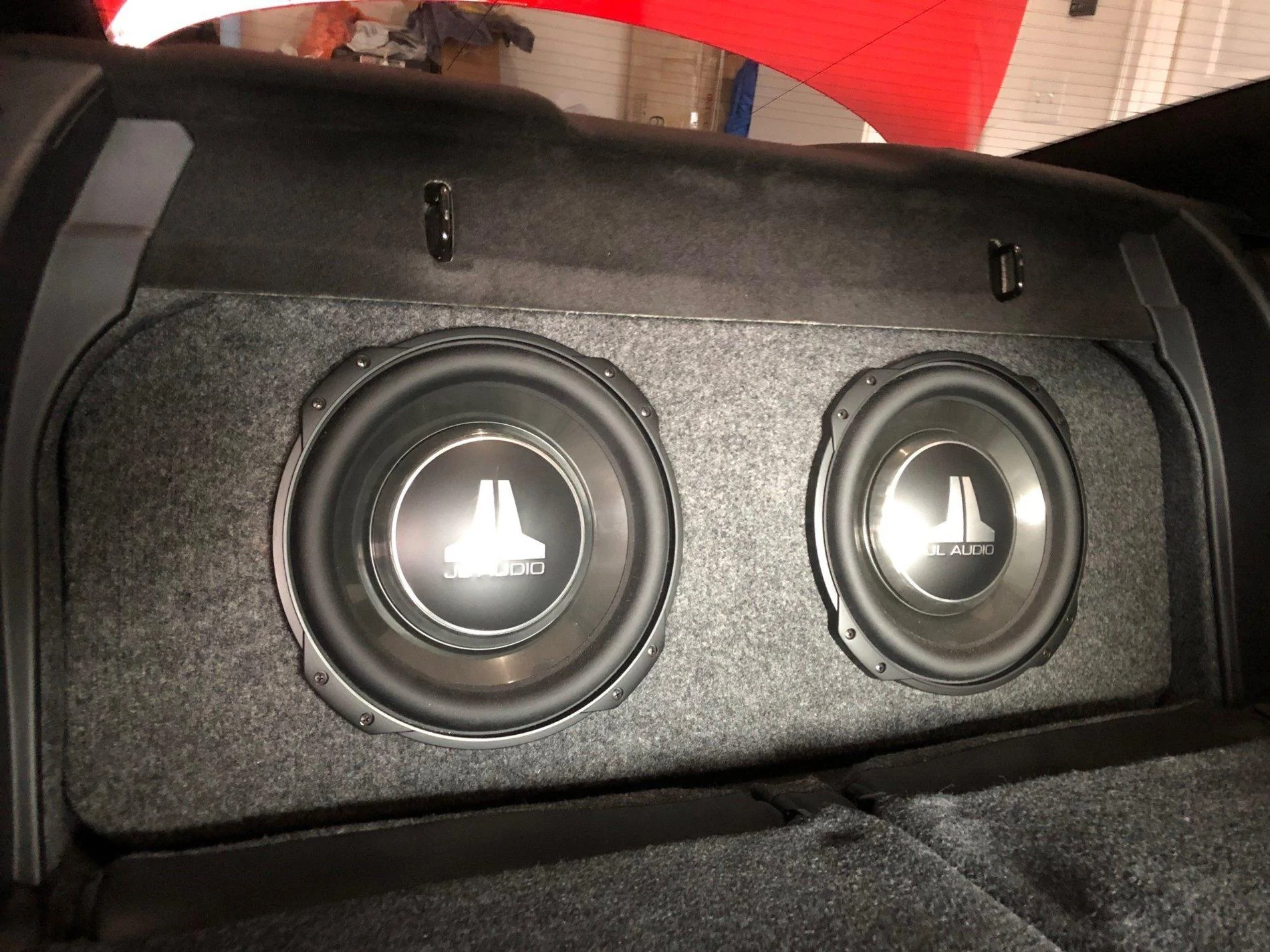

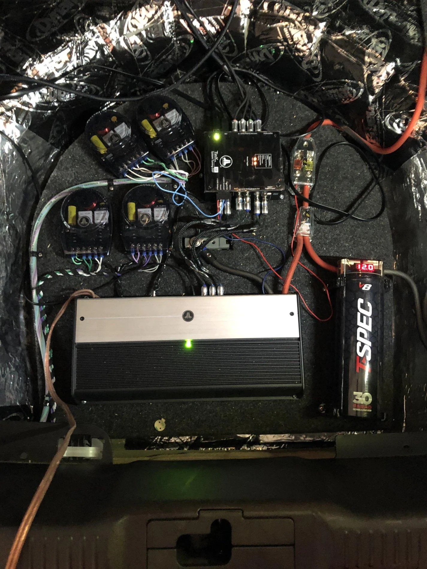

I started out with DSR1, had so many issues, damn thing was buggy and sounded marginal at best. Going to my best describe what I did.
Removed the factory amp and sub, shaker pro system.

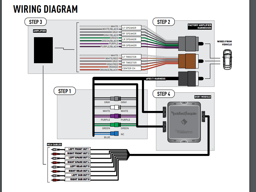

Sent back the DSR1 and kept the aF03 T-Harness, I cut the blue, green, grey, white and purple wires and soldered them to an 4 channel RCA cord, I cut off the ends on the one end. Used a piece of speedwire that I ran from the trunk and spliced into the brown and grey connectors for the adapter that connects to the factory speakers. Connected opposite end to amplifier outputs. Used the blue eire for my remote turn on. On the adapter I cut the rest of the wires off, no need for the black, brown or yellow wire just tape them up good so they don’t short out. Then plug in the aF03 harness into you cars wiring harness that went to your old amp, and the brown and grey adapters going to speakers. Keep in mind these wires only handle front doors and tweeters. Disconnected Mids in doors since mid/tweets on same line. 2 wires for tweets, 2 for door 6 inch, that 8 wires, blue is your remote.
Next I used the forscan app and flashed my radio with these codes.
727-01-01 xx5A xxxx xxxx
727-01-02 00xx
At this point you can plug right into your amp as low level inputs, sound same as DSR1 at this point, later I added a JL TWK-88 the sound went through the roof for me, there is absolutely endless control on your tuning now. I also dynamited the entire car, boy did that ever make a difference.
I think it sounds beautiful with my setup, there is no comparison to stock sound. Bottom line you can buy the harness, rca wire and a 12 foot piece of speedwire for 70-80 bucks, fill in everything else with whatever you like, below is a list of what I put in.
Hope this helps others.
AMP
https://www.jlaudio.com/xd1000-5v2-car-audio-xdv2-amplifiers-98258
DSP
https://www.jlaudio.com/twk-88-car-audio-processors-system-tuning-98101
Front
https://www.jlaudio.com/c5-650-car-audio-speakers-c5-speaker-systems-99104
Rear
https://www.jlaudio.com/c5-650x-car-audio-speakers-c5-coaxial-systems-99105
Sub
https://www.jlaudio.com/ho112-w6v3-car-audio-h-o-wedge-subwoofer-systems-93315

With the 6-speaker system the speakers are fed right from the ACM. So use a T-harness like the CARAV 12-240 and some Stinger speedwire to get the signal to your amp and back to the speaker wires right behind the ACM. This would be the easiest way to do it.
If you want to feed your midbass and tweeter with separate wires from the passive crossover, well, the A-pillar wiring doesn't have to go through the door, but you can still use the existing wiring for the midbass. So same principles apply. You can find lots of videos on youtube on how to work with a T-harness, like from 5star car audio.
