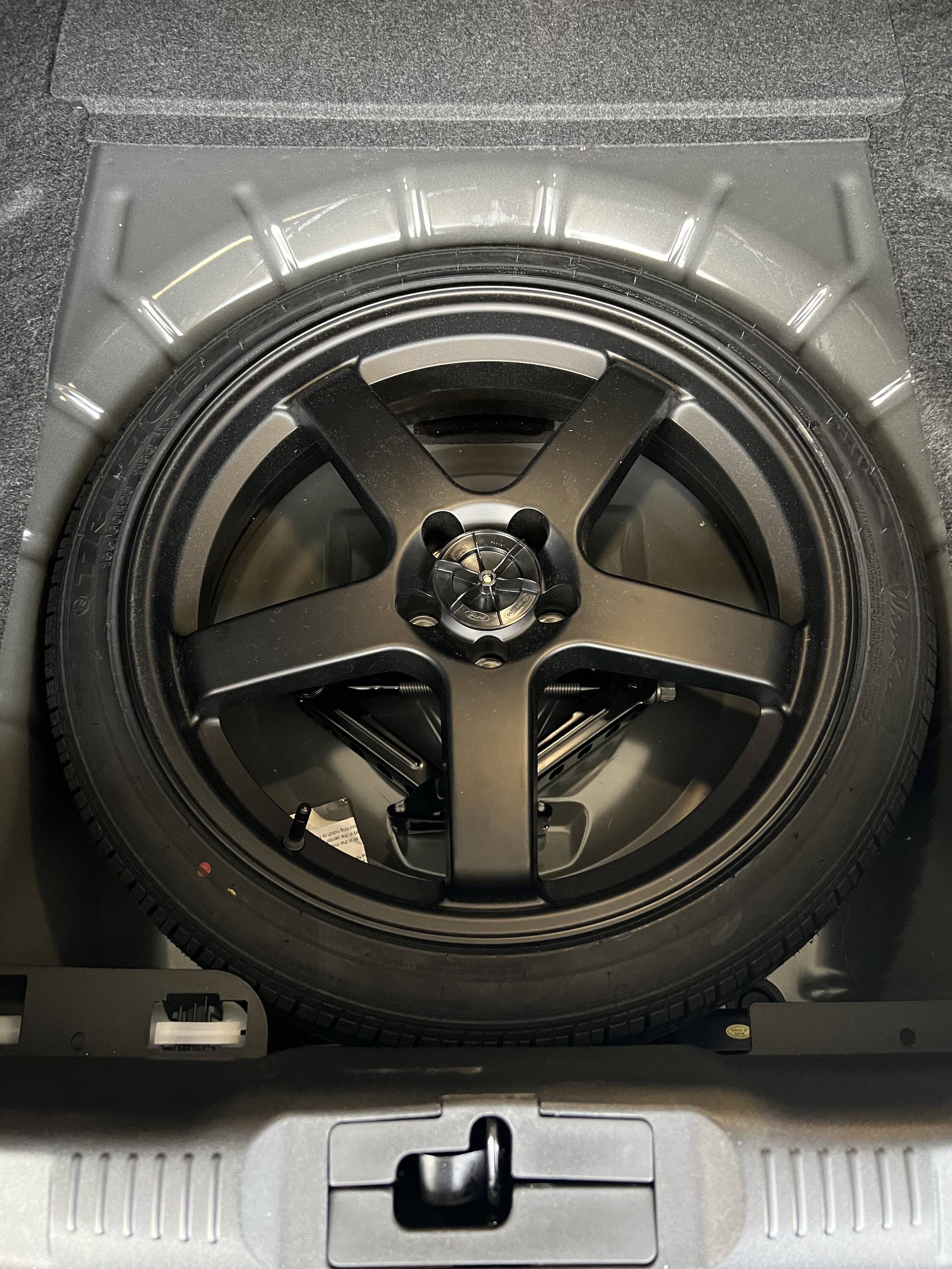

2023 Mach 1 10R80
The AA in my 2023 Mach 1.

+1 for the Automotive Authority spare. Fits well and actually a nice looking spare.
Another +1 for the AA spare here!
Fit is great, just like in @BlkMach10510's photo.
