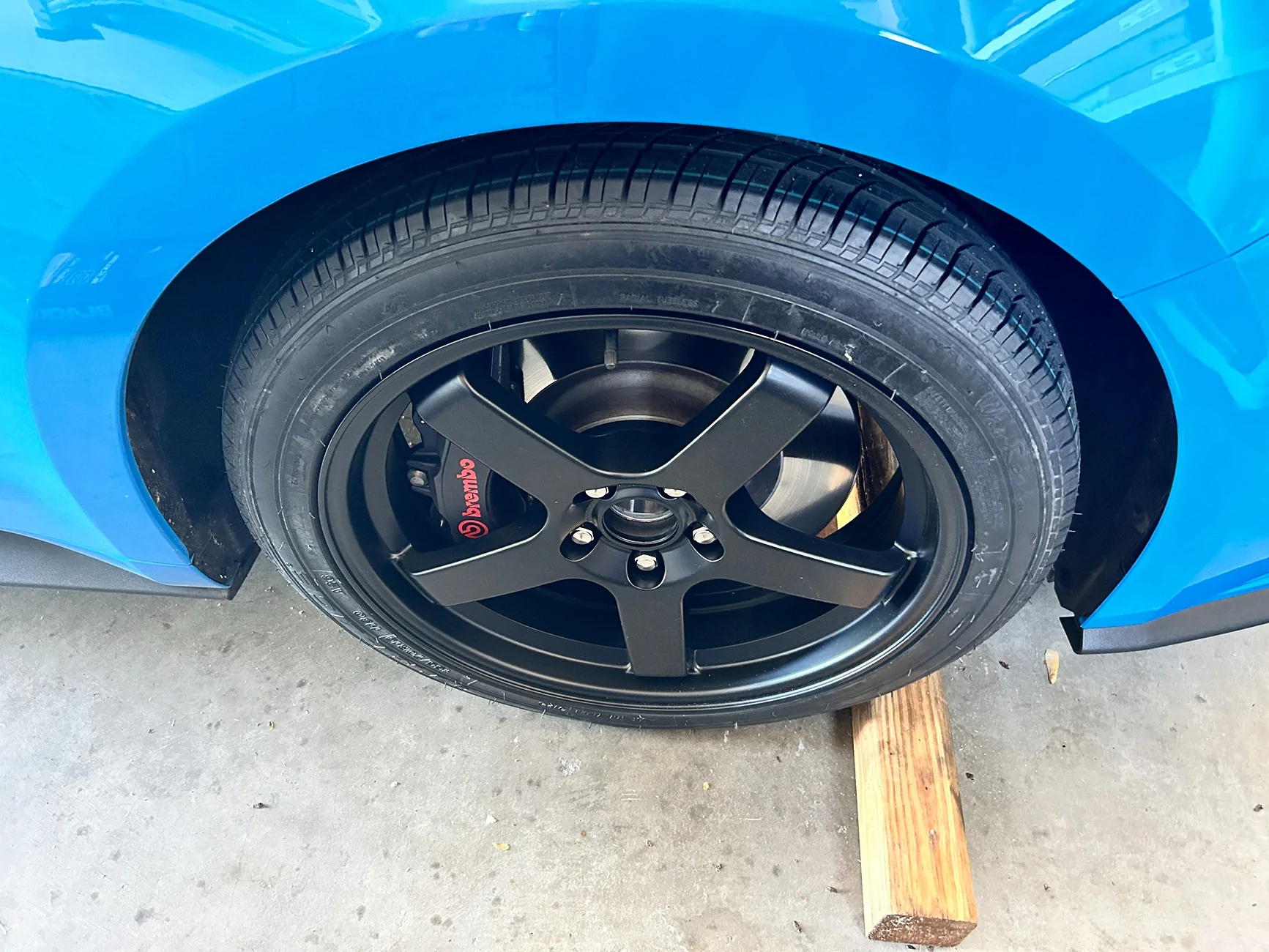

This spare will clear the front caliper? Or is it a replace a rear and move the rear to the front type thing? Either way it works.
Charlemagne
Jan 14, 2021
1,974
3,484
Czech Republic (Europe)
Nick
It will clear the front Brembo 6-piston calipers. You can read it in the description:
  • Fits over the Performance Package Brembo Brake System
  • Fits aftermarket Big Brake Kits
  • Will work for Mustangs equipped with 18", 19", and 20" wheels
  • Compatible on the front and rear of the vehicle

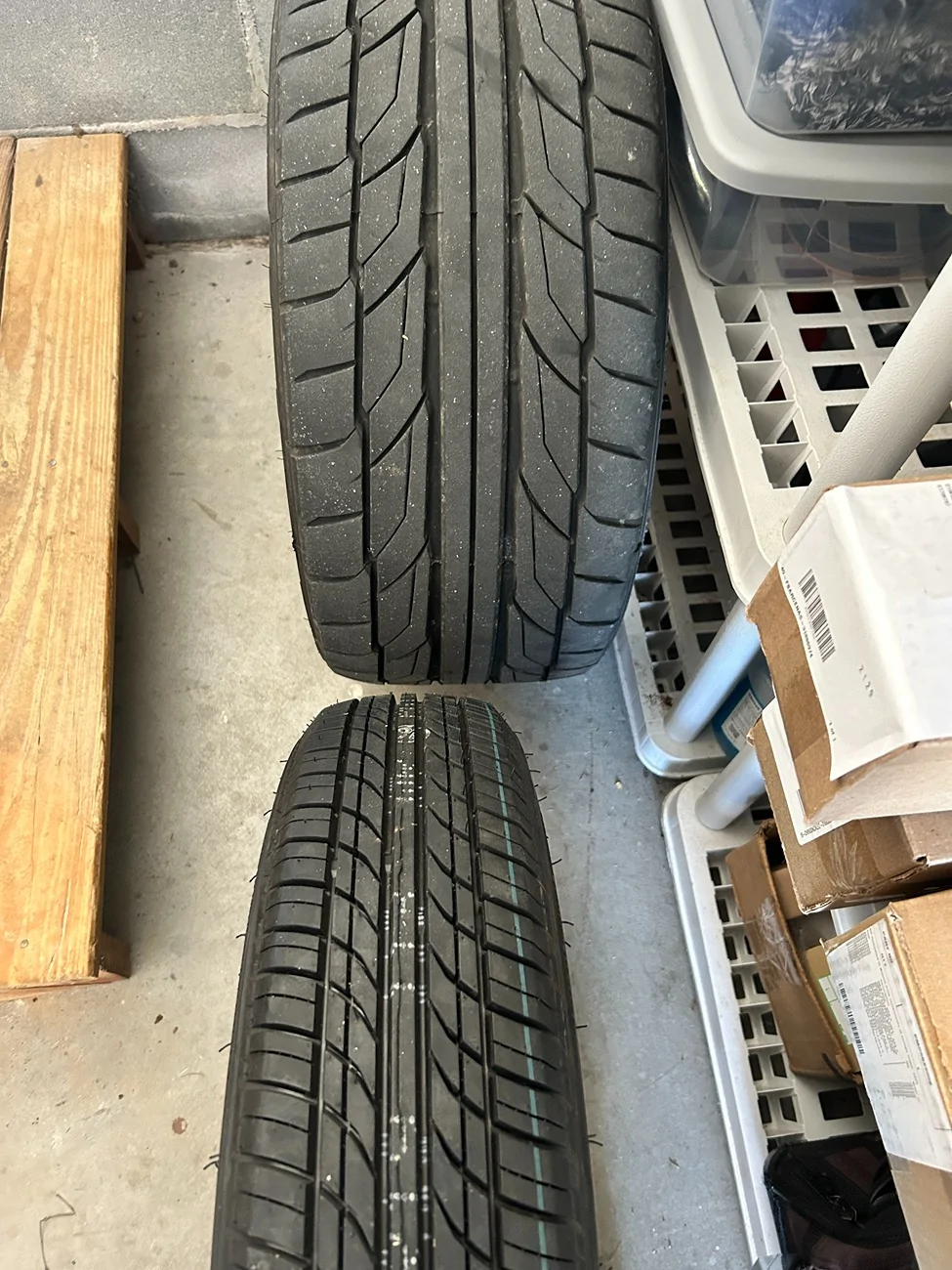

Pic of it on my PP GT, plus a side by side with the 275 35 20 tire I had on at the time :) :) . Same brakes as my Mach 1... It fit like a glove, I installed and I drove it around the block just for giggles when I got it...
