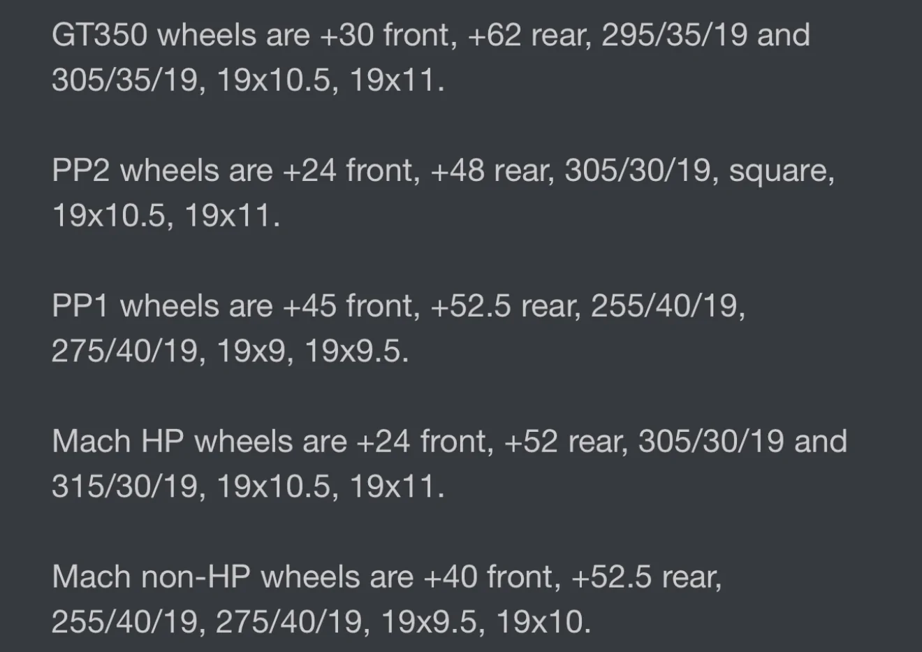

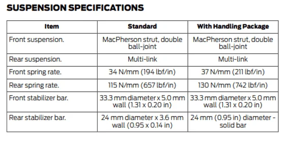

Marginally different spring rate and rear sway bar imo, on mine it’s not even something I’m considering changing, but did add the aero bits.
Cosmetically you’re looking at the lower HP splitter, front wheel arches, both of which come in a kit. For the rear you’re looking at the rear splash guards, which can be found as a kit exclusively from Levittown ford parts with the correct hardware I worked along side them to confirm. You also are looking at the GT500 swing if you want it, but you’ll have to have it painted to the paint code of the factory PP2 wing the car will come equipped with.
For the other bits as I said you’re looking at front and rear springs and the rear sway bar. I can dig out the part numbers on those if you’d like.
Then the camber plates you can add too by ordering the Ford Performance ones.
The OEM wheels and tires you can find from Ford too or other online dealers. If you want to find a different set here’s all the ones you can fit.
Any other questions let me know and welcome ;)

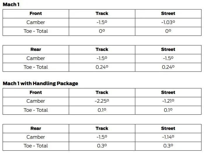

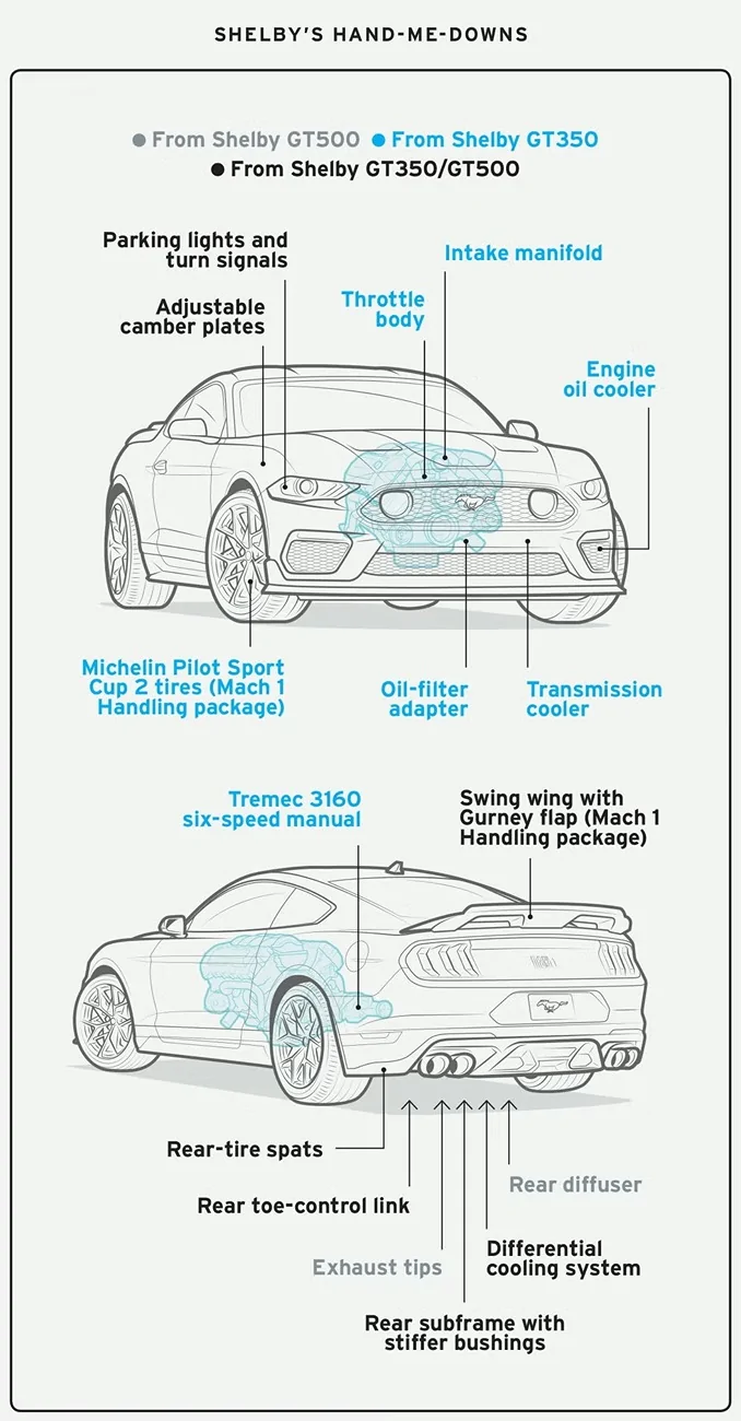

Why in some older threads do people say the non-HP and HP cars have different magneride calibrations, etc?
I went back through my notes.
In one brochure, Ford lists the GT PP car as having, "unique chassis tuning". The Mach 1 is listed as having, "unique Mach 1 chassis tuning".
Specific to the Mach 1, attached are some of the physical differences between the HP and base models.
Are the Magneride calibrations different? I think so, to take advantage of those component characteristics.
I'd expect different calibrations for GT PP, Mach 1 base and Mach 1 HP.
