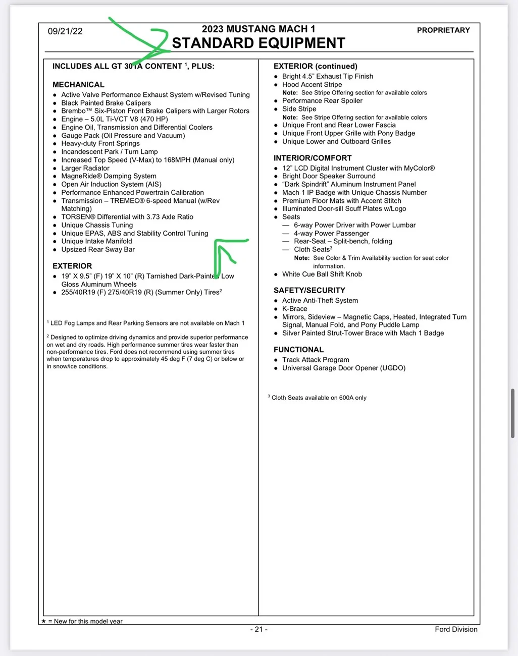

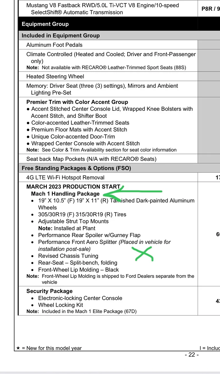

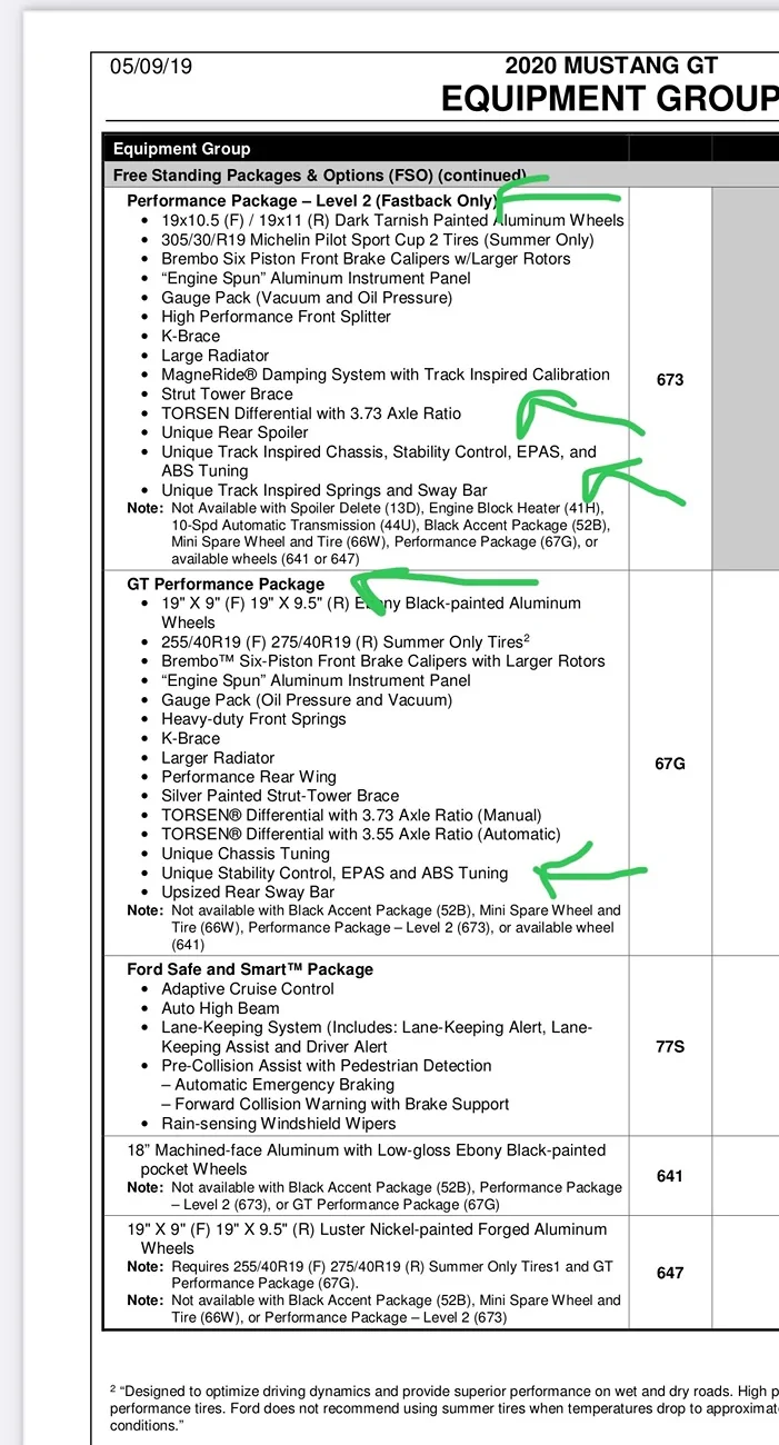

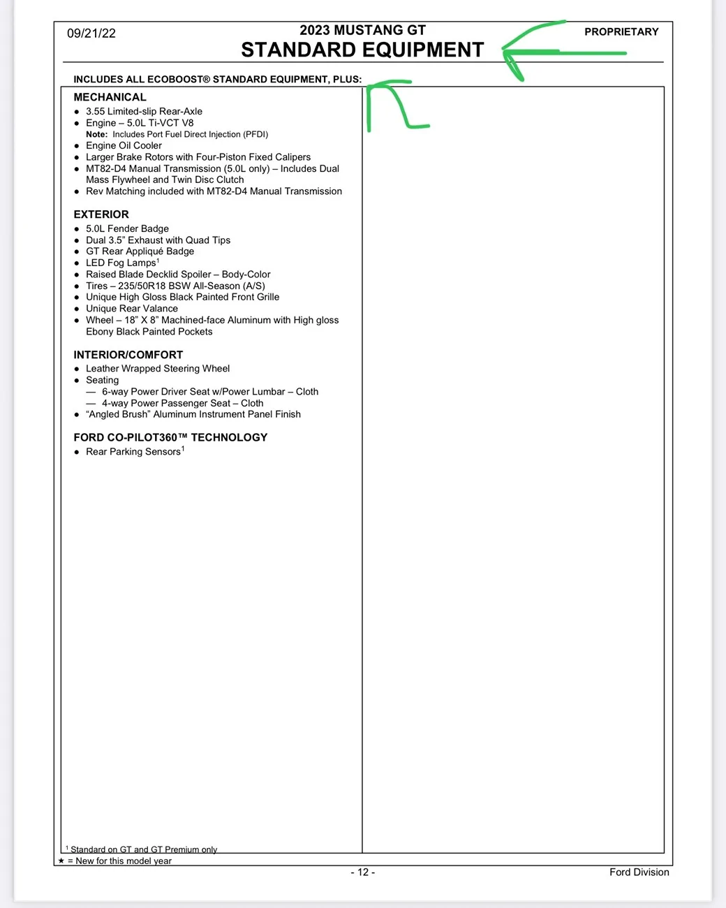

I did even MORE digging and looked at the 2023 order book. If you look under Mach 1, the keyword here is STANDARD equipment. It specifically mentions “Unique EPAS, ABS, and Stability Control Tuning” as well as “Unique Chassis Tuning” and “Upsized Rear Sway Bar”. If you look at the Handling PACKAGE there is no mention of either UNIQUE OR REVISED EPAS ABS or Stability Control Tuning OR Upsized Rear Sway Bar. The sway bar on a non-HP car and HP car are the same size YET one is hollow and the other is solid, Ford is VERY specific in these order banks if you read between the lines. The Handling PACKAGE does mention “REVISED Chassis Tuning” which clearly refers to stiffer springs and the solid sway bar, because they are not UNIQUE they are REVISED parts. Again, you must read between the lines. Why would Ford also specifically mention the HP wheels and tires, adjustable strut top mounts, spoiler, front splitter, front wheel lip moldings, just to leave out that they gave the HP unique or revised EPAS, ABS, or Stability Control when they mention it specifically in the order banks in multiple instances when they do? That’s because they WOULD NOT if there was any difference they’d let you know. What confirms this is the following and I’ll take you from the top. If you look at the STANDARD equipment for a Ecoboost, it mentions the inclusion of “Electric Power-Assisted Steering (EPAS) with Selectable Effort” again Ford is VERY specific in these order banks. Under the GT STANDARD equipment there is no mention of UNIQUE OR REVISED chassis tuning OR EPAS, ABS, and Stability Control Tuning, but it does mention “Includes ALL Ecoboost Standard Equipment, Plus:”. Though, if you look at the GT Performance PACKAGE it specifically mentions “UNIQUE Chassis Tuning”, “UNIQUE EPAS, ABS and Stability Control Tuning” and “Upsized Rear Sway Bar”. This is because it’s not part of the STANDARD equipment it’s part of the Performance PACKAGE. If the Handling PACKAGE added different EPAS, ABS, and Stability Control Tuning, it would be listed under the package and labeled “UNIQUE EPAS, ABS and Stability Control Tuning” NOT under Mach 1 STANDARD equipment. If you go back to 2020 and look at the order banks for the PP1 and PP2, Ford specifically mentions for the PP1 “UNIQUE Stability Control, EPAS and ABS tuning” but was sure to include on the PP2 “UNIQUE Track Inspired Chassis, Stability Control, EPAS, and ABS Tuning” this is because they get different tuning than each. Again, I’m beating a dead horse, when they change something they let you know right in your face. I listed photos of everything I discussed below in order. Cheers.

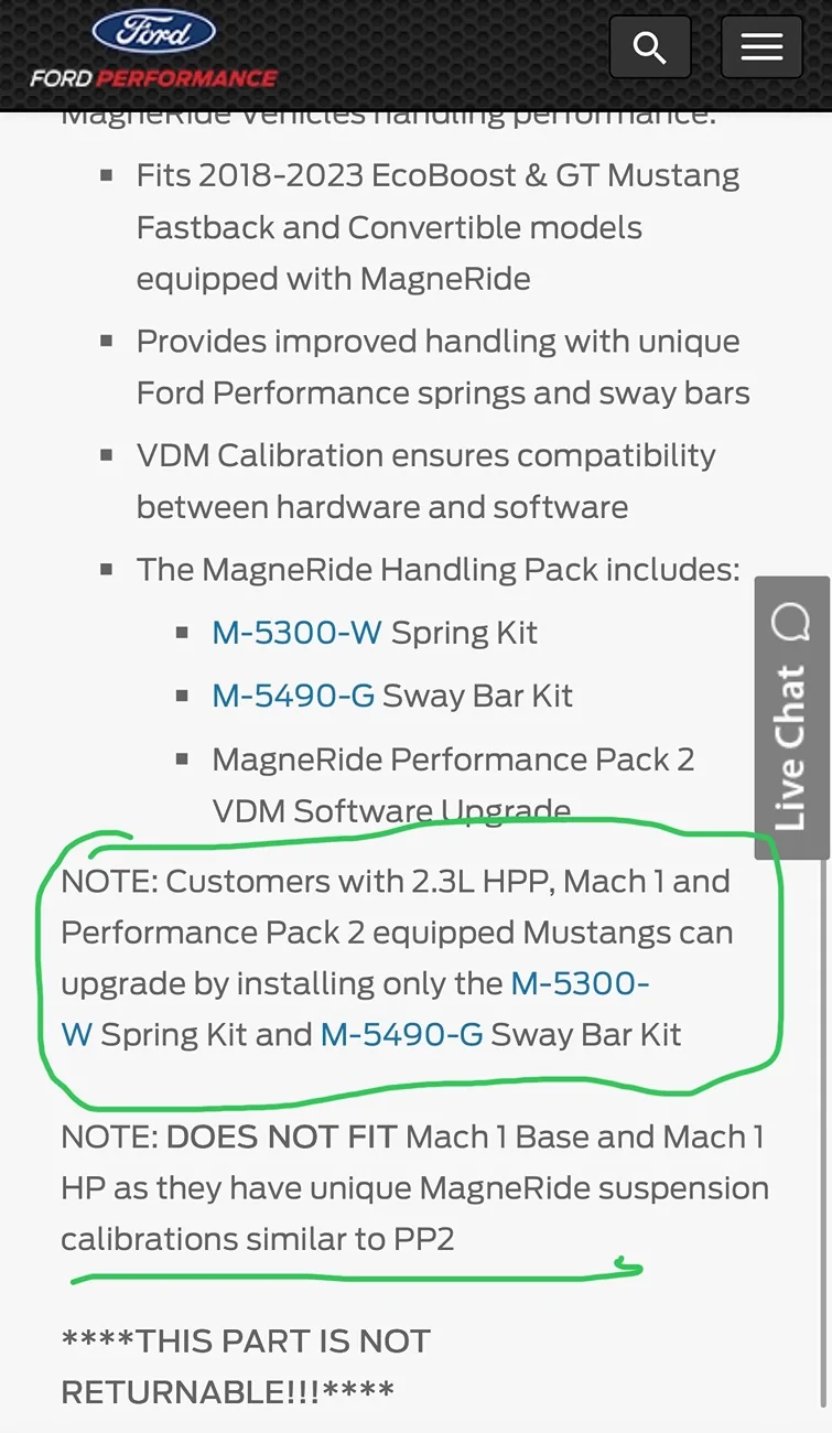

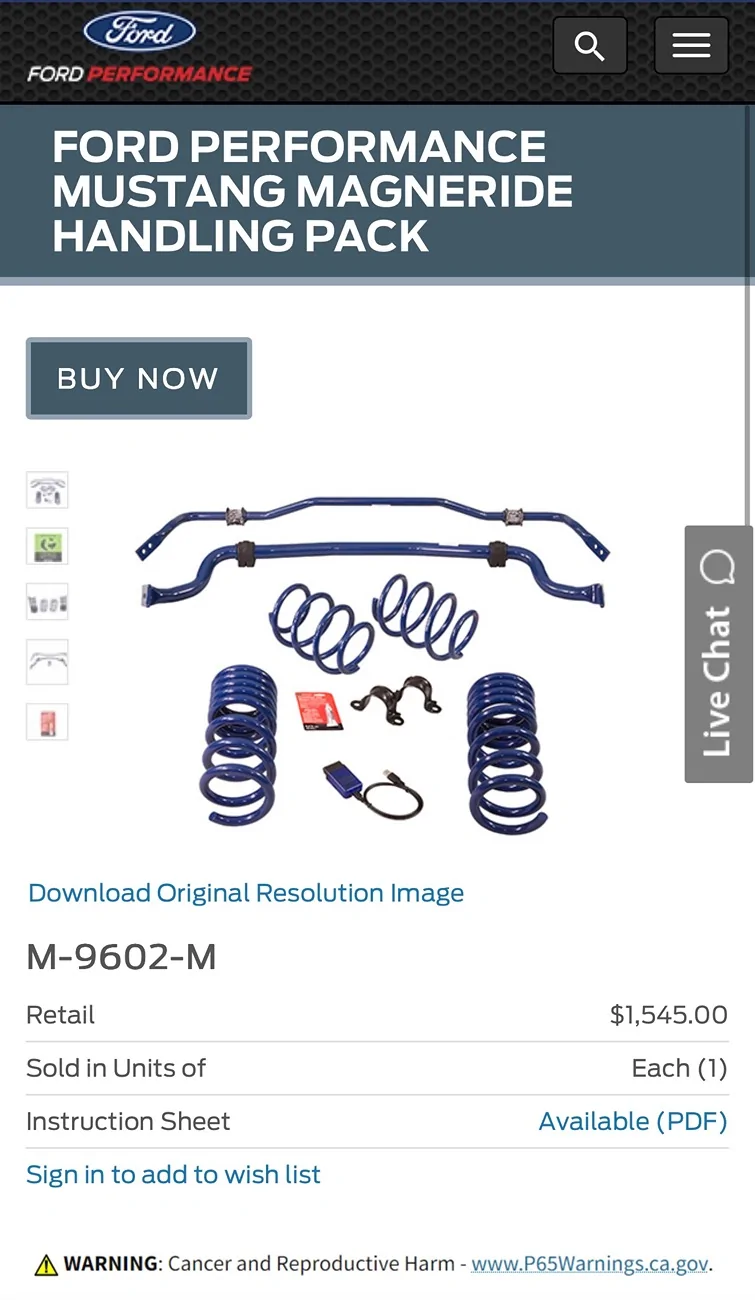

Just the cherry on top, why would Ford Performance link them together here too if they weren’t the same?

Just the cherry on top, why would Ford Performance link them together here too?
I guess to get an actual answer you would have to call or email Ford Performance and ask.

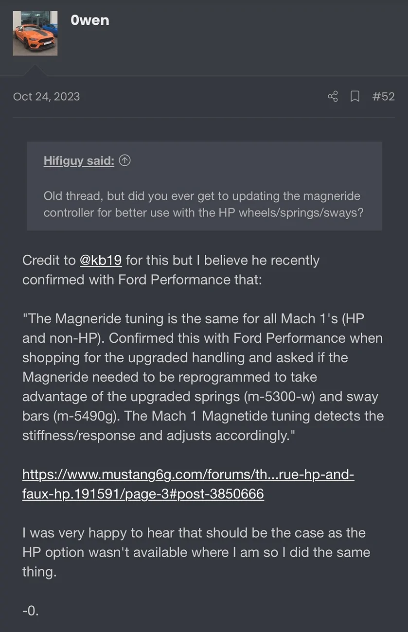

@Adr2600 - hands down for the effort! So much digging done, RESPECT!!!
Just a friendly advice - documentation from Ford tends to have some errors and inconsistencies. It depends on the actual date of publishing of documents, because they often have the documents for the "release date" and then a couple of months later get the 1.1 revision fixing minor issues which have been copy/pasted from older documents.
Still what you comment above seems very much plausible, I must admit. Moreover,Steeda are offering their own magneride processor once you upgrade your suspension with all the steeda goodies, so I guess they wouldn't toy around re-programming the ford unit, instead offer their own. So, my best guess is - ford won't toy around with it as well - they slap the same thing on all track/ performance pack cars and call it a day.
Each difference brings more expenses and potentially problems in the long term, so keeping it as similar as possible is key

Thank you sir it is my pleasure and helps me sleep at night to know the answers!! Haha and know I didn’t get jipped not grabbing a HP car 😂
I figured there may be inconsistencies but the wording remains consistent for the Performance Pack from at least (from what I’ve checked) 2020-2023 and remains consistent for the Mach 1 and Handling Pack option from 2021-2023! I checked several ordering documents to make sure, and all the ones that contain the Mach 1.

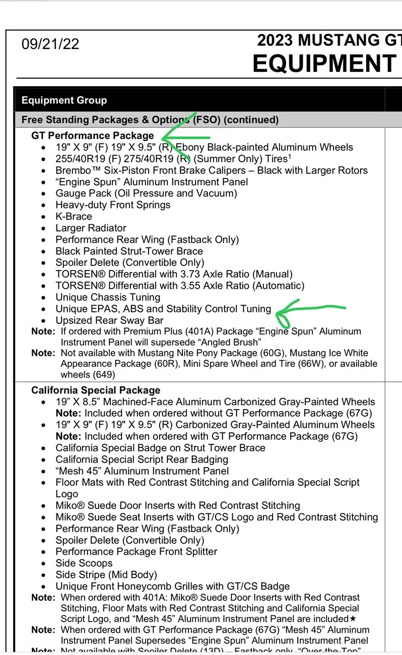

Here’s another thing, the GT350 is package 900a, the GT350R is package 920a. The 350R has different dampers, springs, sway bars, etc. and uses the “unique” phrase not the “revised” which I believe aligns with the logic too! As different dampers are a unique suspension setup, not a revised suspension setup(springs, sway bar only).
I also agree with your Steeda logic!!

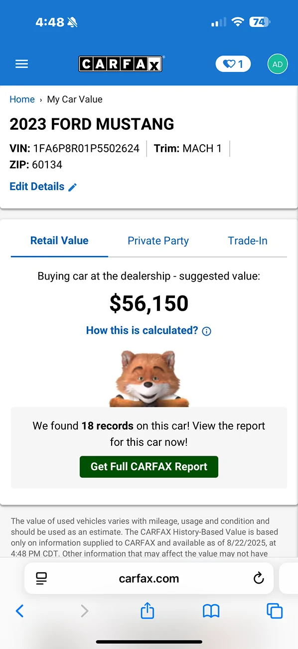

Don’t think it’ll matter as much as some think versus a GT350/GT350R which is an equipment group not just a package.
Mach 1 HP:
Mach 1 Non HP:
NOTE: These vehicles are equipped exactly the same, same mileage, except the one vehicle has the HP and also Mach 1 appearance package which cost another $1,250 (FJG/orange). Yet we’re only looking at a $520 difference in value by carfax.
