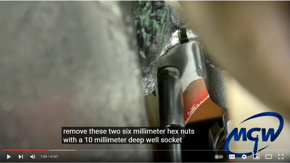

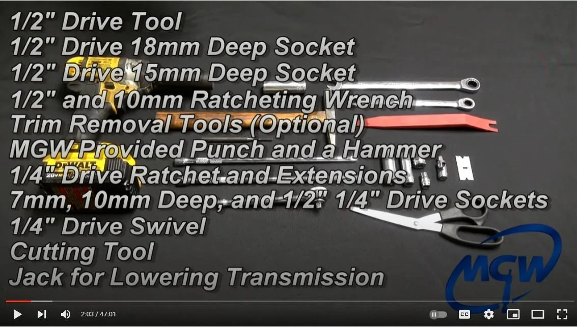

I have already watched the instructional video from MGW several times and this particular comment still confuses me. Do I need 6 mm socket which is 10 mm deep?
This one was not advertised on the list of tools:
I actually do not have all those tools and want to make sure to get the correct ones. If I had a full set, I would not ask.

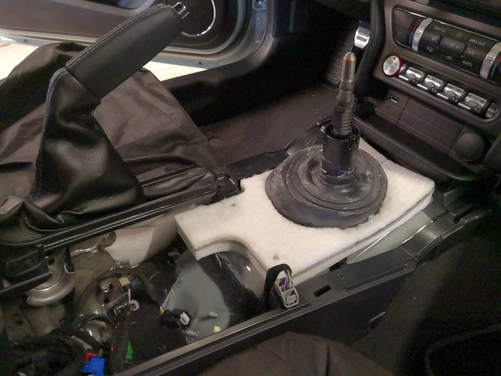

- My factory boot was a two part piece and wasn't mounted properly from the factory and was sideways (see attached). The piece sticking out to the passenger side should have been pointing down to the rear of the car. Potentially it impacted shift feel and noise on stock. Fairly simple to check.
- Installing the provided new boot was a pain in the neck. Total install was around seven hours, solid three of which were spent on the stupid boot. And even then, I cut the top off to make it easier (ordering a new one to try again at a later time).
- I do hear some new very slight noise from the shifter area and thinking a properly installed boot will fix this.

Could you elaborate a bit on what was the problem? I assume by "boot" you mean the rubber cone, or the "leather" sleeve, or the whole assembly?

Rubber cone. It must form a tight seal around the shifter body and the car body so nothing gets inside the shifter. On the shifter body, there is a groove specifically for this. Once you slide it down over the blue shifter stick, George said to work your thumb between and stretch out around the shifter like a bicycle tire, starting from the back. As soon as I moved to another corner, the one I just got done with slipped up, over and over. If you think you are done, I would check from the bottom of the car to make sure. I think not many check it and it is not seated properly. If I was you, I'd try to fit that rubber boot over the shifter body before sliding the shifter assembly into the car. Maybe even try getting it down with the boot on and adjusting the reverse lockout with it on.

Going over this thread now, I realized how much I forgot (though I believed I had not) and that I should have read it again right before the install. I did it two days ago and now it seems I basically relived the same experience as @Rock50 except mine was twice as long 😂. (But I loctited everything, so it may count.)
The original assembly of the boot looked like this on mine:
Did not inspire confidence.
