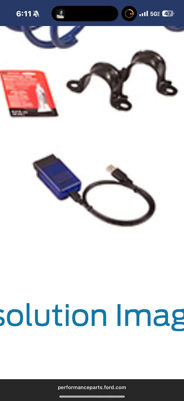

I guess this means Ford needs to include a USB with the HP Mach 1 “Kit” they’re not smart enough to offer.
At this point it really makes no sense. We’ve seen it can be done via the software with the magneride handling pack.
We got guys hooking up 2015-2017 EPAS into 2009 Mustangs though in coyote swaps haha, it can be done I’m 99% sure.
