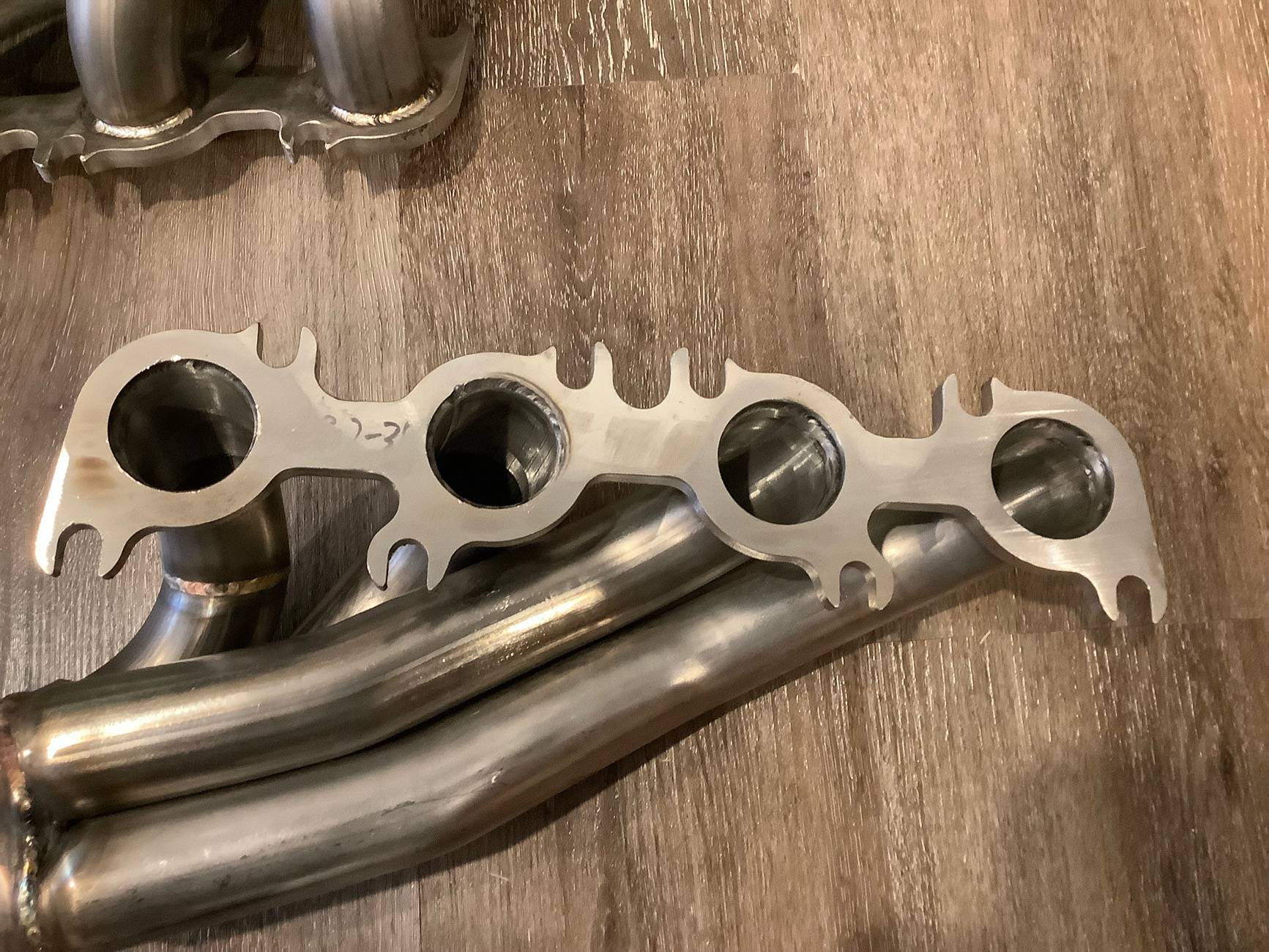

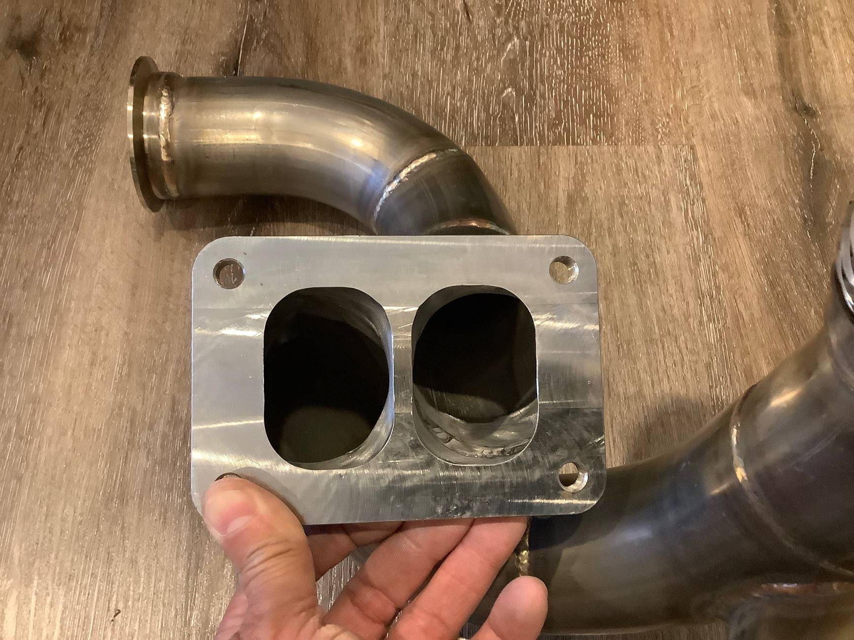

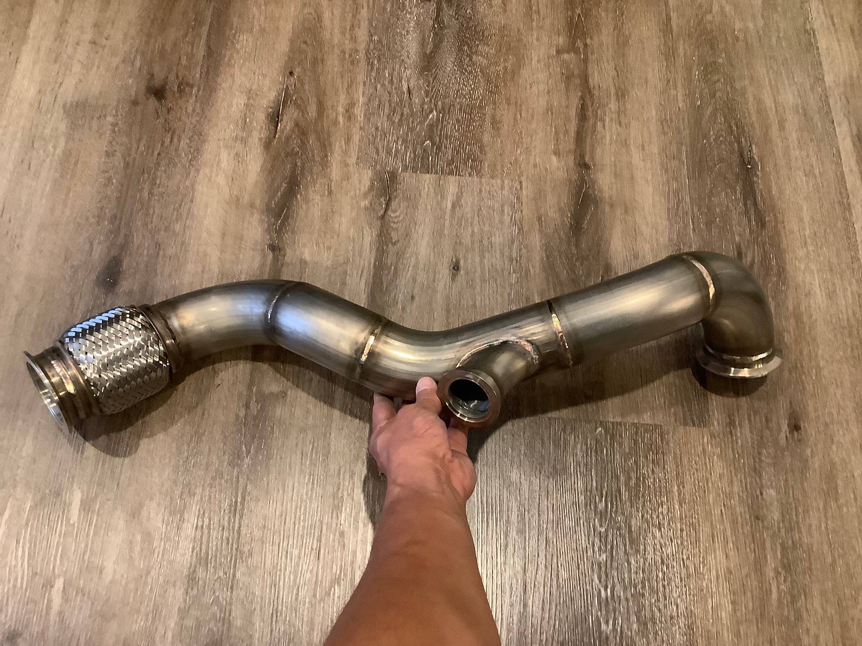

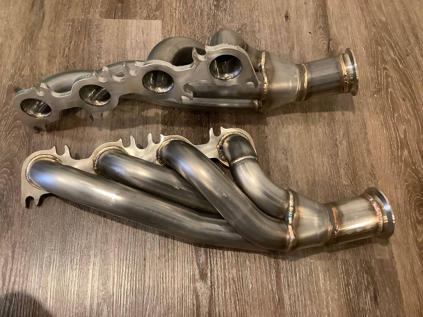

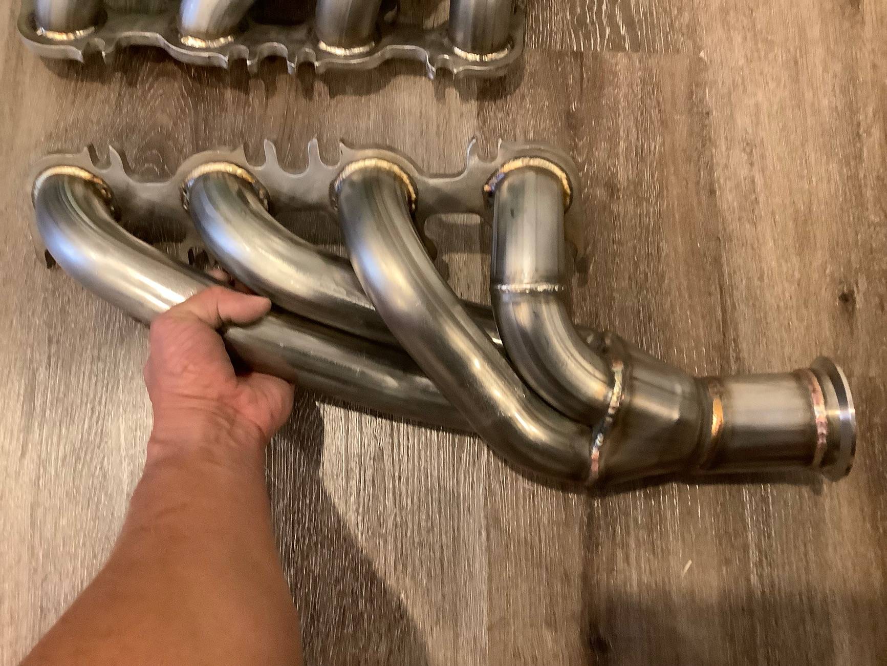

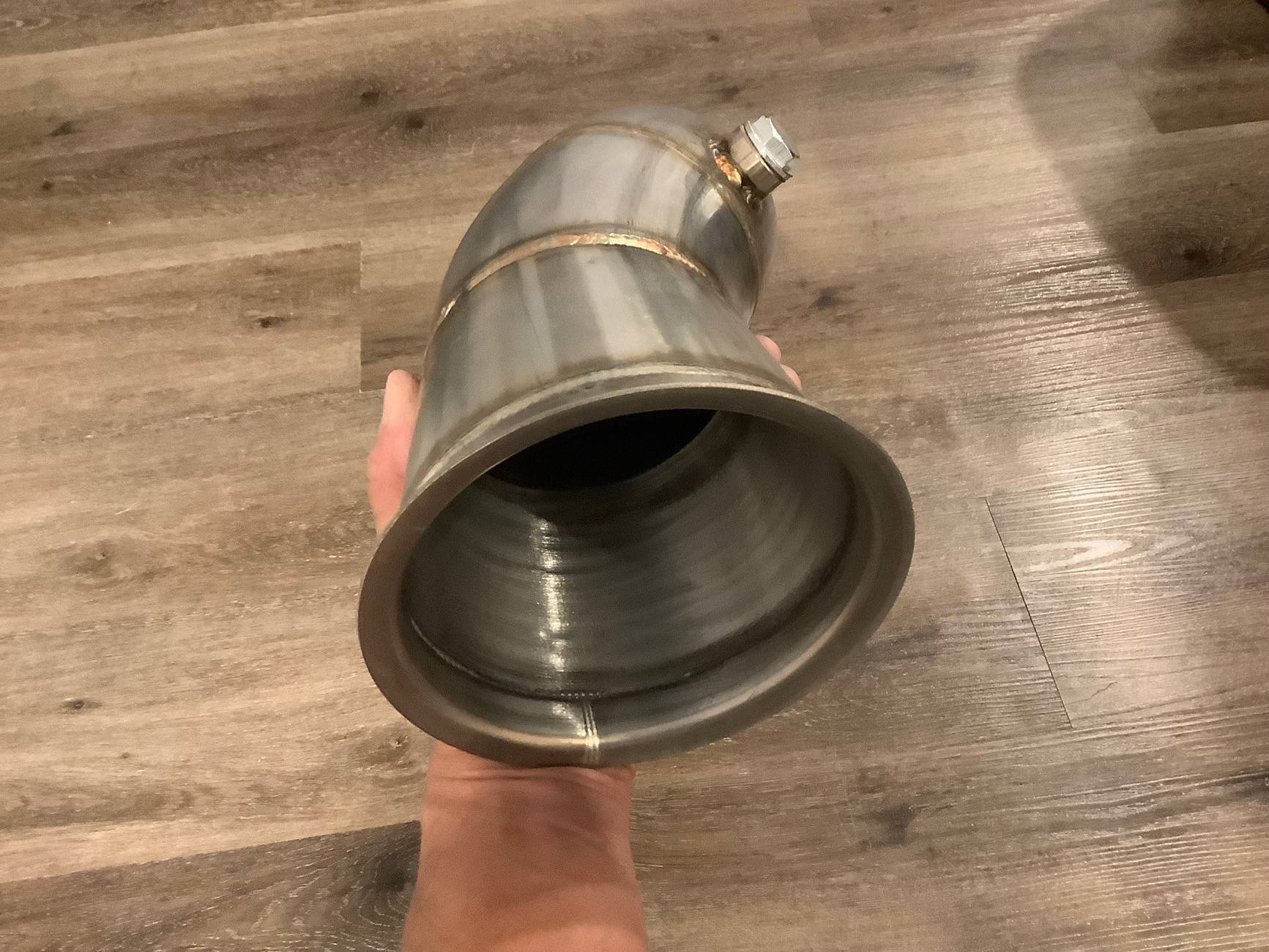

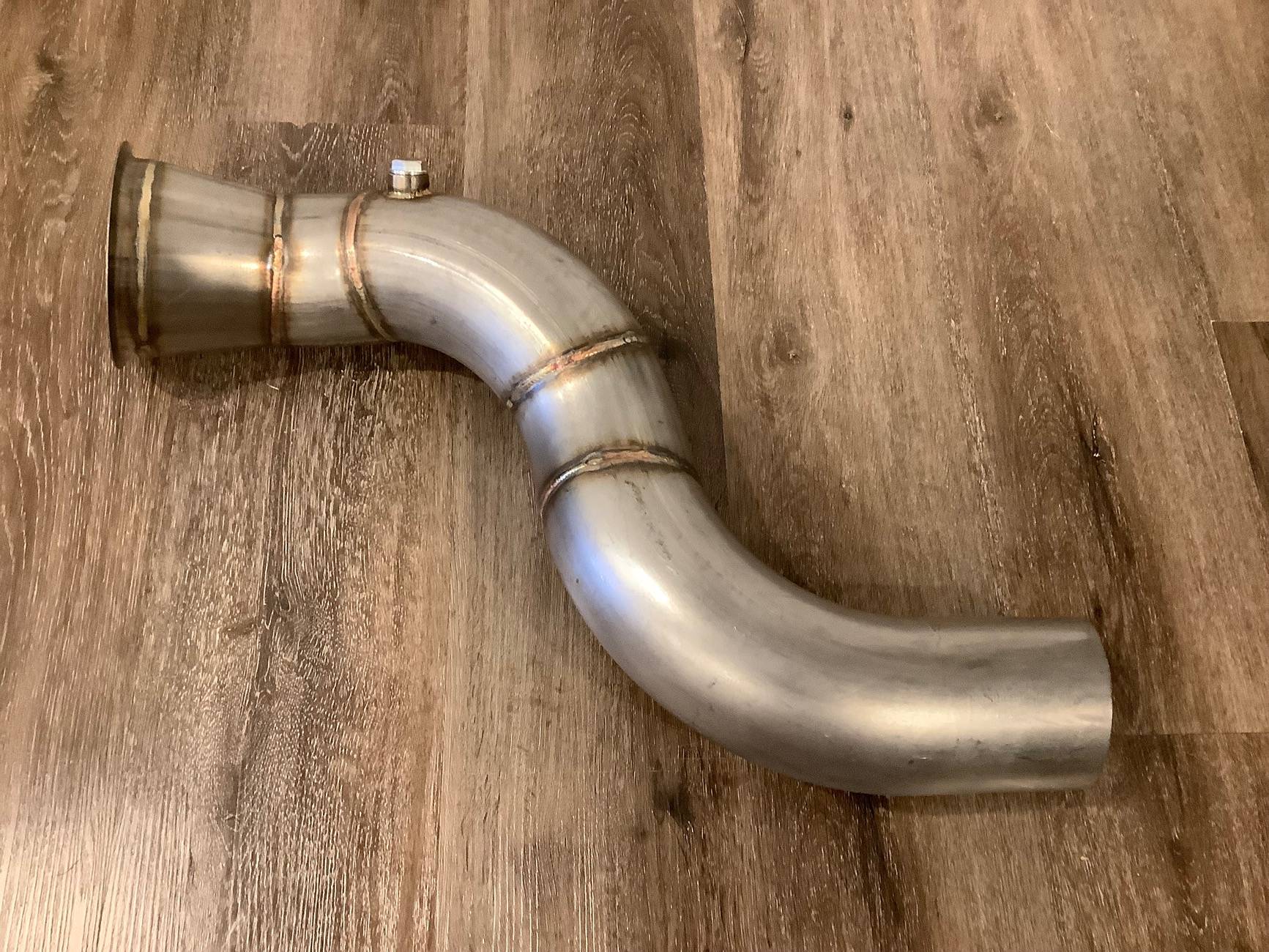

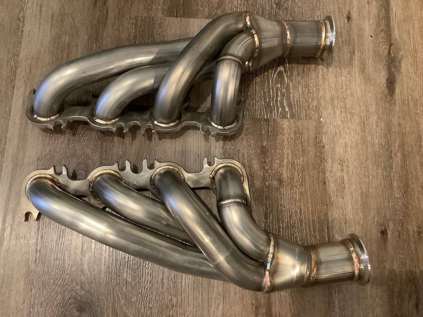

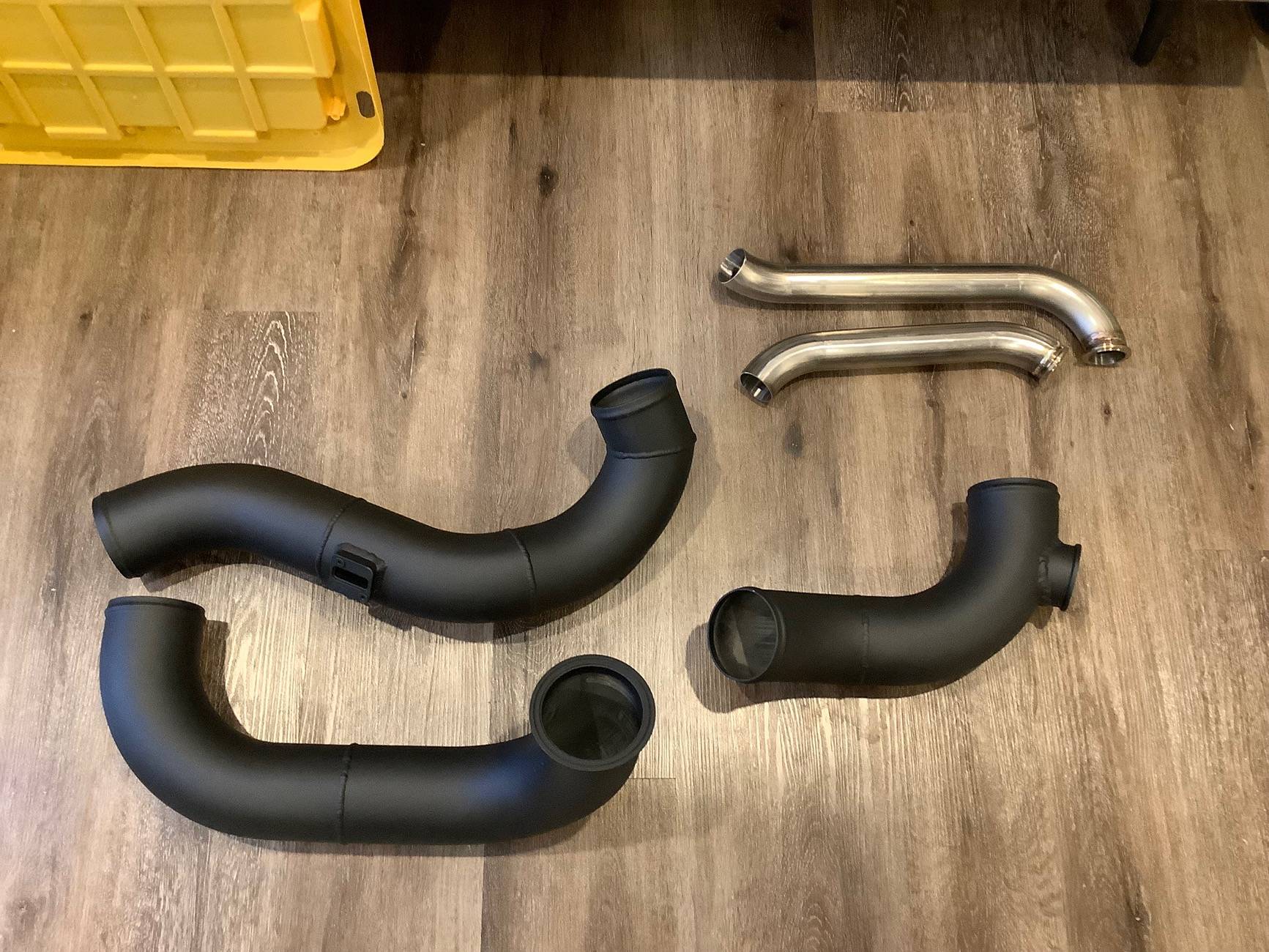

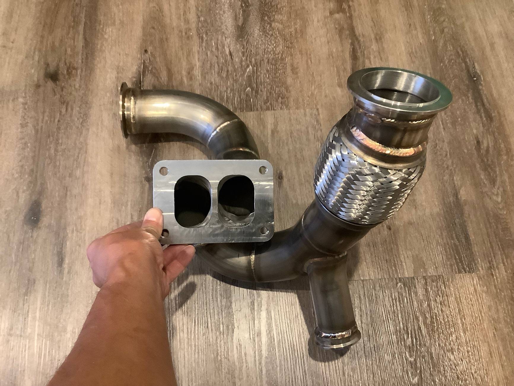

It’s too late to turn back now! I’ve already reached V1-Rotate and pulled back on the controls to get the project airborne, lol. I just received the hot side piping today. The welds are phenomenal. Here are a few pics that I took of the piping during inspection.
Cold side piping.
