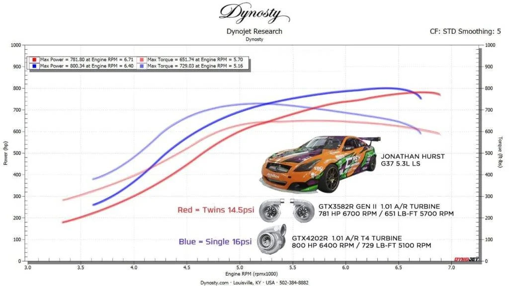

This article from Garrett sure peaked my interest on a single turbo set up for mine.
https://www.garrettmotion.com/news/...t-jonathan-hurst-gtx4202r-vs-gtx3582r-gen-ii/
Please tell me we're not going to have this debate/discussion. It's already settled law. When comparing PROPERLY sized turbos, given the sheer constraints of mathematics (and the volume and area calculations for a circular assembly) and combined with the natural and unavoidable compressor curves for a turbine, twins will spool faster and make better responsiveness than a single. Again, the marketplace isn't just all wrong (and someone else has the magical unicorn solution). There's a reason that MOST (if not all) OEM's who feature turbochargers do so now in a twin configuration or if there are legacy arrangements, they're usually compound (i.e. a big and a little in series).
A big turbo that takes longer to spool is no big deal if A) It's a race car and you're only asking it to live in the high rpm range between gears anyway B) You employ a means of pre-spooling, like nitrous or antilag, C) You actually PREFER it to be gentrified at lower rpms and drive very docile and not get crazy until you really ask for it.
This is all negated a bit with a 10 speed depending on how the shift strategies are setup.
A big single is a simpler build, ESPECIALLY if you have to relocate the PCM and do any real estate clearing of the front passenger engine bay area. But let's not get it twisted, there IS a tradeoff with a big single and that's lag. Lag can be managed on a big single, but that also comes with additional complexities and tradeoffs.
When properly sized, a set of twins will spool quicker. It's just math. You can get them into their optimal compressor curve faster because the overall cross sectional area of two smaller turbines (compared to one larger unit) gets into appropriate blower speeds sooner.
