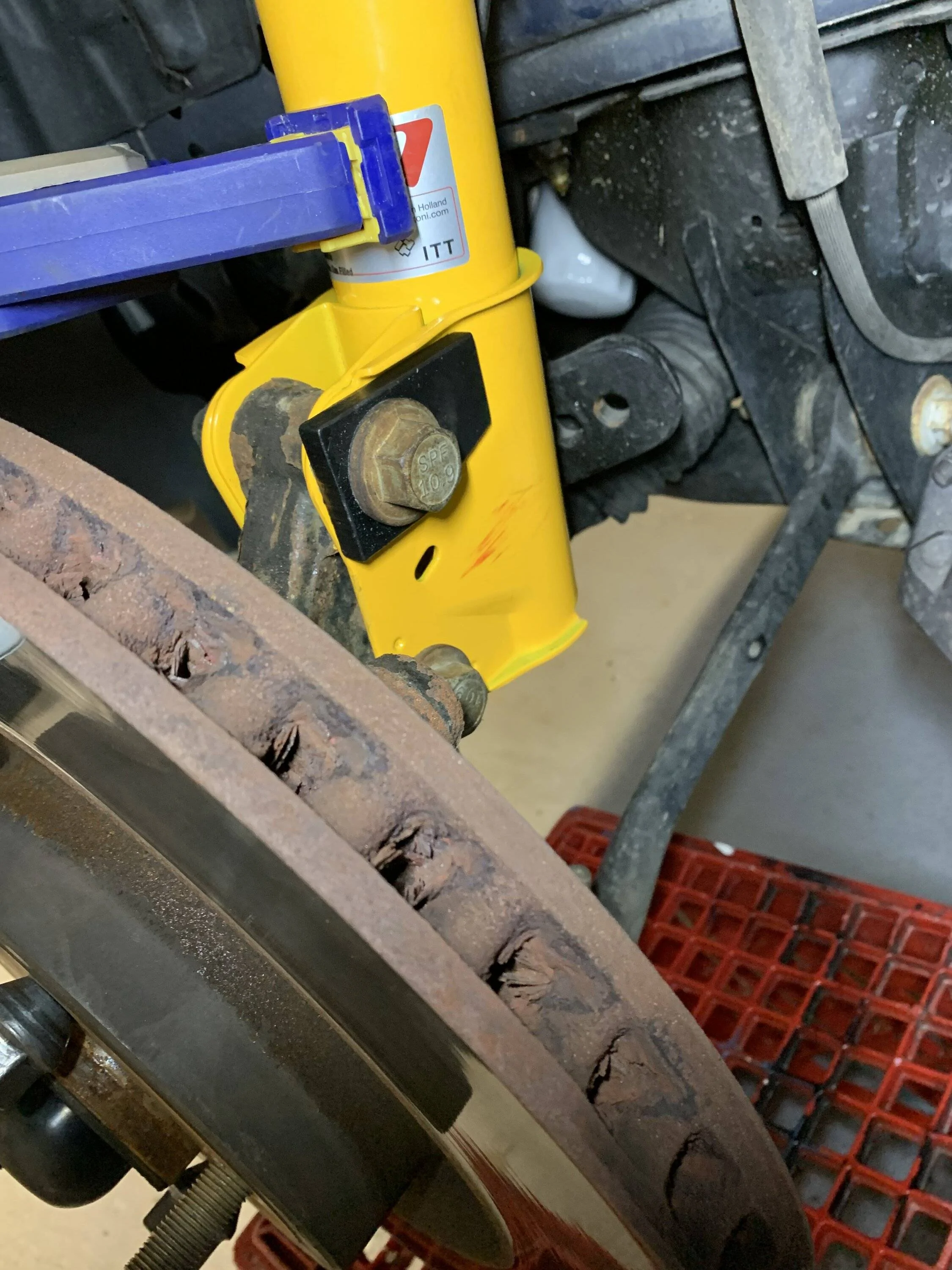

My front Koni yellows are folding due to brake torque (Both of them). I sent an email requesting warranty coverage for this and have “engineered” a piece of metal to go under the upper bolt and maybe prevent this from re-occurring.
hopefully they just cover it. Otherwise I need to make decisions on the front suspension.
What coilovers are the happy balance of cost, robustness and performance these days? I would normally go for redshift but fear they might not deliver due to financial distress.
Update: one strut let out the ghost upon disassembly and my re-enforcements fit fine. My car grew 3/4 inch toe out at the same camber, so things must have been pretty bent in there.

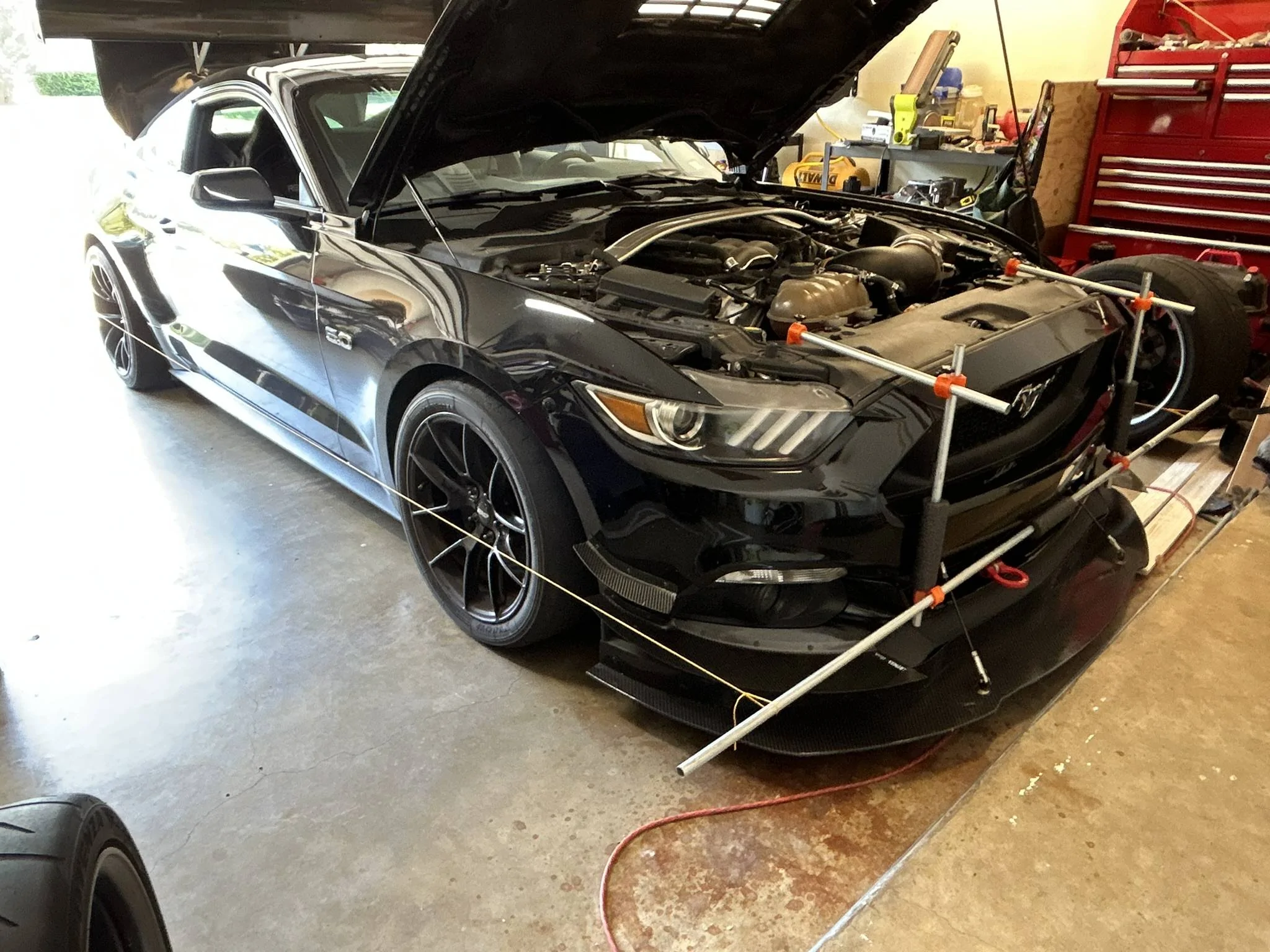

Today
- reset the front coilover ride height for changed springs
- measured toe with toe plates (not pictured), looked like very slight toe out.
- cut tubing and assembled the Caliper Garage string kit
- measured front and rear toe with string. Rear was about what it should be from the last alignment on a rack (slight rear toe in) and front about matched what the toe plates said (ever so slight toe out).
I don't think I'm gonna ever be messing with the rear camber and toe settings myself in the garage. I'll pay to have those corrected when I need it... but now I think I will confidently check it so I'll know when I need to take it to somebody with a proper lift/rack.
Front, I think I won't mind doing those adjustments myself going forward.. Hopefully quickly save enough $$ and time to pay for the tools. Spent ~400 on plates w/ camber gauge (220), string kit (70), conduit tubing (20), and properly sized wrenches for the front toe bits. (80). That's less than the price of 3 alignments at a decent shop, I figure.

Looks perfect! Putting it on an alignment machine can't do any better than what you have right there (although fish line instead of actual string would be a small improvement). At this point, it's just a matter of how picky the guy setting the alignment wants to be.
