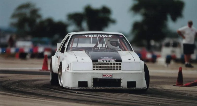

RE Spring rates
I had a 85 GT C Prepared Mustang I ran from 1990 to 2002. During that time spring rates went up inline with tire size increases and tire compound/design improvements. For example, when I started CP was limited to 10 inch wide wheels and 15" wheels were still the hot ticket. One year later and a bunch of us were squeezing 12" wide Firestone GT1 close out tires on 16x10" wheels. Within a few years 12" wide wheels with a 50lb penalty were allowed. So now we could put soft compound GT2/GT1/Trans-AM tires on the rims they were designed for.
From that point on, suspensions got more sophisticated and spring rates (wheel rates) went higher and higher. My car ended up with 1650lb springs on front and 780lb springs on the rear (all in the stock location) combined with the biggest OE Fox body sway bars. On fresh Hoosier rubber that car was loose and fast.
The point of the long read is that CAMC is an evolution. Right now a talented driver (not me) could take a fairly streetable car with some decent aero and do well with it. CP in the mid 90's was like that too. But a bunch serious efforts in CP put folks on notice. The same thing will happen in CAM and spring rates that seem extreme are just a symptom.

I ran in ESP with my '79 Pace Car in the early/mid 90's (not as long as you or at as high of a level). I can't remember what the rates were, but I was on the Ford Performance springs. In retrospect, I think we ran those cars stiff because the suspension geometry was so bad. To quote Chapman, "Any suspension will work as long as you don't let it." Your numbers are extremely high in a mathematical sense, but they might have been a better compromise than dealing with that mess of a suspension. At those rates, you're seeing the lion's share of suspension movement in the tire sidewall. I don't see how this approach would work with our cars. If I had that car to do over, I'd take a significantly different approach. That was the car that started me down the road of not liking oversteer. It's not that I was scared or whatever. It's just when you're trying to gather the thing up all the time, it's hard to go fast. Drifts look cool, but they're slow.
