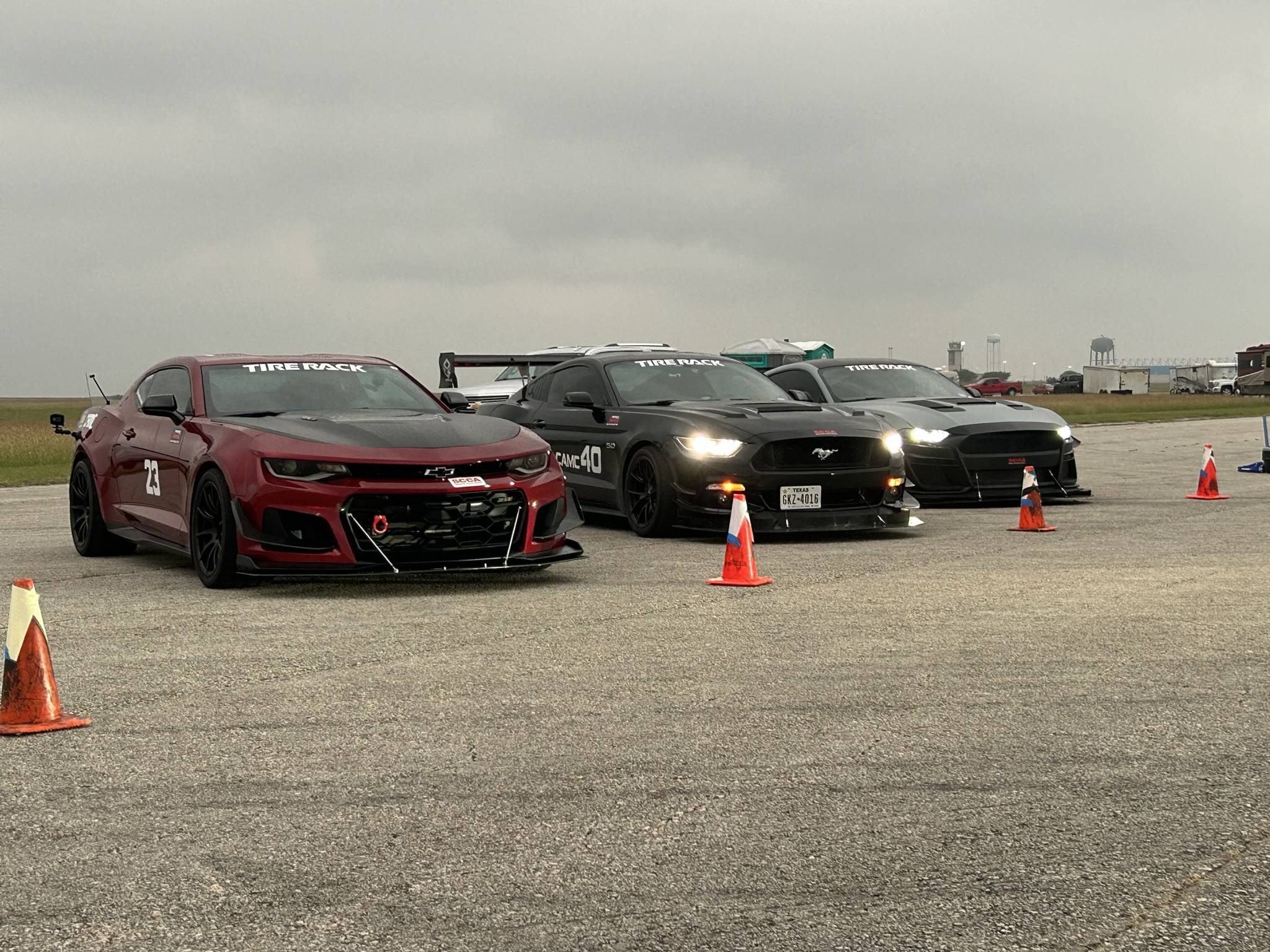

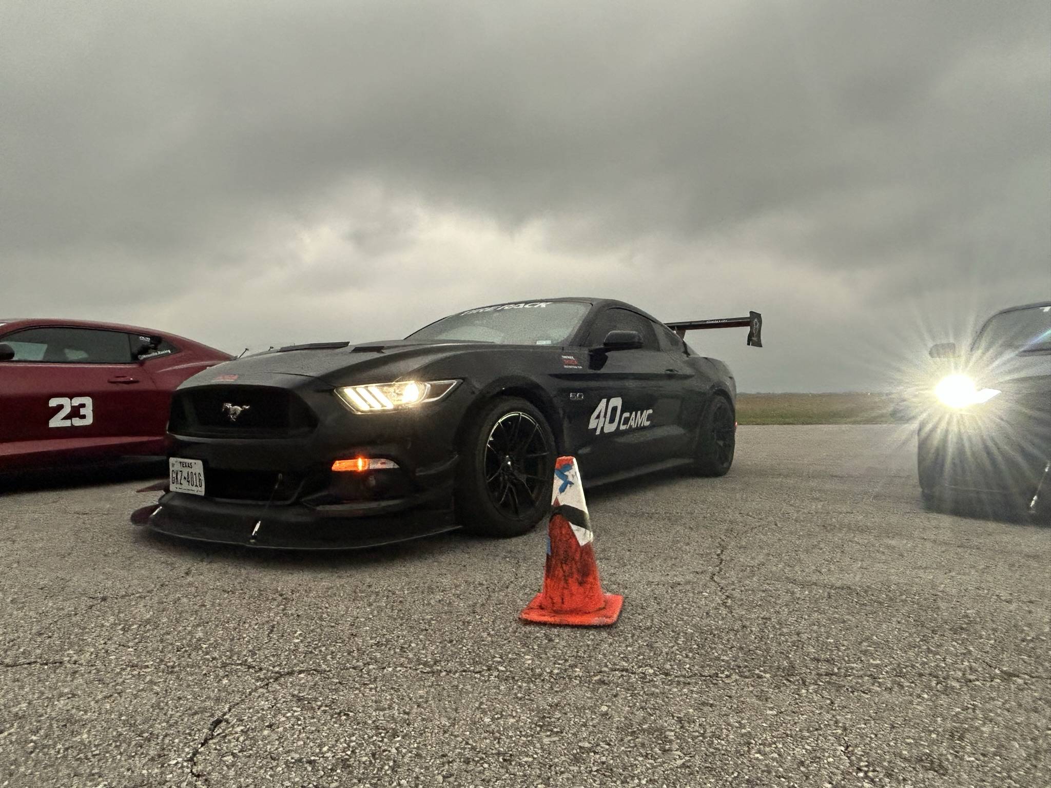

@mavisky Car looks great.
I had a decent weekend at the Beeville Tour.. Could only manage 3rd. Otis in his ZL1 1LE still gives me fits, and Hedderick codriving was very fast driving Fletcher's car like he stole it.
Some situational things put me at a mild disadvantage that were out of my control, but 2nd place was achievable. To beat Otis, this mustang will need $$,$$$ of hardware. A better diff at least with different gearing, and probably more of power too.
My new fuzzy codriver was a bit of a distraction too.
