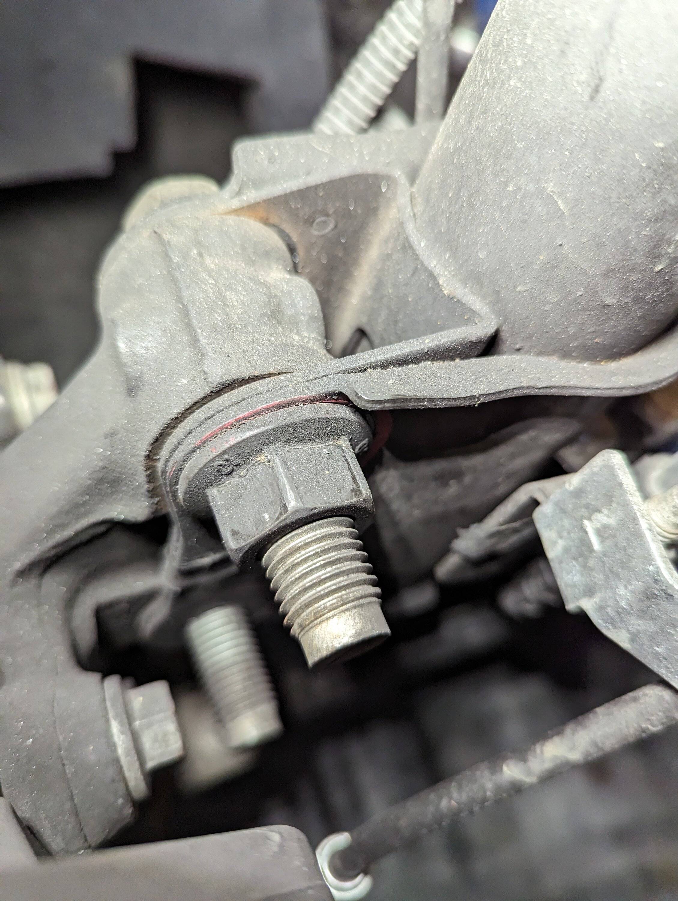

That's my left front strut to knuckle joint.... Upper bolt had a nut half way down the thread (completely loose - it's tightened on the pic), bottom one (out of focus) had no nut at all.
I looked this evening at all front joints because of slight rattle over the bumps at low speed last weekend. This also makes for somewhat variable camber (struts were slotted for FS back in the day and bolts are non-splined service ones) and therefore toe....
Really should have been better about making sure car is mechanically sound before the season but was lazy and stupid.
BTDT. Glad the bolts were splined!
Yes those need to be checked from time to time, I had the same 😱 moment with mine.. I paint marked them after all, so if they start moving I catch it early. Check them every time I flush brakes before every event.
They're technically single use (both bolts and nuts) but don't think anyone throws them away. I called Lebanon Ford today (who has to be doing shitton of lowering springs on their cars) and parts guy said he never sold a single one.

Wow! I'm glad they're essentially pressed in bolts but dang. I typically try to give everything a visual inspection whenever I pull the tire off. I've found loose or broken swaybar endlinks (not on my GT350) and broken suspension ride height sensors (on my GT350, twice). I'll check the torque on those nuts next time I change tires. Thanks!
Yep, I had them replaced after this. In my case, one nut was completely missing, another one hanging on last threads, one of the bolts started coming out. Other side was undertorqued. In my case it probably was mechanic error when doing springs, but I'm paranoid about these bolts now.

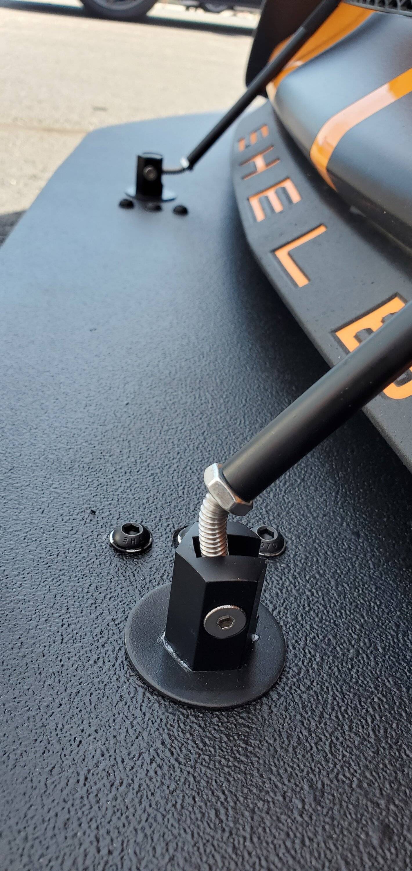

There were two casualties however, part of the course had a rather large dip and my Longacre splitter rods (which need to be about 2" longer) decided they'd had enough of this whole bottoming out the splitter shit.
i have some Professional Awesome rods and carry extra rod material to events in case I frag one. Its happened. Kinda predictable even.
Pic from today’s first outting with the wing on the car.
Car looks great. I have spare ends at home. Looking into thr spring loaded units from AJ Hartman as my next set.
You caught it, so you could have been more lazy.
