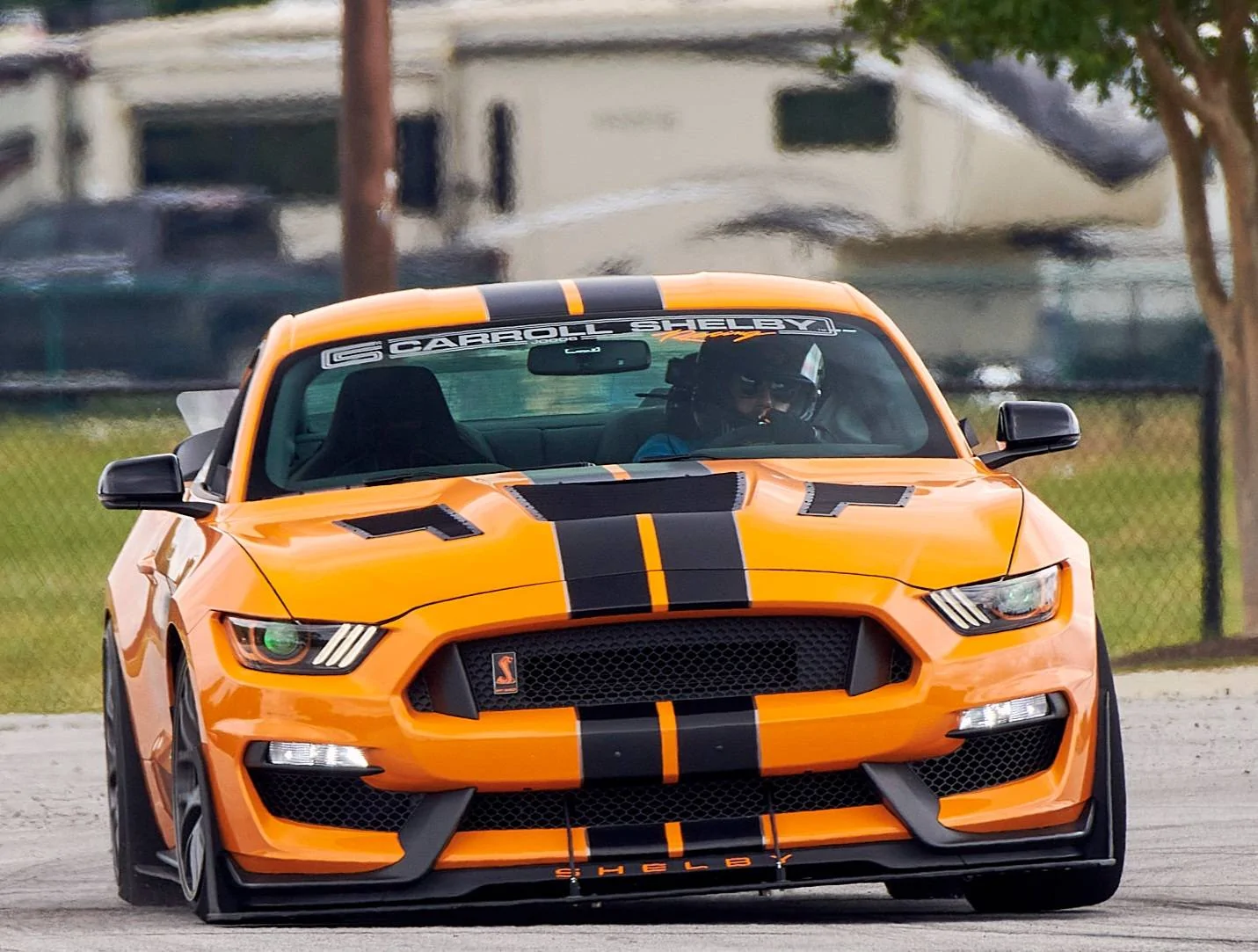

Had a great weekend. Made some spring, bar, and alignment upgrades over the last month and won CAM-C and finished 5th overall in raw times at our event with the Atlanta region. Car is still full weight with all interior and 0 weight loss efforts.
Current Setup:
Steeda Dual Rate Magneride Springs
Steeda Competition Swaybar Setup
Steeda Adjustable Swaybar Endlinks F&R
Steeda G-Trac 2 Point Front Brace
Steeda IRS Subframe Brace
Steeda IRS Alignment Dowels
Steeda Polyurethane Vertical Links
Steeda Camber Plates
Steeda Rear Camber Adjustment Kit
Steeda Low Profile Jacking Rails
Apex 19x11 EC-7 Wheels
Kumho V730 - 305/30-19
6" front chassis mounted splitter with GT500 style splitter fences
10" rear lexan spoiler
Verus rear diffuser
Trackspec GT4 style hood vents
stock drivetrain with resonator delete
Great set-up & evil looking Shelby!

Looks like I need to add a couple of splitter protectors to the outside edges. Good thing I already ordered some up today.
You need some front spring/bar, not roller skate wheels on the edges of the splitter.
Currently on the Steeda Dual Rate springs that peak at over 300 lb/in and their competition front bar. I agree that the front spring could be higher though. Really wish that Steeda offered a coilover magneride conversion for the front like they do with their adjustable rear setup.
