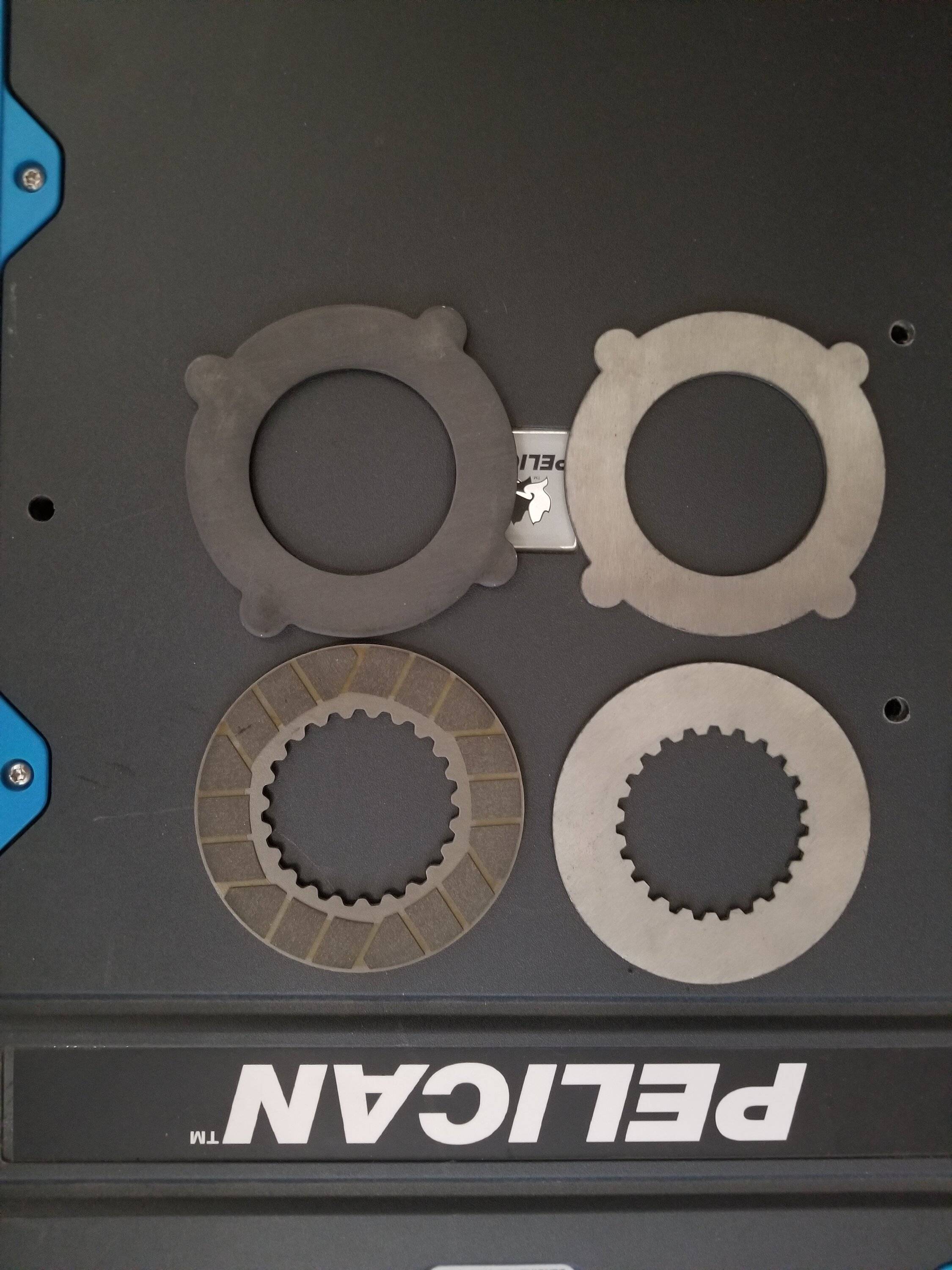

This is my first shot at diff plates. That internal spline is a bit of a bear to measure & cut. This floater doesn't fit. The drive plate is easy-peasy.

ahhh. surely you can have a machinist indicate onto center and re-bore it to size?

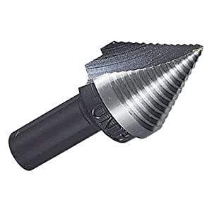

They could probably just use one of these...
good god no! you're joking I hope. Proper dial to indicate down to a couple thousand's and a meaty boring bar on a adjustable boring head. Final size confirmed with mic.

Ya, it was a joke. There's a big difference in ring gear size.
