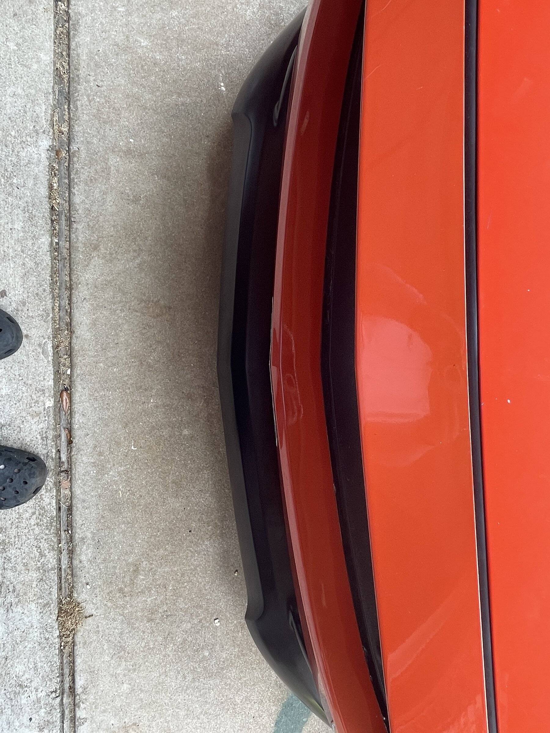

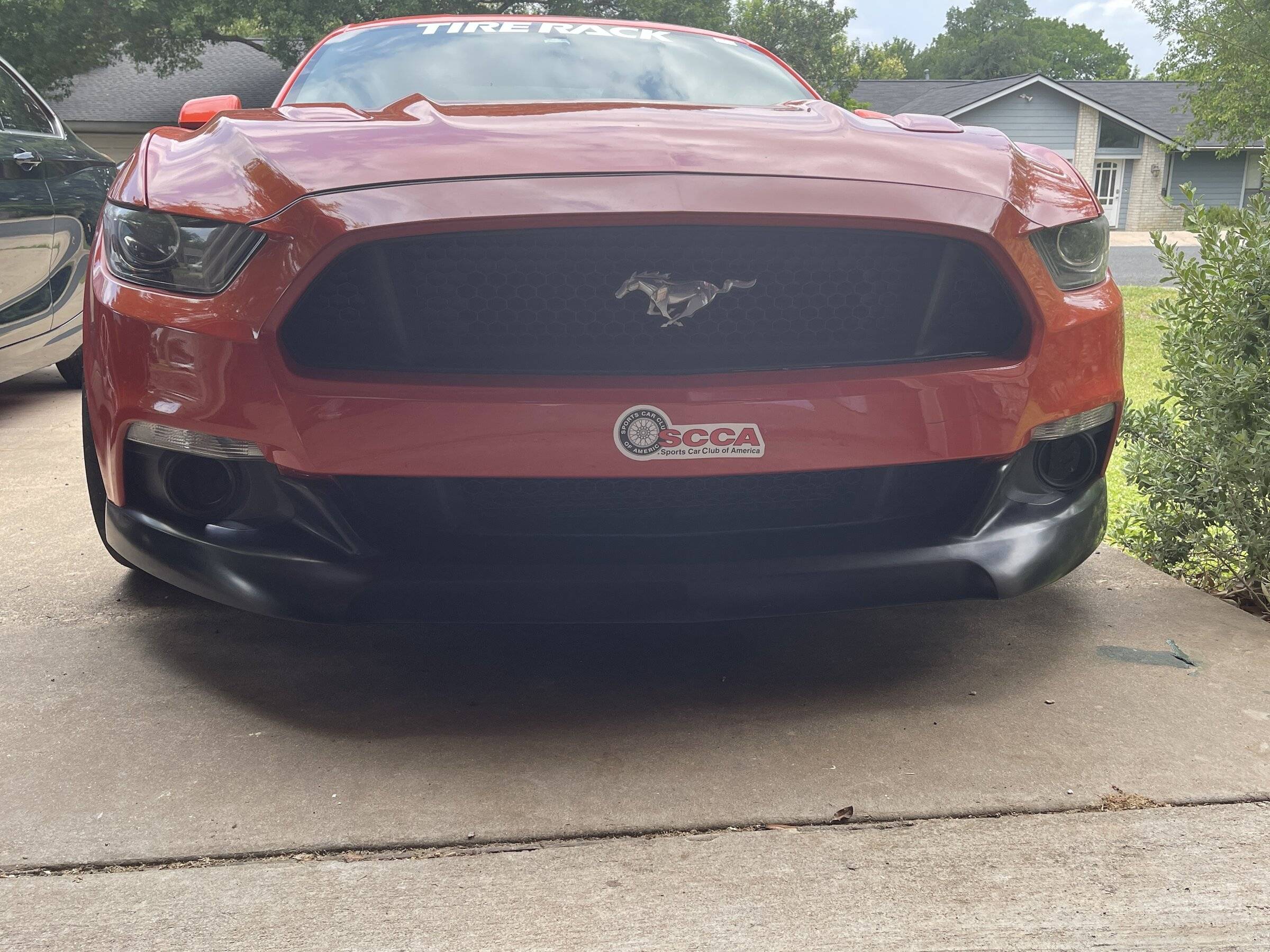

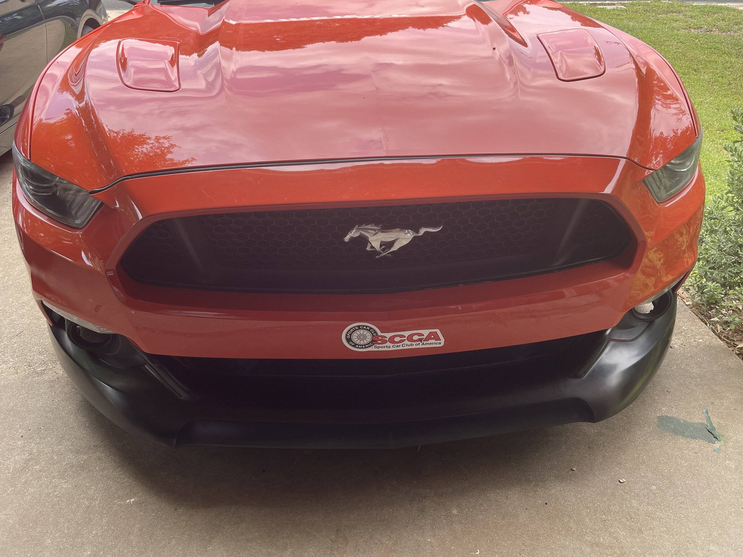

Lip spoiler came in, and it’s exactly what I hoped it would be, $120 amazon version of what American Muscle sells for $315. Has a nice flat undersurface with a lip to attach the chin(?) part of the spoiler to. Looking to see how quick release it can be made.
