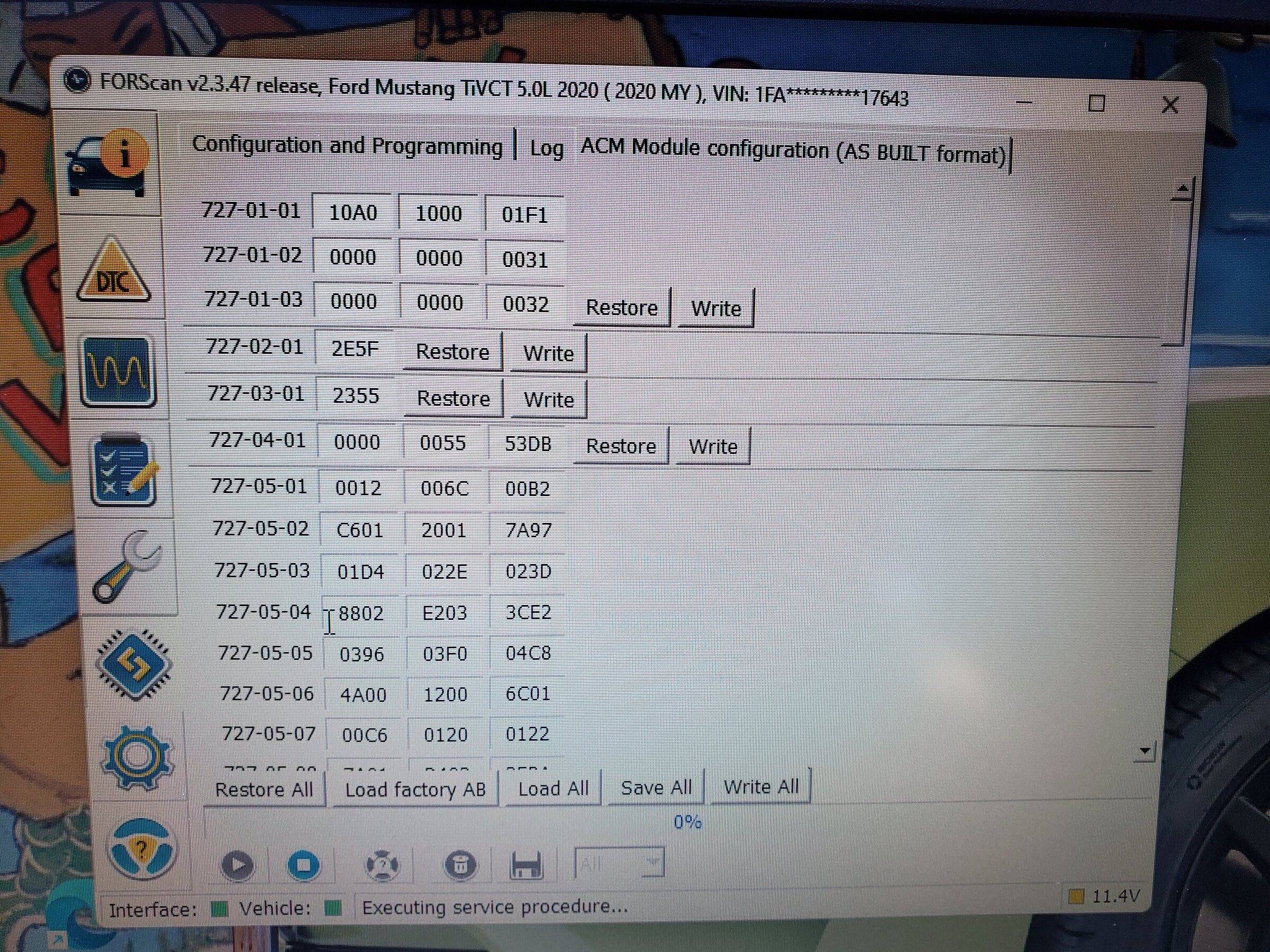

Just took a look at the ACM module configuration on my 2020 with B&O.
seems that the factory eq settings are flat. No need to flatten as with the Shaker.
