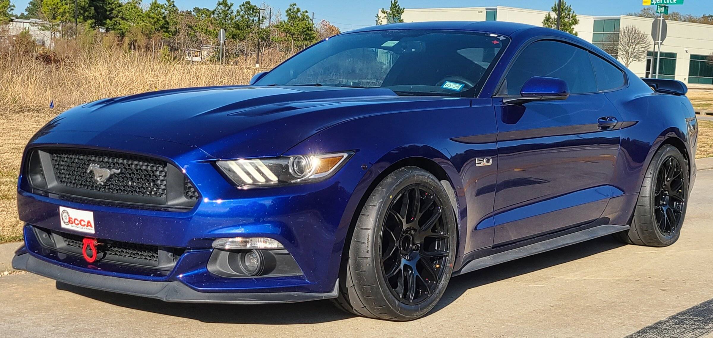

Welp...they fit and I didn't even have to adjust at the spindle like I thought.
18x11 +52 Flow One F2
315/30/18 Nankang CR-1/CR-S
Front alignment:
Camber: -3 2
Toe: 0
Rear alignment:
Camber: -1.9
Toe: 0.24 Toe IN (TOTAL)

How much spacer on the front?
strengthrehab
Feb 13, 2015
74
1,181
445
Houston
Ken
2016 DIB Base GT with PP
I have 30mm because I maximized camber at spindle, but 25mm is adequate.
Wholly dependent on front suspension though.

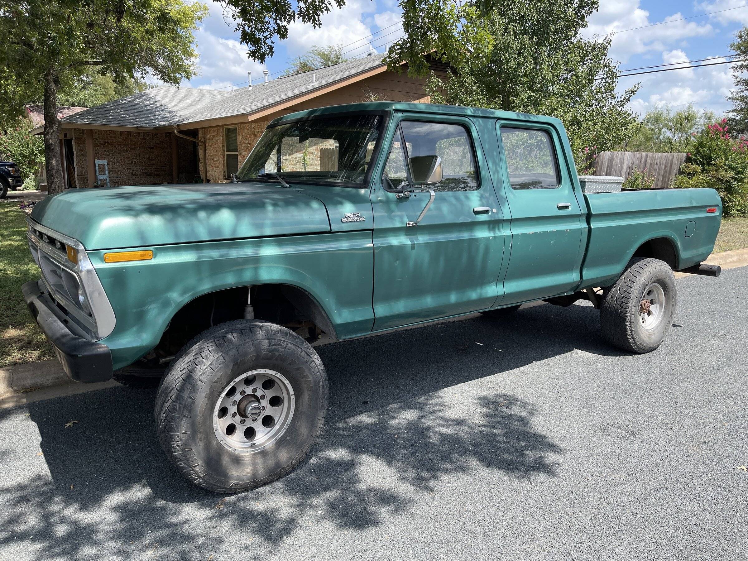

Reminds me how much I'm going to relearn how to drive. I registered for a SASCA event, in my Z4, even paid, then couldn't go due to some issues with my SUV I had to handle. My build is put off for a few months again, due to finishing a Solar powered Art studio and tool shed for my S/O, and moving in with her, just after she finishes a remodel that has her living with me, probably until march or April. She came with her own project, that I guess will be concurrent. Restoring this beast. a 77' that's been in the family since new.

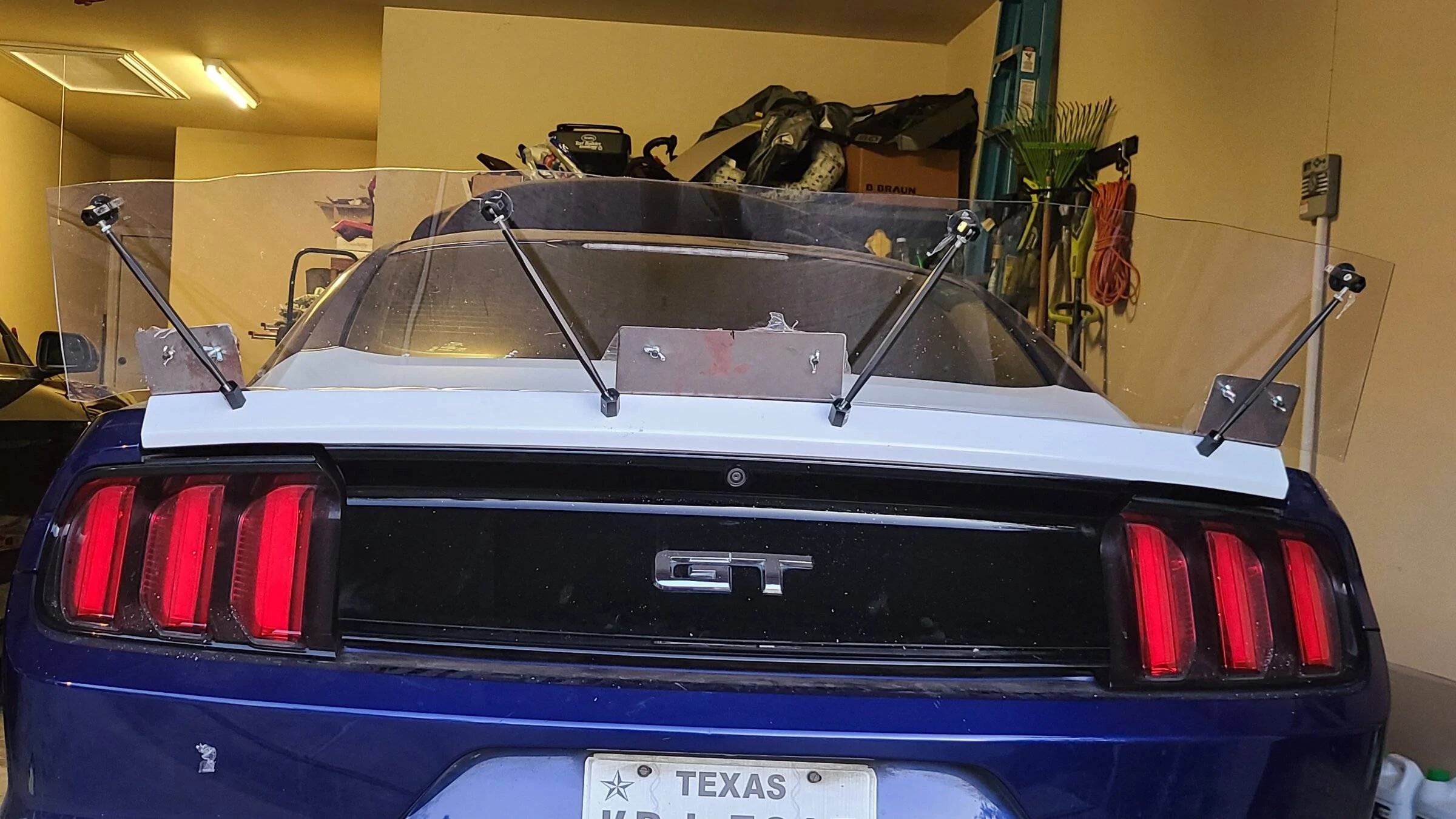

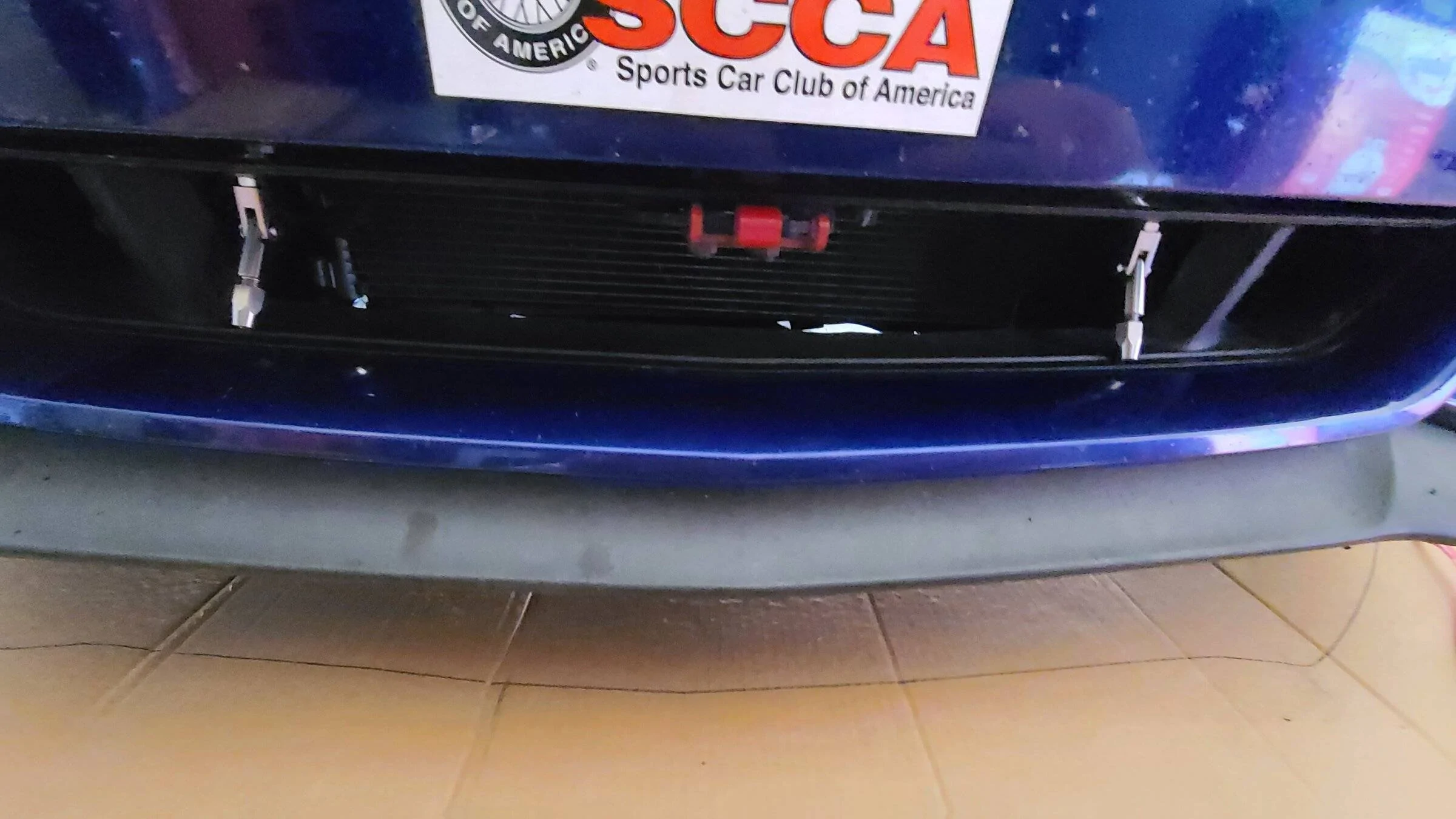

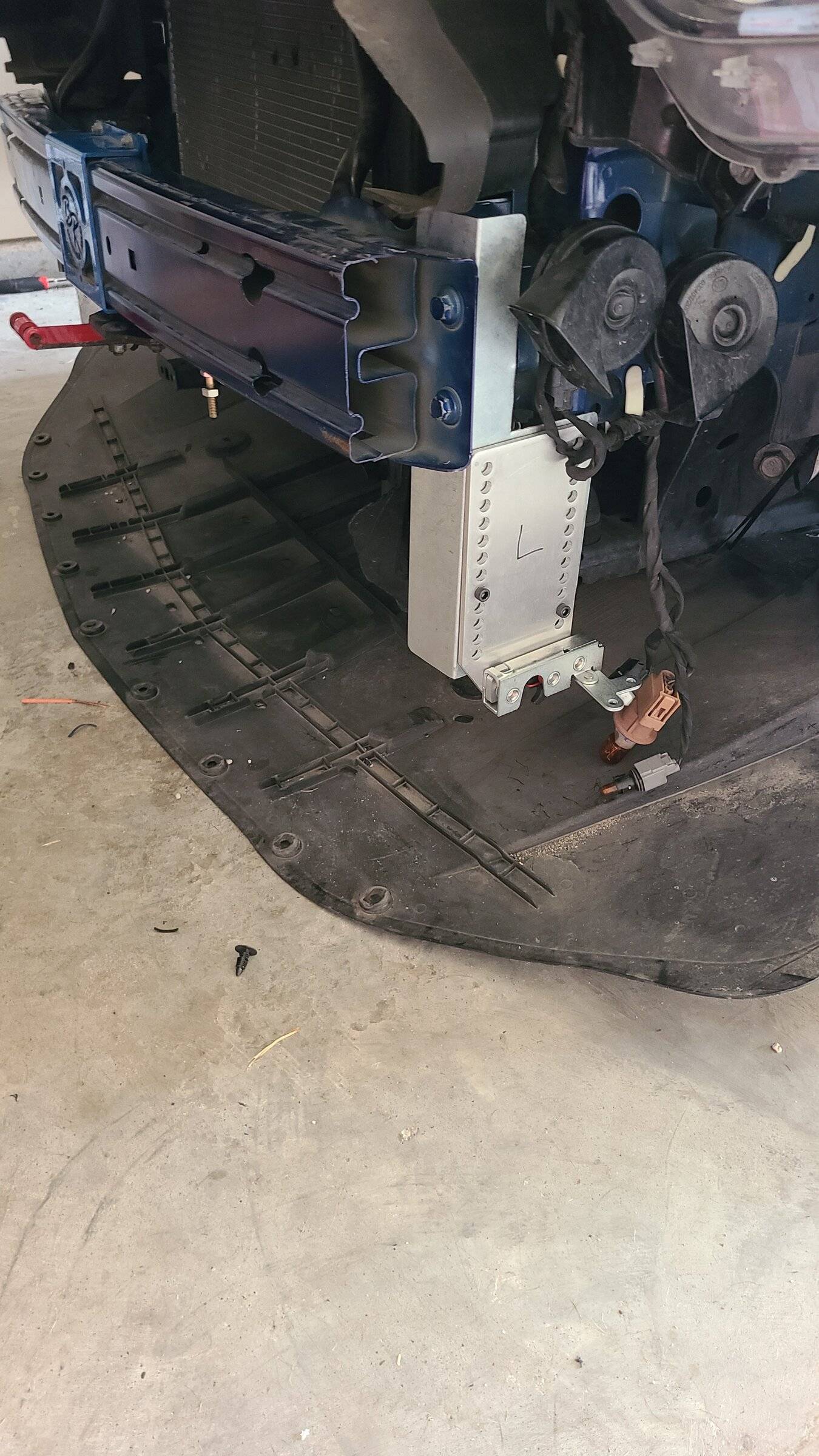

Did a little bit of work on the car over the past few days.
Spent more than my fair share of runs to Lowes, Home Depot and Harbor Freight, but it wasn't work so...
Anyway, aero project is coming along. A lot of trial and error and I'm sure version 2 of the setup will be an improvement, but it's progressing, nonetheless.
I've learned a lot about fab work and I still have a lot to learn.
Still hoping to have the aero stuff done by May event, but we'll see.
I plan to remove the honeycomb in the lower grill for things to look a little better and be a little easier. Still have to figure out where to route pull wire for the quick release. I may also need to figure out how to secure the rear of the splitter (may just wedge up to the k member and not need support)
Drilling the crash bar was a challenge, but patience won out.
I had lots of help from Brian McGreevy, Nightmaremoon. Thanks all.

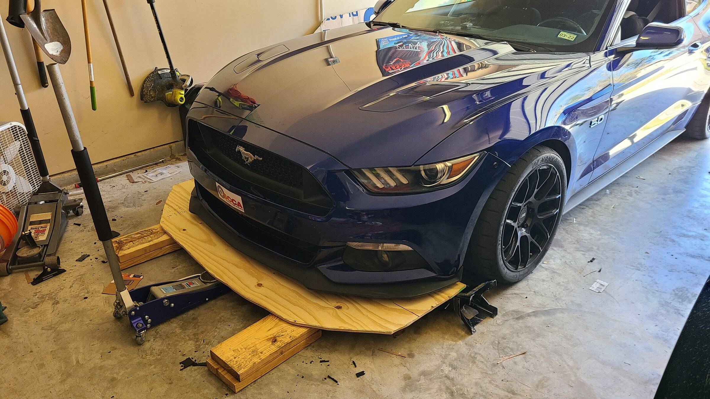

Did a little work over the past week or so. First time fabbing a bunch of thing, but seems to be working out.. Not quite finished, yet. Close, though.
