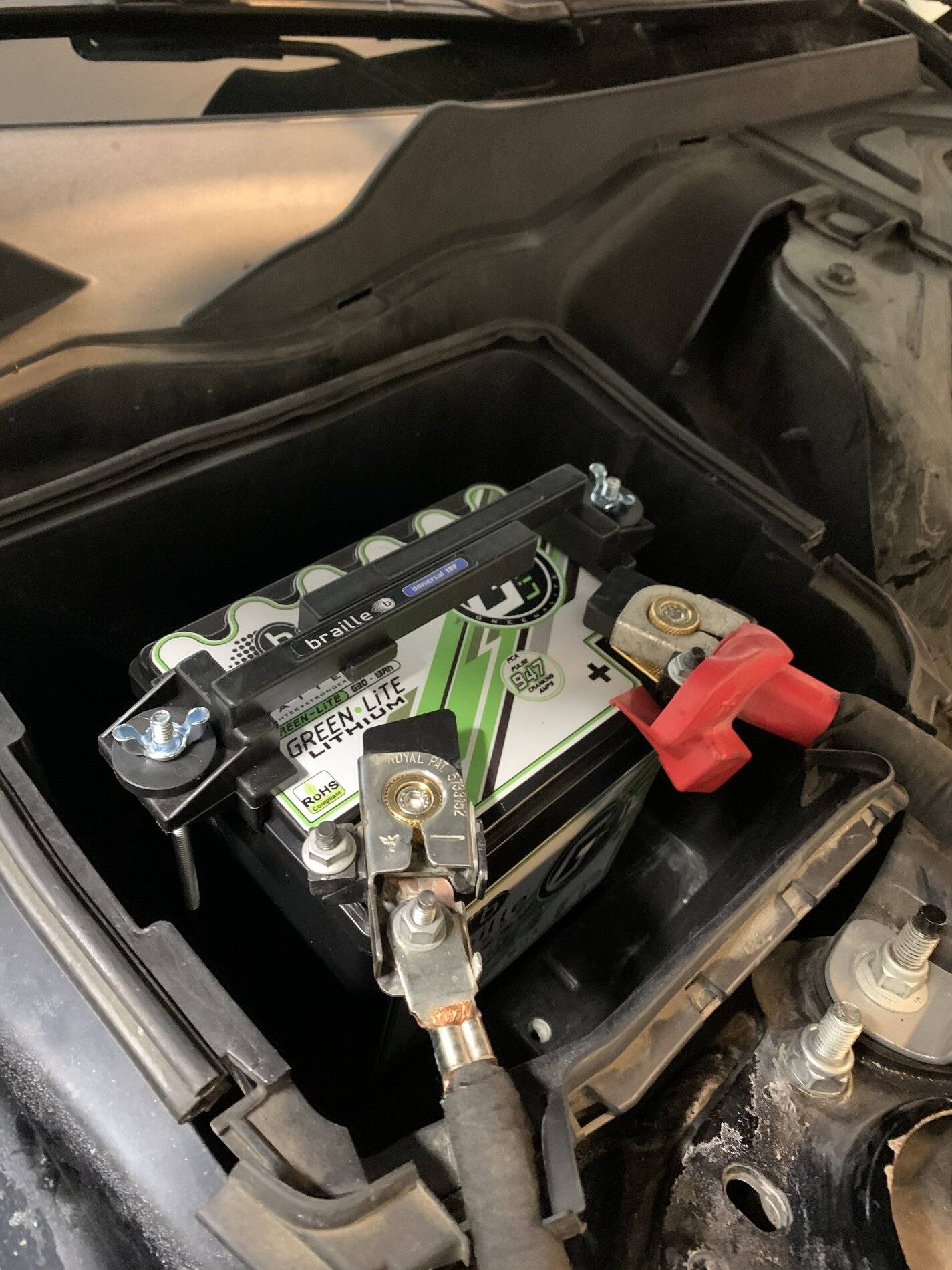

Weight ? I got OEM size AntiGravity (~8lb I think), problem is that those cars can't charge them properly (at least mine can't).
I didn’t weight the battery but it was -27 lbs compared to the led acid one. Internet says the G20 is ~6.3 lbs. we’ll see on the charging.

Thinking about getting that same battery. G30. Did you get the charger as well or don’t worry about that?
I got the charger because I wasn’t sure how reliable it would be. The car is a daily driver but you aren’t supposed to jump start these batteries so the charger was a small safety net. I also got their J hook bracket hold down (pictured) which is working out just fine.
So far its been solid, no issues with the Ford charging system so far and the car cranks over very quickly each time I start it. I was waiting to get an autocross or two at least before reporting back here but initial impressions are all positive.
guessing the charger may stay in the box for quite a while. They recommend it for cars that sit idle for long periods. For a daily I guess you shouldn’t need it.
battery box required some dremmel cutting to seat this slightly taller than stock battery but obviously it worked out. I can show you what I cut out if you’re curious.
Awesome, thanks for response. Can you still use the stock battery after your mods to the battery box? I use the lightweight for track and the stock battery for weekend play.
yeah you certainly could swap. The mods I made wouldn’t be a problem for that. The factory hold-down wedge thing would still work and I think it would still probably support the weight of a stock battery I guess.
If you want to do that, put an Anderson plug on both batteries to make the swap easier.
