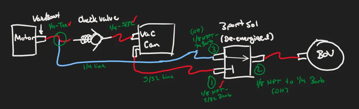

Alternate solution, make a system that stores vacuum and uses actually throttle pedal position to open the BOV based on lift rate or pedal position. So heres what Im working on to fix things.
I have a harness to plug between the throttle pedal connectors to get the signal, an arduino and relay, and some rusty programming skills I'll just burden AI with coding.

Awesome! Im glad Im not the only one thats noticed this being a non-trivial issue.
Edit: I watched the vid and that got me thinking how to I make sure my setup isnt an on off switch with dumping. Well, I think Ive solved that before its come up.
My programming will do a few things.
  1. Analog input to adjust lift rate to open valve. So you have to be lifting fast before it will dump.
  2. Analog input to adjust min throttle.
  3. Dump will just be a pulse of some short duration.
    1. This is needed to make sure Vac Can will recharge
    2. Goes back to engine control until the system again sees high enough throttle with a lift.
  4. Otherwise the slower throttle inputs will still keep the nice throttle control at least my car has. And fast on throttle will still immediately close the BOV.
I should get off my butt and start pulling the bumper now to get to the bits..
