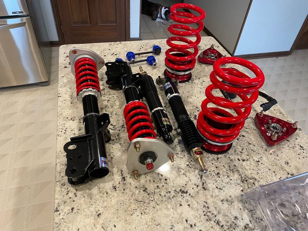

Decided to make the move to CAM from F-Street. Nothing too drastice since I still plan to daily drive the car. I just picked up the Pedders Extreme Coilovers and will be looking to get a new set of wheels in the offseason. This is my first time with coilovers and will be using much of next season as a test session.
Does anybody already have these on their CAM cars? If so, any set up suggestions?
not exactly known for being good. Tolerable? Need to confirm you can actually get at the camber nuts. AFAIK you had to take the entire shock out to set camber.
I ordered the camber plates to fix that issue. I saw people mentioned that. All other reviews seemed pretty good though.
Not entirely true. I ran them on my car for 3 years. They were good enough to win the SW divisional a while ago. I also placed well locally (Houston Region which is pretty competitive).
I probably have the most extensive testing with these coilovers so I can give you some information for sure. Drop me a PM.
You can open up your shock tower holes to get to the camber adjustment bolts.

Rear springs are way too soft to be competitive. They are reviewed well by people who don't know much better. They ride and handle decent at 8/10ths or less, as they come.
Take Ken's advice on tuning and setup with them. They can be made to work well for a CAM setup but not with the spring setup they come with. They also just won't produce the peak grip nor the grip consistency of a nicer setup, but for the money, not bad.
