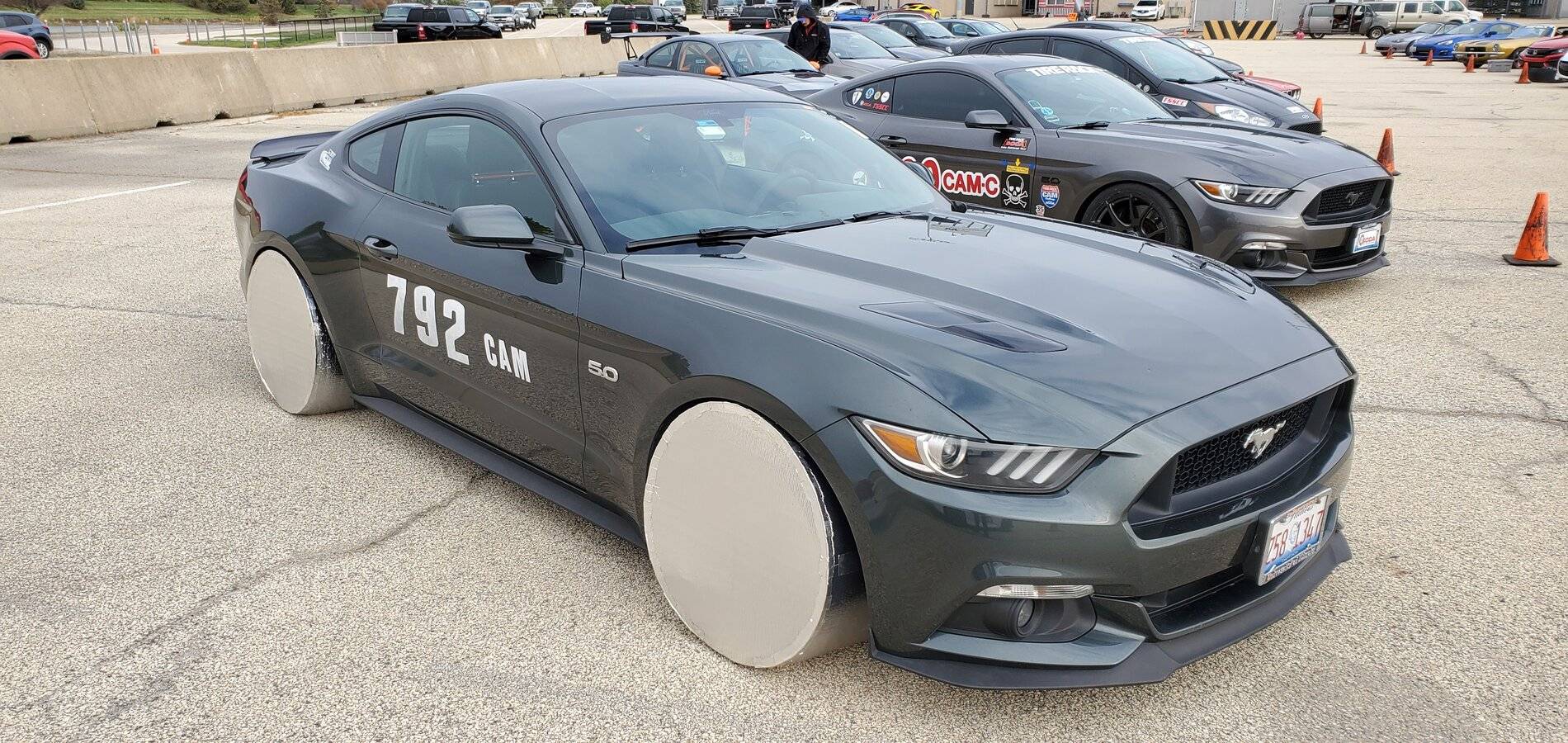

You have to use blankets when it's this cold (below 60 F), or have a co-driver. It's really hard to make any of the 200tw tires work in the 50s unless you get a lot of runs, or you're running a bit smaller tire. I could get heat in my 275/35R19 RE71Rs but it's very challenging with the 305s. I hand made some tire covers last year. They worked well but I need to build in some anchors so they don't go flying when it is gusty. I lost one on this 50 deg, 20-30 mph sustained wind day.

I had actually bought a couple of rolls of radiant barrier last weekend, just didn't have time before this event to actually make the blankets.

why not buy tire warmers? Most paddocks have power. Maybe split a kit into 2 and just warm the fronts?

To not lose blankets I'm sticking shoes between them and fender - just jam them in - works well, problem is I typically have only two shoes available :)

Speaking of blankets - I use RXC ones that Steve Fehr makes - they're really nice - probably wouldn't paid for them and make my own but it was a gift.
