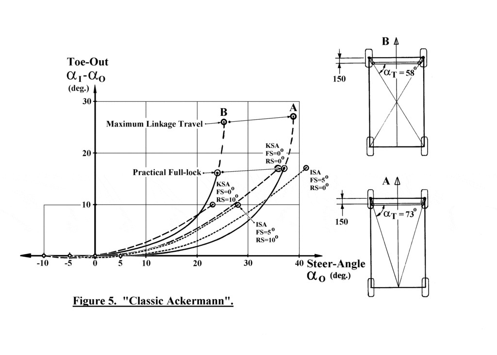

Toe out on the front causes under-rotation as well (after initial turnin), which people tend to forget. The classic advice is front toe out to increase turn in, but its the opposite after the initial turnin. I guess it might vary by the corner radius, that would be some fun math to work out.
That'd be your Ackermann geometry getting involved. Toe out is neither constant nor necessarily linear with how far the front tires are steered.
Norm
Norm
Yep. The effect of toe out on balance with significant wheel angle is dependent on the Ackerman amount built into the steering system.
