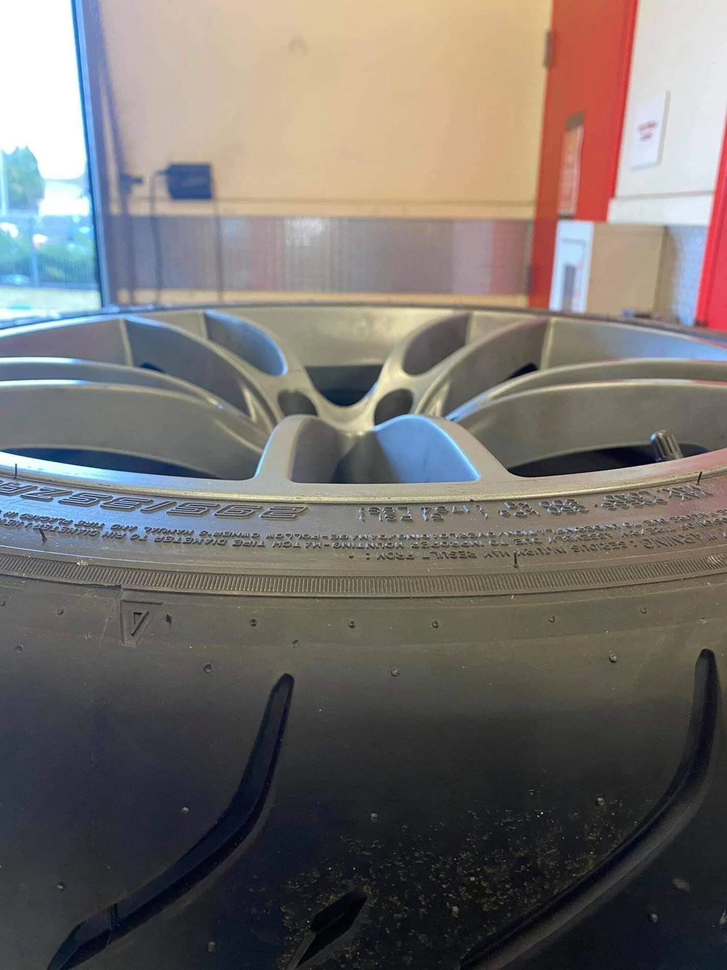

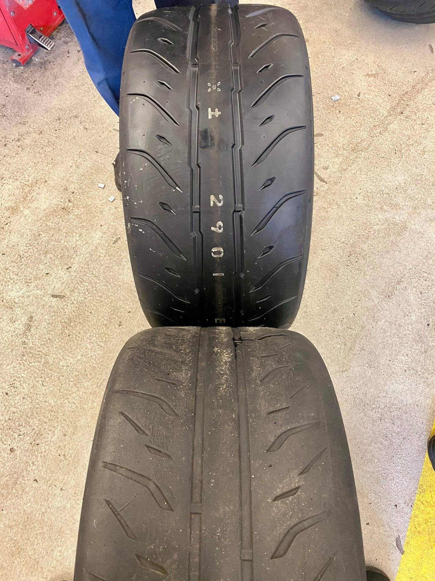

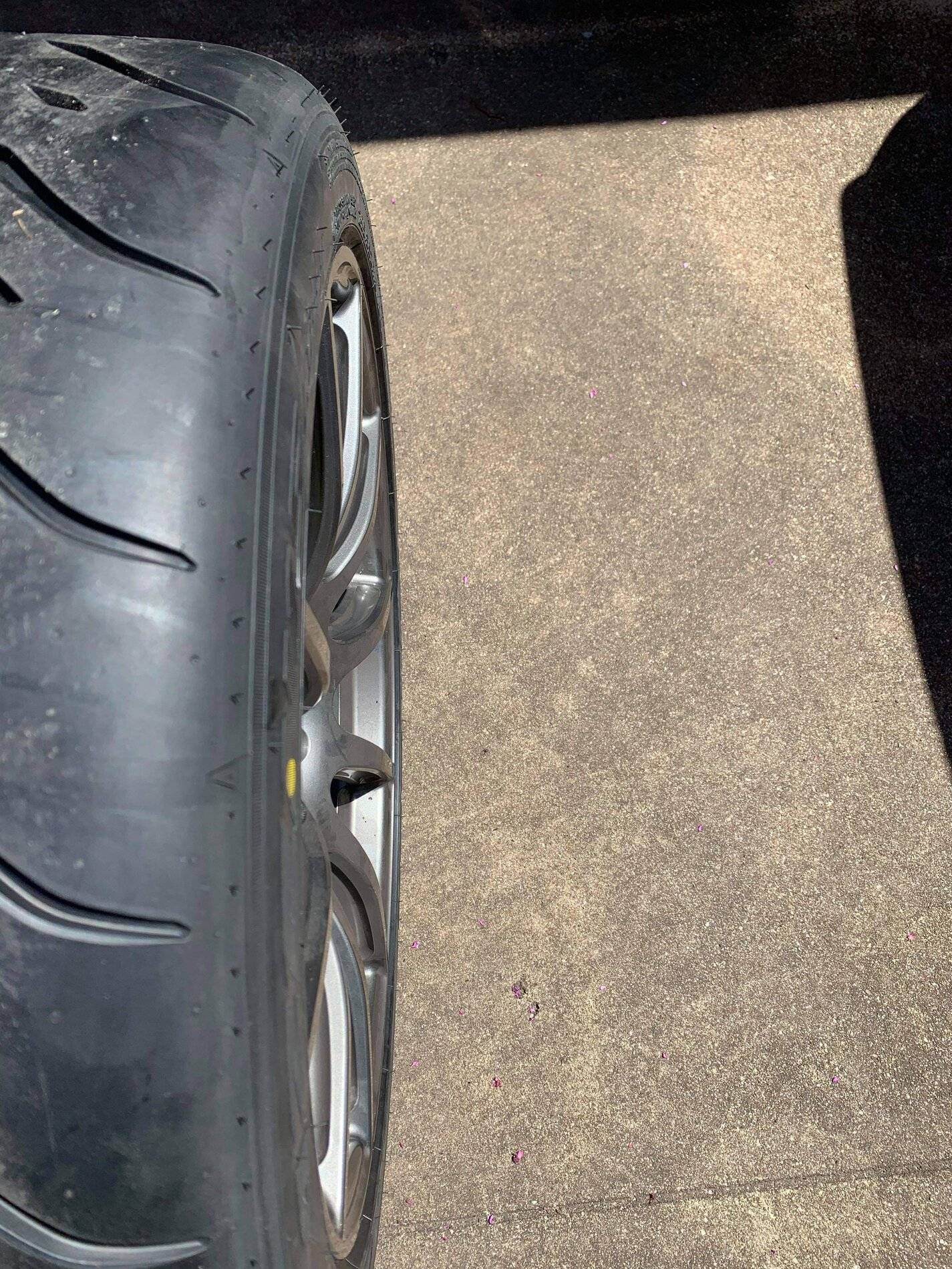

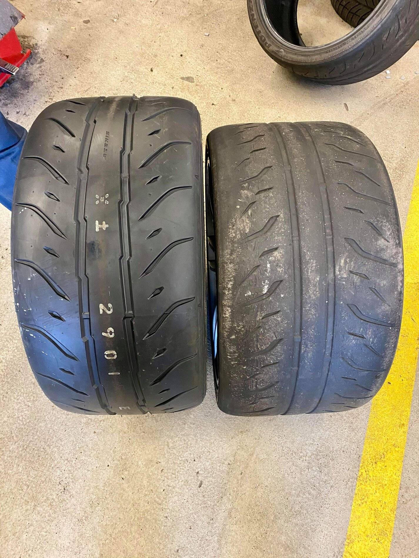

Happy to report that 295/35R19 RT660 are a basically perfect fit on 19x11 wheels. See attached pics of mine and @NightmareMoon 's. Great fit, and a bit of a gearing advantage for us 15-17 cars with 3.73s. 27.2" vs 26.3" for 305/30R19.
